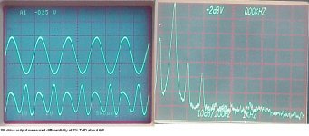

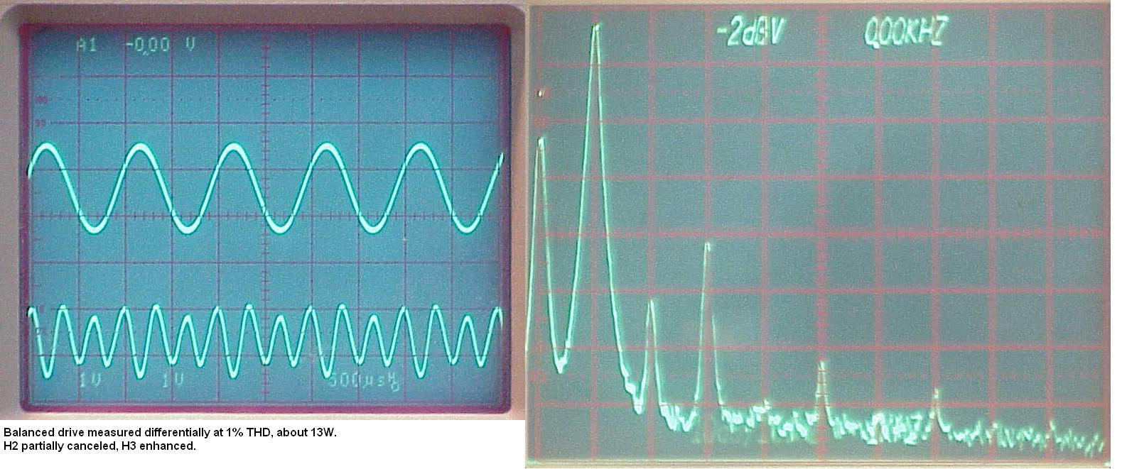

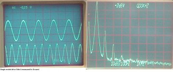

It bothered me the way Bridge mode was accomplished in the ACA kits. No one could answer my questions so I made my own measurements. Below are the 1KHz THD plots for bridge mode output with single ended and balanced drive. Also attached are the analyzer outputs taken at 1% THD in each mode.

According to your graph which is attached, the amount of noise in Balanced mode 10 Watts is the same noise level of the Bridged mode at 2 Watts.
Using my Hafler 915 preamp with RCA's had less noise than the EL34 Push-Pull 35 watts or Single Ended at 15 watts the ACA's replaced. Yet, with no input signal, the ACA's were not exactly pitch black.

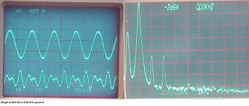

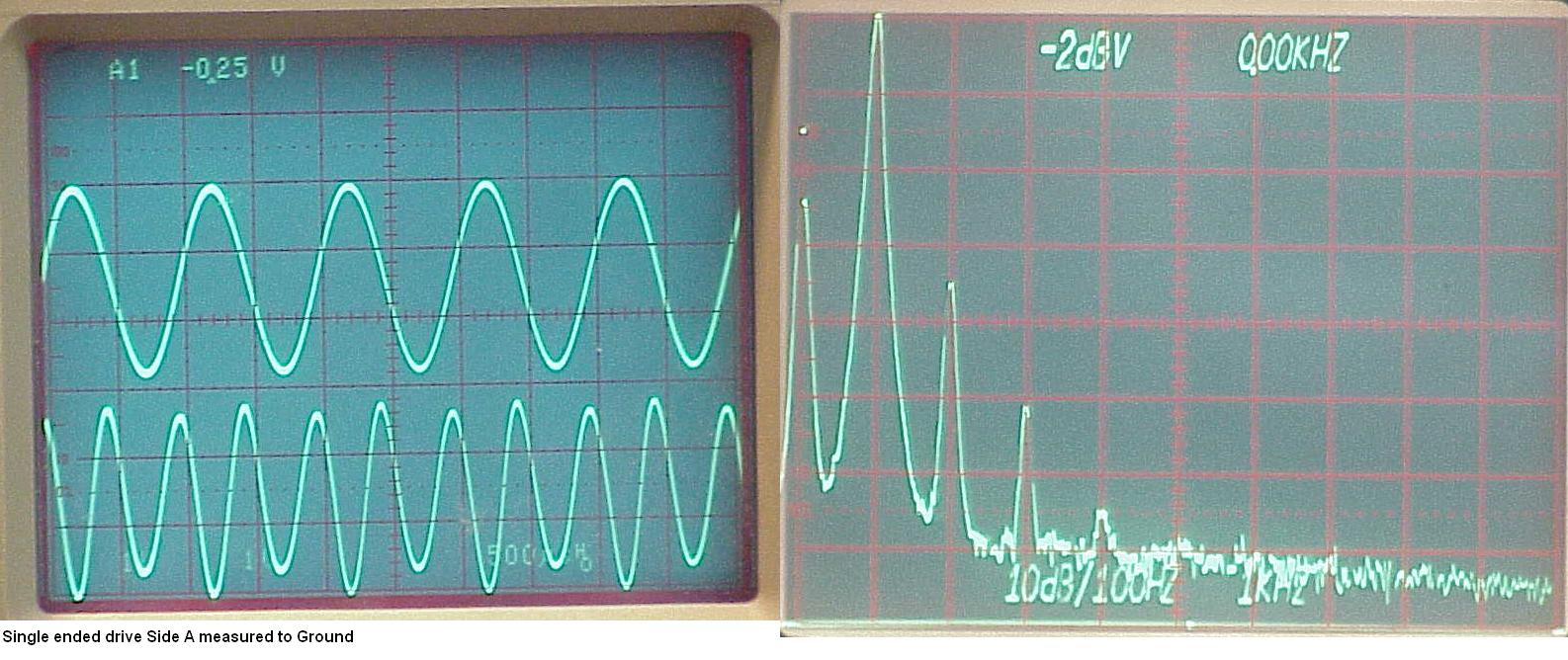

Yes, THD is higher in the SE drive mode, but many people like the 2nd harmonic. Below are analyzer output of each side. Try it each way and tell us which way you like.

The analyzer is an Audio Precision System 1. That's what made the graph in post 7038. In post 7040 the left screen of each attachment is a Tektronix 2465B monitoring the analog outputs of the AP S1. The right screen is a Tektronix 7L5 plugin (monitoring the top waveform seen on the 2465B) in a Tektronix 7104 mainframe. The on screen readout on the 7104 is generated within the 7104 by a completely bizarre chip set that was designed at Tektronix around 1970. If you can find an old 7000 series mainframe (except 7854) with readout, it will have that chipset.

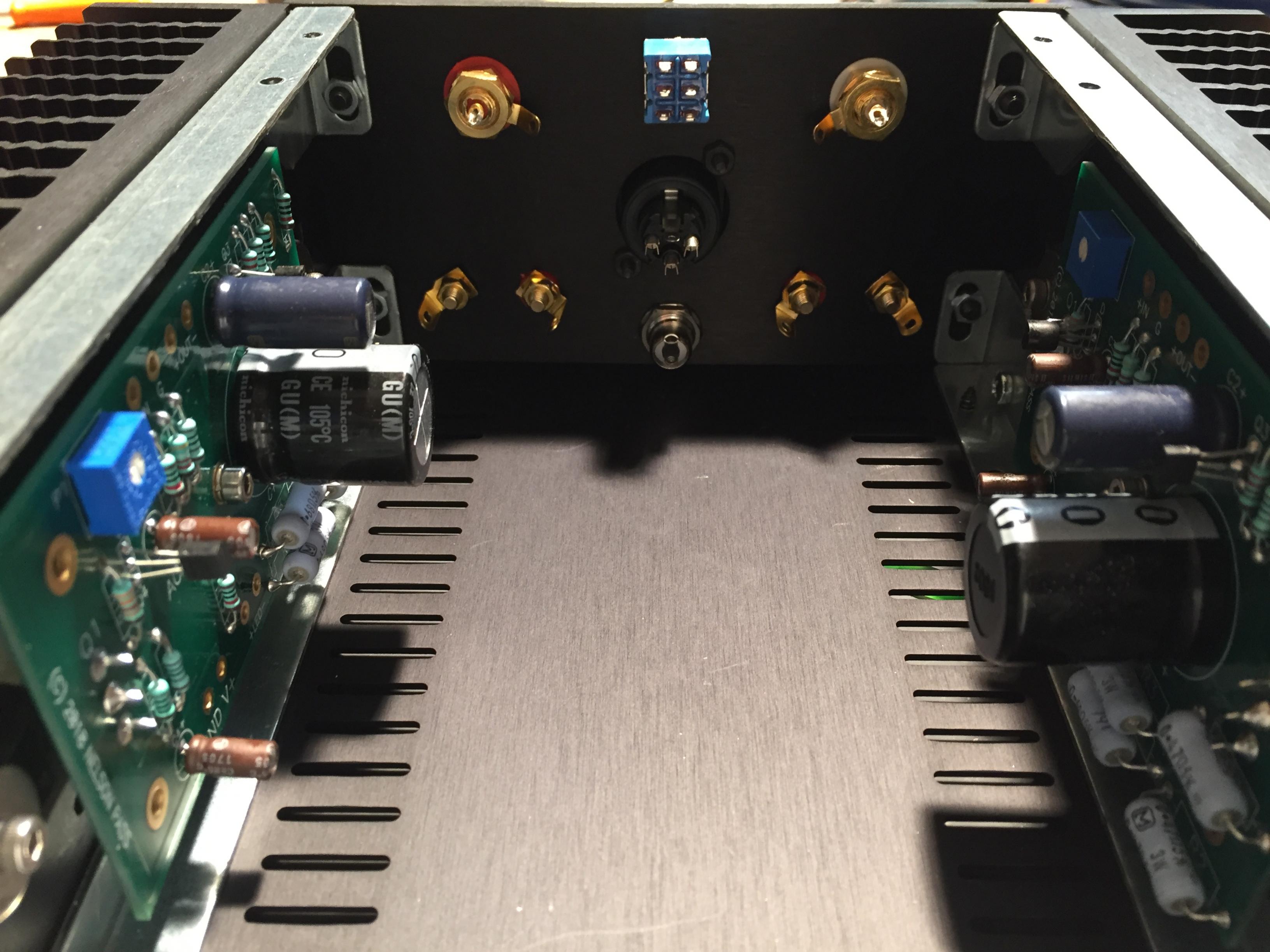

Hello DIYAudio community,
I have just completed my ACA build and would like to thank 6L6 for creating a superb guide, each time I was a little unsure of how to proceed; I reread the guide and all the info required was there, so I would like to add my name to the list of first time successes and say that I found the whole process very enjoyable, apart from switch on which was nerve wracking, does this go away with experience or is it the same with every build?
I am a novice with little understanding of exactly how it all works so please be gentle if this is a stupid question. I am using RCA interconnects so do not need the XLR but I am curious as to how it works, my understanding is that the signal is flipped over by some internal circuitry as it passes from one device to the next, so having built my ACA I was wondering which part or parts is doing the signal switch over?
