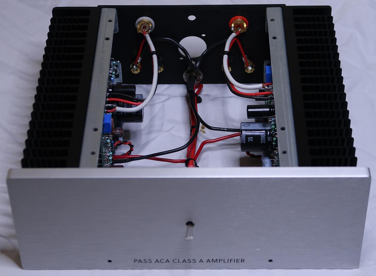

Herein you will find some pics of my ACA set as parallel-mono:

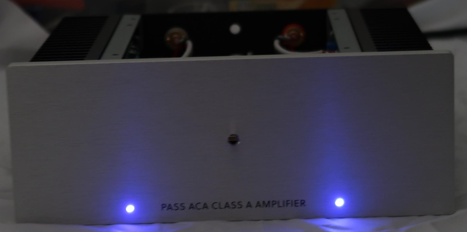

I chose the blue led option, It's in keeping with PL after all :)
But I detest glarey strong lights, so I played with R13 and ended up with 56k. (24v supply)
Bright enough to be seen in a well lit room, yet in a dark room barely annoying if viewing straight into the leds.
Yes I'll post pics when I can so you can see the led results.

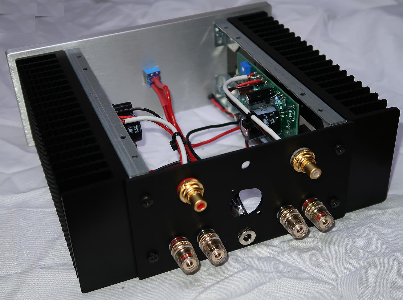

Some pics as promised.
I need to make a blanking plug for the xlr and rear switch holes.

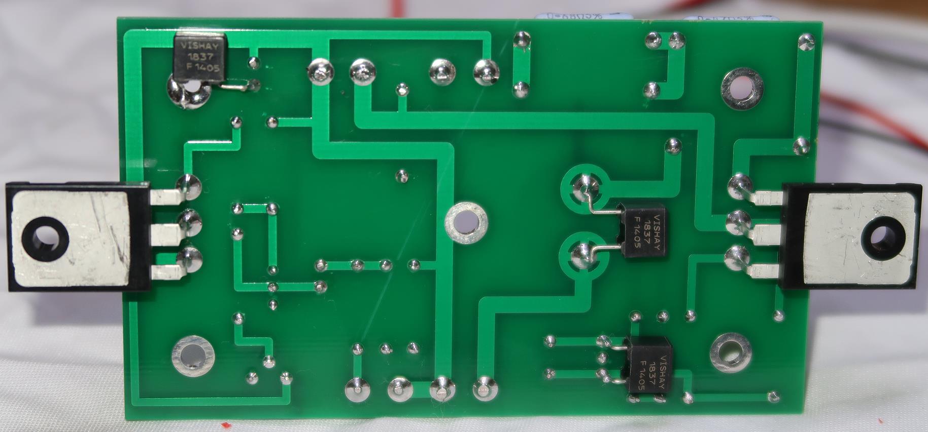

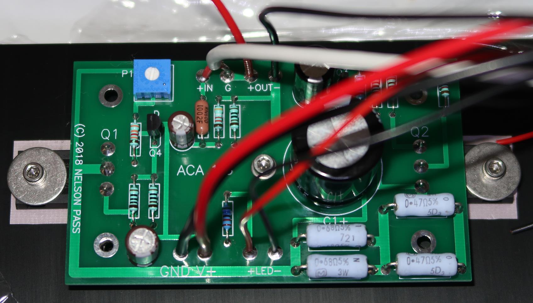

Things I changed;
Vishay 0.01uf caps across C1, C2, C4.
Vishay Dale rn60 resistor for R11 (Because I had it on hand, would've changed some others but didn't have any handy).
Used the supplied 'rear' toggle switch for the main power switch on the front (Homage to my x150.5).
4mm cable for most power wiring and 5mm from power socket to power switch.
Silver plated teflon insulated wire for speaker connection.
Shielded cable for input.
Longer board stand off to space the board off the heatsink a touch more, also needed that extra bit for the Vishays.
Mounted the red posts on the outside (my OCD :) ) which meant a minor change to the rear panel wiring.
I pre wired the boards so that I could clean the whole lot in one go before mounting them to the heatsinks.
I also biased it to 10v to drop heat output a little.
I'm not concerned about the side effects of doing this.

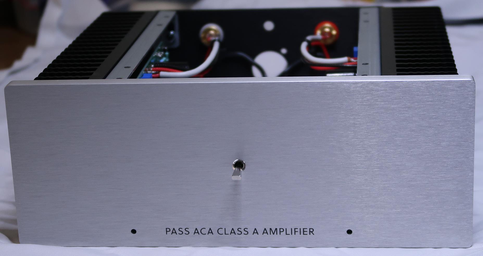

To give an idea of what its like with the 56k LED resistors.
Pic 3 is a well lit room with power off.
Pic 4 is a well lit room with power on.
Pic 5 is a very dark room with power on.
One side effect of reducing the midpoint to 10 v (aside from asymmetrical clipping) is actually increased heat dissipation. This is due to the change in voltage across R7 (10k) changing slightly the operating point of bias regulator Q3.
It will only be by a watt or two but its a change in the wrong direction. Increasing the midpoint voltage will reduce the overall dissipation very slightly but its only a couple of percentage points.
Stick to the recommended operating point would be my advice.
DOH :D
Ah well, shows what I dont know ;)
Time to open and readjust to 12v.
At least it's such an easy simple thing to do on these :)
Edit.
So in that case, I should actually be aiming for half power supply, correct ??
My supply loaded with the amp is 23.9v, half would be 11.95v
hhmm nit picking to the extreme ?
