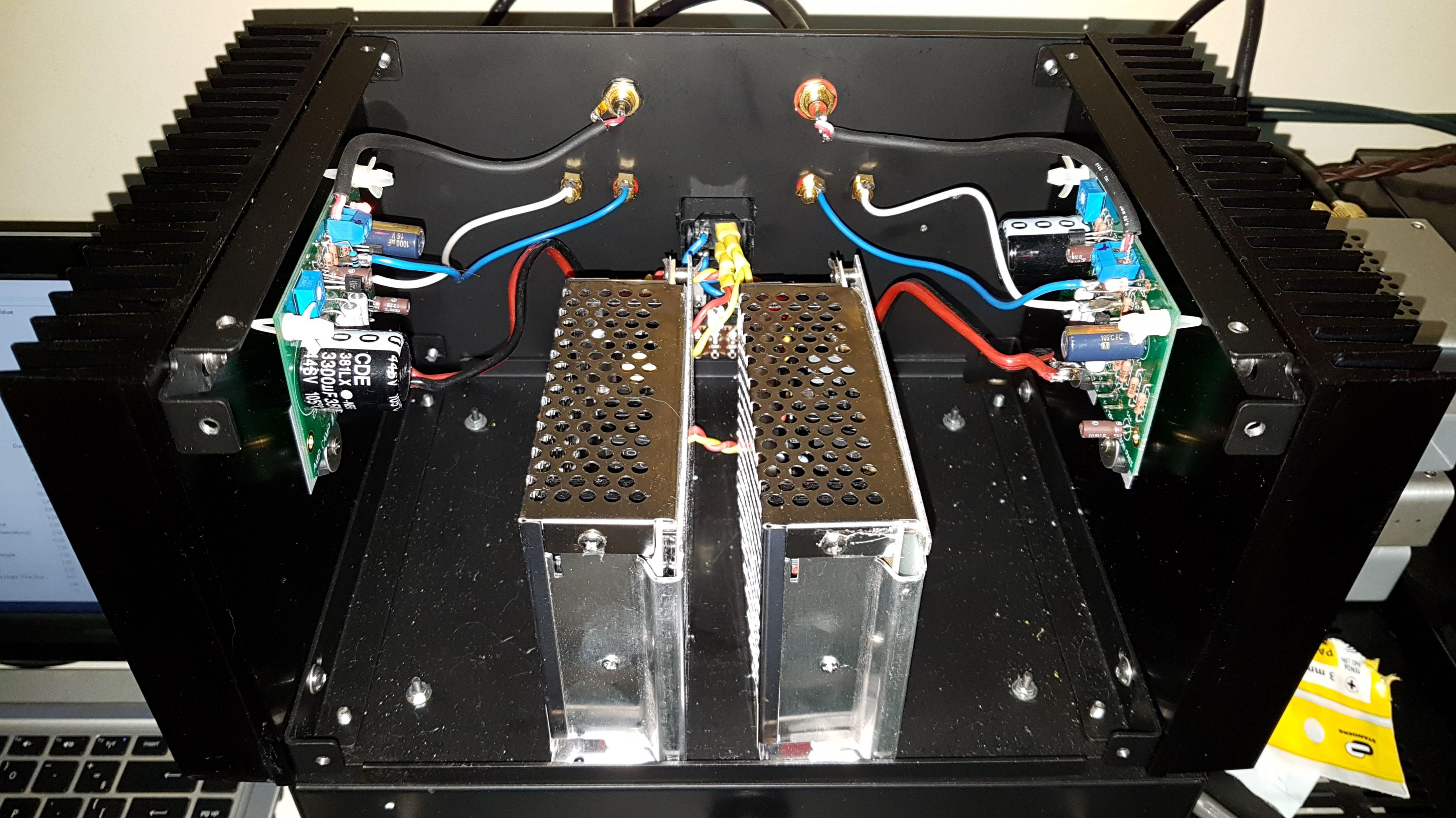

This works fine for me. My intention was to use a linear PSU, but the transformer I ordered ended up being to big, so I used this two 24V 5A SMPS, each powering one channel.
Thought about putting the preamp inside too. It would share the same PSU as I am using the B1, but with all the input RCAs it would need a larger chassis, so I decided against it.

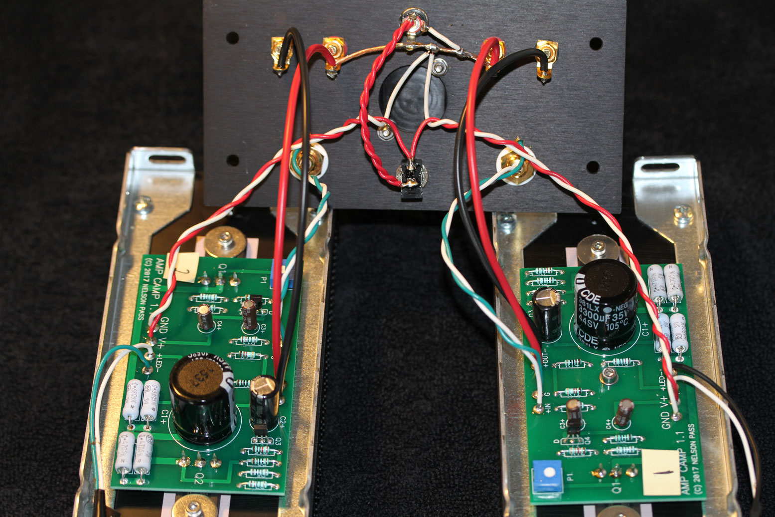

The ACA amps - running XLR connected, bridged monoblocks - have now been my main amps for the past few weeks. My tube obsessed friend came over and we played a few cuts. His impressions: it was one of the most neutral SS amps he's ever heard. It doesn't "sound" like solid-state, nor does it sound like tubes. He noted some deficiencies in bass control, which isn't surprising given the bridged connection with 86dB Wharfedale speakers and their 6-ohm impedance. He also like the depth of the soundstage and the detail. He's definitely what you call a subjectivist listener and a tube roller, so take his opinion as you will.
The 90s-era Classe Five preamplifier does a good job driving them - very happy there.
Got to head off and snooze a bit but I just thought I'd put in a thank you to M'sieur Pass, the diyA crew, 6L6 and all the forum members who've chipped in with good advice.

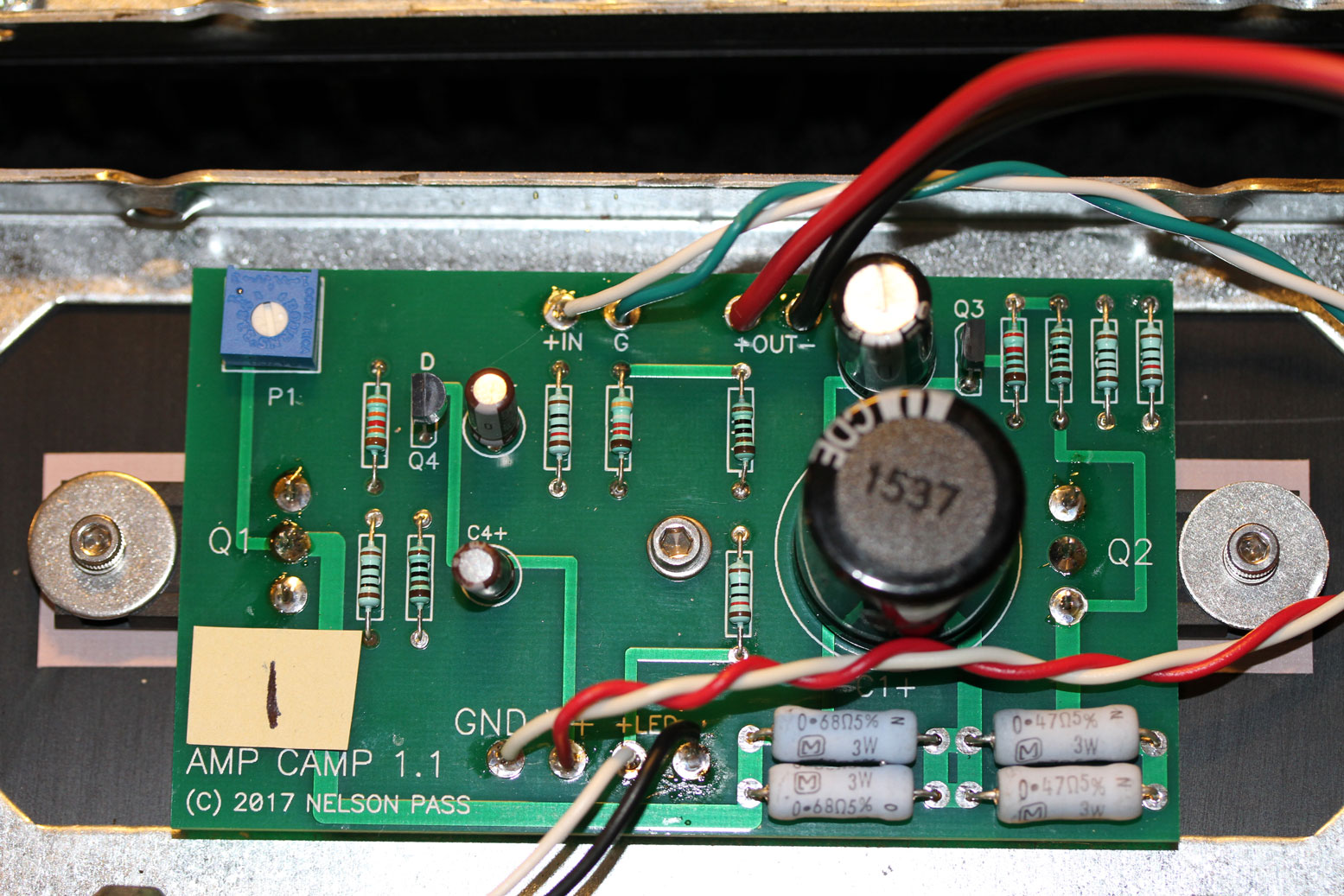

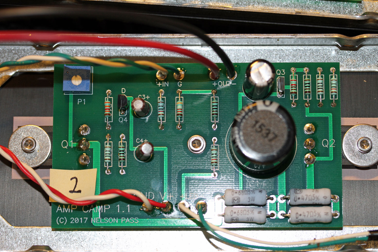

Got the first amp built and no smoke. The second will follow. Should be a bit quicker with a 1:1 scale model to work off.
Have just had a quick listen as a single unit, stereo amp and it doesn't disappoint. I should sleep well with those sweet tunes in my head to serenade me to sleep.
Something tells me that this won't be the last build I do but I won't be in a rush for the next round. Time to savour the ACA for a while I'd think..
