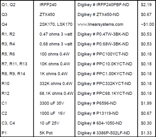

I used the build list below.
If you going to 24V, R12 is changed to 39.2k. I used .5 watt.
Bias is set to 12.5V instead of 10.
As said before R 15 (not on list) is 2.2k. Again I used .5 watt.
The use of .5 watts is because I am to lazy to keep .25 and .5 in my stock box so I use .5 for everything.

When you get the PCB's from the DIY store are there any documentation in he package with component values, the modifications that are possible etc?
Or do you have to search this forum?
The official documentation is back from 2012 and I assume there has been new revisions of the PCB and the modifications was not describes at that time I assume.
Is there one place to get the latest full documentation incl all mods.?
I bought bare PCBs and I don't think there was any documentation, it should be easy to get what you need in the first posts of Nelsons thread though.
