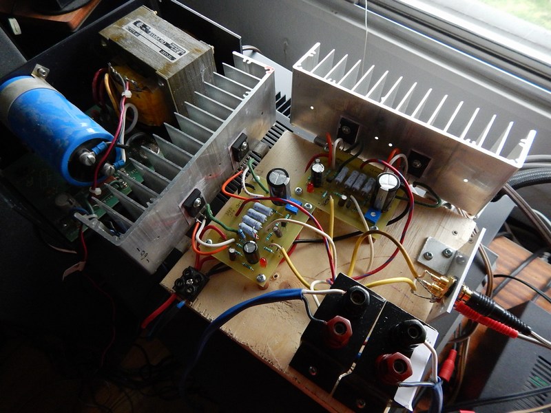

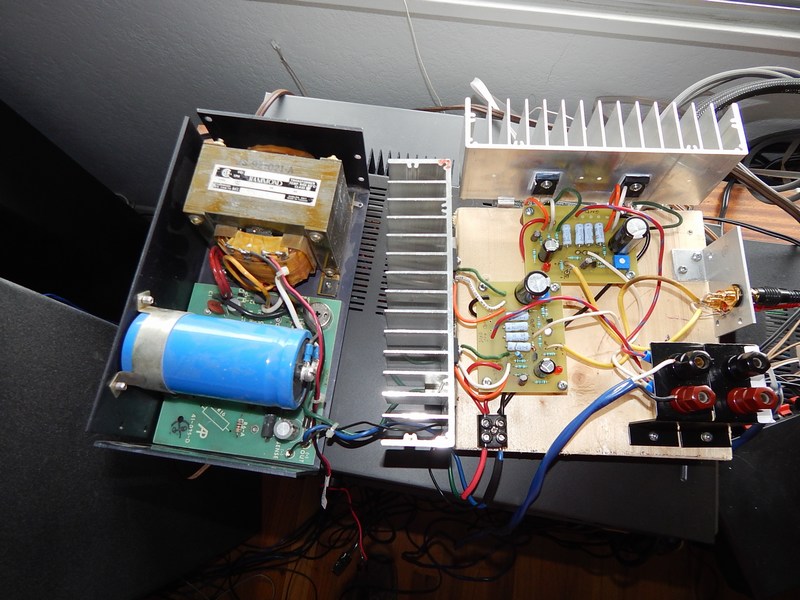

I built the 2nd channel ACA amp and I'm using the BOSOZ 'line stage' as preamp- it has a 10k pot on the output side.
There's plenty of volume with 95dB speakers and both (stereo) channels - vs the one amp (mono) experiment before.
I'm going to try a few more combinations with volume control pots and different speakers, but what I have now seems usable, as far as volume level goes. So, I'm going to start looking in my shop for some case ideas.
I've gotten advice to use a low resistance pot if I want a 'passive' volume control between the CDP and the ACA. Does anybody make ganged(stereo) pots with less than 10k resistance? And, is that what I need?
It's still at the 'breadboard' stage, but here are a couple of pics of my ACA pair.
Many thanks to Rudi_Ratlos who had posted the Gerber files for the PCBs. Using Gerbv software, I made the toner transfer 'masters and the pcbs.
I added a couple of pads for the R15 mod- just in case I needed them.
Power supply is a regulated 24v 5A Hammond supply.
I removed the R15 'mod' - heatsinks are cool (35-40C) so they are definitely large enough @ 60mm x 180mm
Next: case, power switch and fuse, etc....
