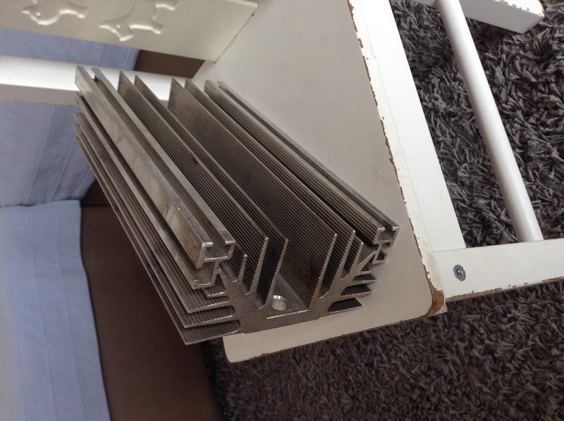

I am having some taughts (doubts) about heatsink.
I have a piece of alu, cca 25 cm long, 12.5 cm width with just over 6 cm thickness ( that would be 10 x5 x 2.3 inches), weight is cca 2 kg.
If this would be ok for two channels (cut in half)?
I have some other solutions for aca but this heatsink is alone for long time now
Thanks!
P.s. Why is photo out of proportions when enlarged?
