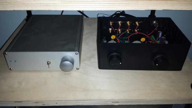

DIY friends. Finally had an opportunity to take and post some photos of my wayward 1st attempts at building amps.
So, first, 4 photos of the good one.
Then, 4 photos of the bad one.
The ugly? Well, one look at my soldering...
Thanks for any and all sleuthing to help this rookie DIYer...
I must confess, about ready to throw in the towel :eek:
good one is good by sheer luck
bad one is bad most likely because of bad soldering , all over the place
remove pcb from htsnk , inspect and redo ............ everything
if your solder iron is too weak , find more powerful one

Seems like you could reheat each joint a bit hotter, maybe you were afraid to overheat stuff. And if the solder doesn't flow then get some flux and paint it on the joint and reheat. Make sure there are no shorts, I see some wire strands close to each other..
My initial trouble shooting routine:
- make sure resistors are correct values- esp. the ones with or without K in the value.
-Make sure caps are inserted with the plus lead in the correct hole
-Make sure the tiny transistors are in the right places.
-reheat each joint until it flows better, sometime feeding in a bit more solder to add flux.
-check no "whiskers " of solder or strands of wire are shorting something out..

Thanks Variac:
Will re-do everything and hopefully my skills are good enough to now to make this thing sing!

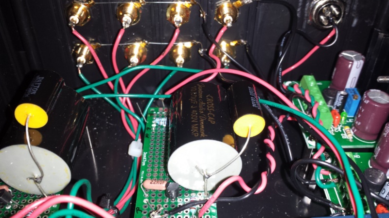

How much gain in the BA3 front-end? I don't need much, maybe 4x-to 8x. My dac outputs 2.1vrms, and I believe the ACA needs 3-4vrms to be able to drive to clipping.
Build a boz-j. Simple, has gain and sounds way better than its parts count would suggest.
Currently driving an ACA.
This is my second boz-j. Sounds a little better than my first, probably because I left the power supply outside the main box. This one will be for sale. I don't need two. ;)
