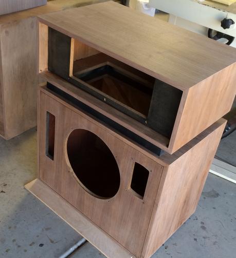

I've been thinking about the M19 and wonder if the best thing in some ways is to just leave it alone as designed, save for a few things. Looking at the stock M19 pics added below, there really should be no need to build the open cavity to the horn box, and have all that extra detail and figuring to do. Not to mention the vibration that would be all over the 811 horn from the soundwaves of sharing the same cavity with the 416 driver, and the potential for air leaks etc.
I think if one can figure out the internal volume left over in the horn cab after the displacement of the 811 horn, and then add that volume to the 416 cab or just recalculate a larger box for the 416, then build the 416 and 811 horn as separate cabs. Add sand to the 811 horn cab or lead shot, and make sure to use the foam around the horn like Altec did, then set it atop the 416 cab keeping the same C/C spacing. Also account for the volume of some extra bracing and use void free Baltic Birch for both cabs.
This would bring the woofer and horn height up a bit compared to stock while still having the same volume for the woofer and design feel. Also adding a bit higher of a stand at the bottom of the 416 cab could bring the height up some more as well.
Anyhow then you'd have basically the same look as a stock 19 kicked up a few notches. Better braced, better ply, easier build, higher driver height, damped horn, more better
Edit: Also for the horn cab mount the 811 flush instead of inset like on the stock 19, that may solve some sq issues with reflections from the wooden edges or lips of the stock 19 cab, and make the build easier as well. One could still layer an inch or so of foam around the 811 horn without the inset design, and tweak the amount for best sq in room.

Thanks for keeping me on the right track. I'm to easily distracted. Yes, so flush mounted horn and woofer front baffles, resized woofer cabinet (depth) for loss of cu/ft from separate horn cab and extra bracing. Closed back. Lead/sand filled horn cab. Same C to C spacing. BB ply. Time I get started. Now to find some 416.

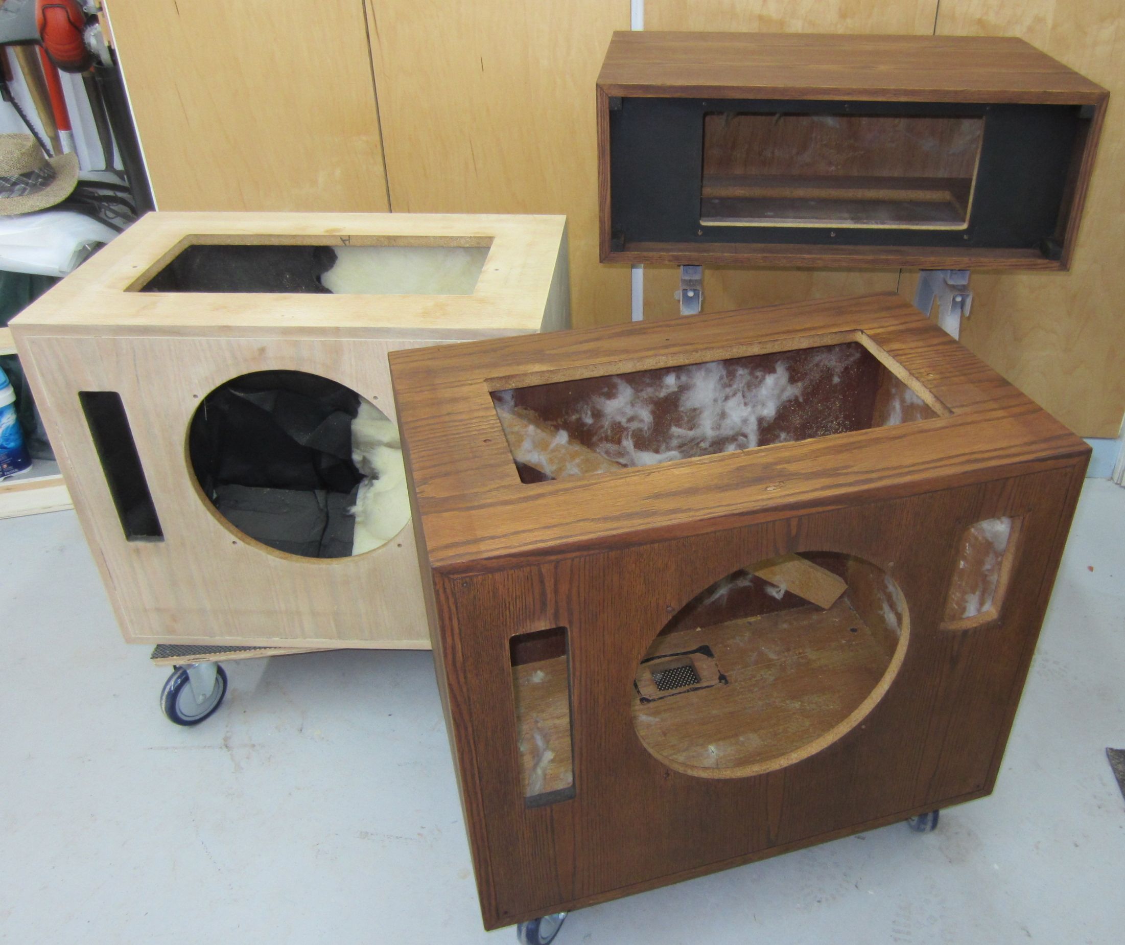

Hi there DC: Re: pictures in post #87 show the cabinet to be particle board insides? Also, the oak finished cabinet has a curious bottom vent with a cloth exterior cover. Is the front vent just a hole in the driver board, lined with a 3/4" plastic rim? The FR shown on the Model 19 specifications sheet posted (Google) do cover the general music audio range of 30 to 20K Hz, looks good to me. I never got that kind of bass response from a cloned VOT using stock Altec drivers, although the mid and high frequencies were acceptable to me. The cabinet was 3/4" plywood covered with 1/4" walnut paneling (1964 build). No cabinet now, but still have the stock drivers. ...regards, Michael

Thanks GM! I was thinking keeping baffle width and cab depth the same as a stock M19, and then just build up the height, so any new added volume we just build up for it and it becomes a bit taller. Also yes keeping the proper horn/woofer offset in both the vertical and depth planes as well. I figured building the horn cab separate with the same width and height as the M19, but maybe an inch or so less in depth. This way it could be moved back atop the 416 box without hanging over the edge to align the horn to the woofer, as I'd front mount the 811 and put foam all around it.
That was a great calculation to know GM, awesome! net Vb = ~8.622152778 ft^3
So could one make the 416 cab keeping with the same dims as the M19, but add height to make it say 10 ft^3. Then add the separate horn cab on top and keeping the stock spacing, would the stock crossover still work if everything is kept the same save for the height? Also tuning would be a bit lower I imagine as well.
They used Walnut, Oak, Birch laminated to Particle board Core (45lb density)
Yes the front vent is just cut out from the front panel, and the bottom hole is where the speaker terminal cup goes.
As in the example of the Volti cab below, I'd build the M19 811 horn in it's own box filled with lead shot/sand.
As in the example of a stock Altec M19 below, The horn box would be separate as in the Volti, and the woofer box would retain all dims except for height to accommodate more volume etc.

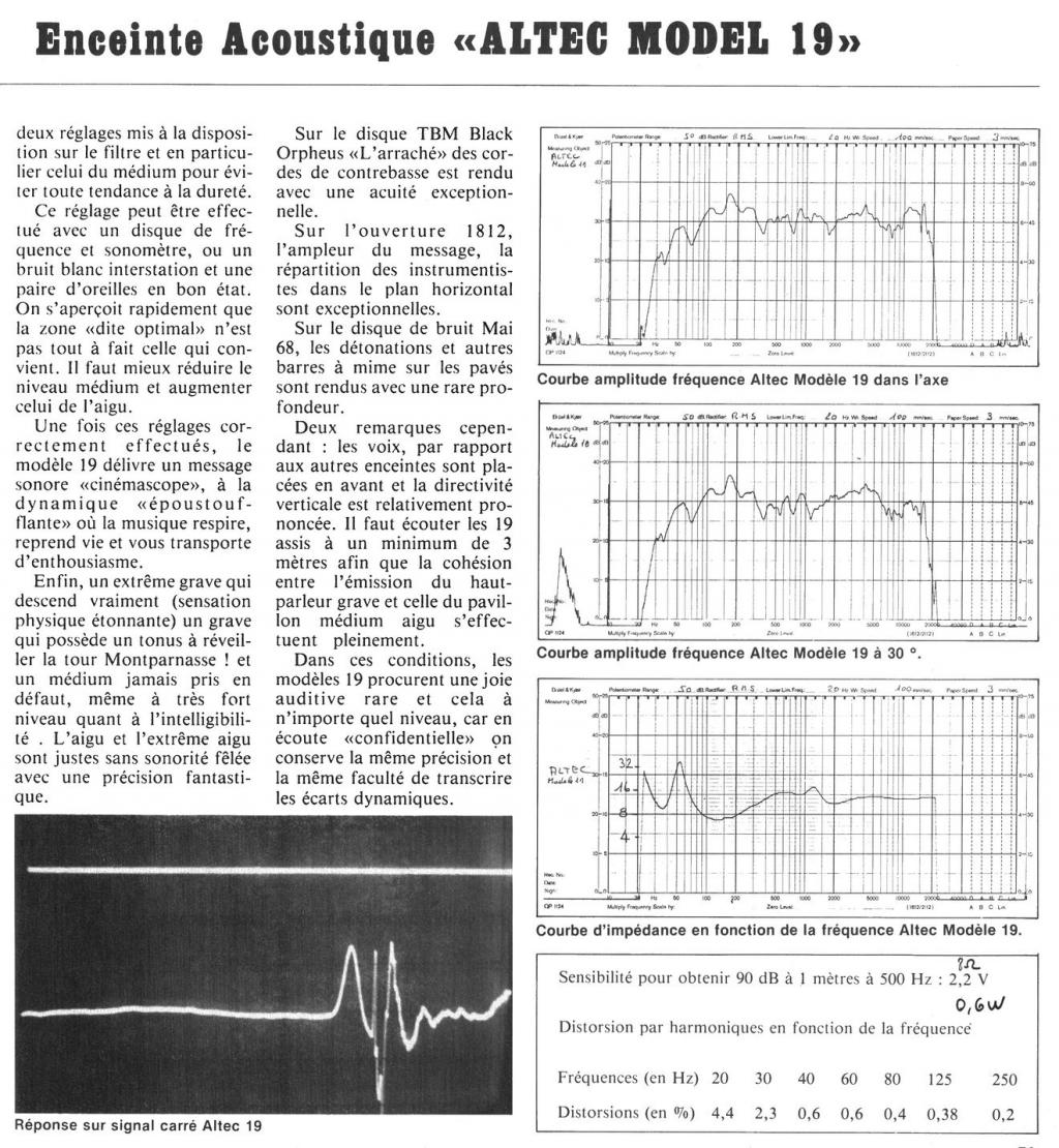

Thanks for the post. They were surprised that it measured so well in the anechoic chamber, both on axis and 30 degrees off axis. Bass was confirmed as very solid and tactile, low in distortion. There is mention of getting the midrange adjustments just right, leaving space between the box and the walls and needed to be at 3 meters or more listening distance. On the first page there was some criticism for lack of finesse in tonality for classical music. With non acoustic music the problem isn't noticeable.
