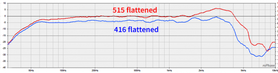

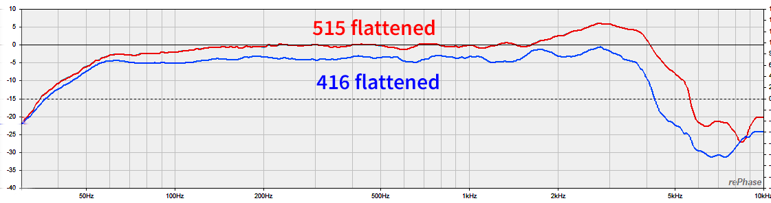

OK Lynn, I get the idea of the horn box.
I looked at you graphs of the 416 and 515 in a horn like this and did my best to flatten them thru the passband, which can be done with 2 or 3 filters. See the graph below to see where you end up after flattening the response of each woofer in the horn box.
Once flattened, they have a -6dB point a bit lower than you might think.

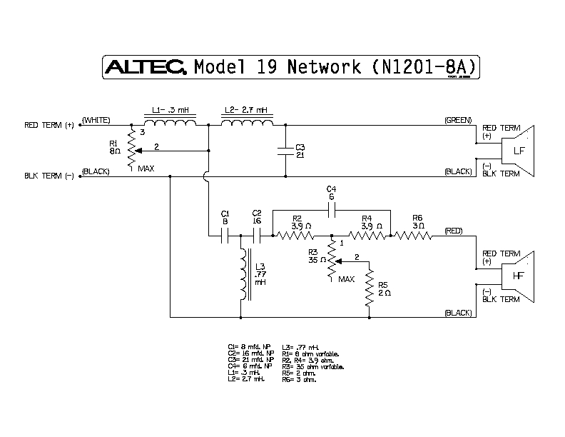

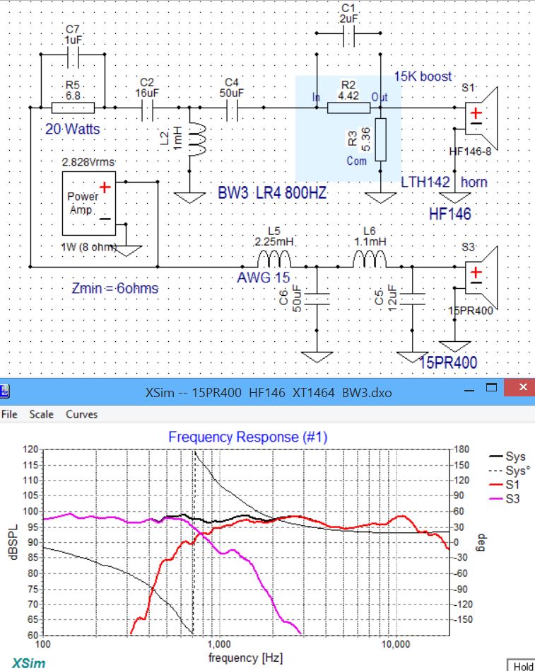

Is there a schematic for the 19 x-over available? I still plan on building the modified 19 cabinet.
Attached stock model 19 crossover. Google search will find a few alternative crossovers which attempt to improve tweeter-woofer driver time alignment, and also provide additional controls to adjust the tweeter tone and woofer baffle step to the room. I also attached an example Faital HF146 - 15PR400 crossover to provide some comparison.
