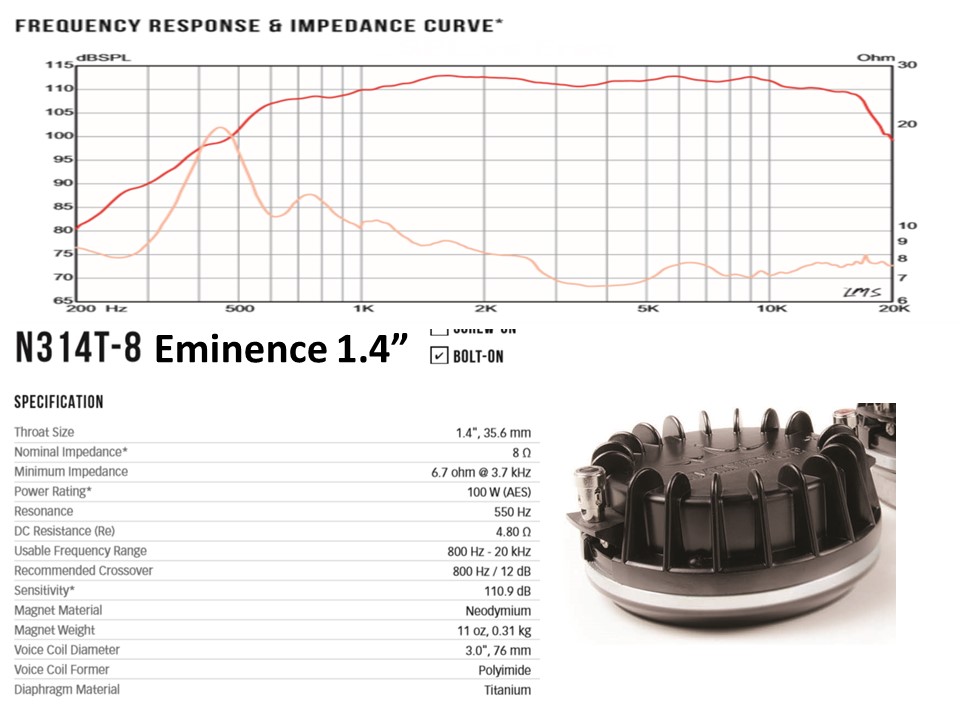

Eminence N314T compression driver
Eminence N314T-8 1.4" Neo Compression Driver 8 Ohm 4-Bolt

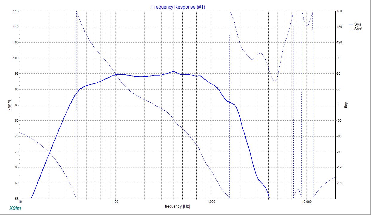

I agree that Eminence Legend CB 158 is a worthy component, reasonably priced. The simulation includes 250 litres vented, Fb=38 Hz, baffle step included, filtered through one LP inductor and an RC in parallel.

Eminence N314T-8 1.4" Neo Compression Driver 8 Ohm Ti dome 4-Bolt $200

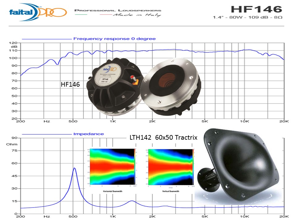

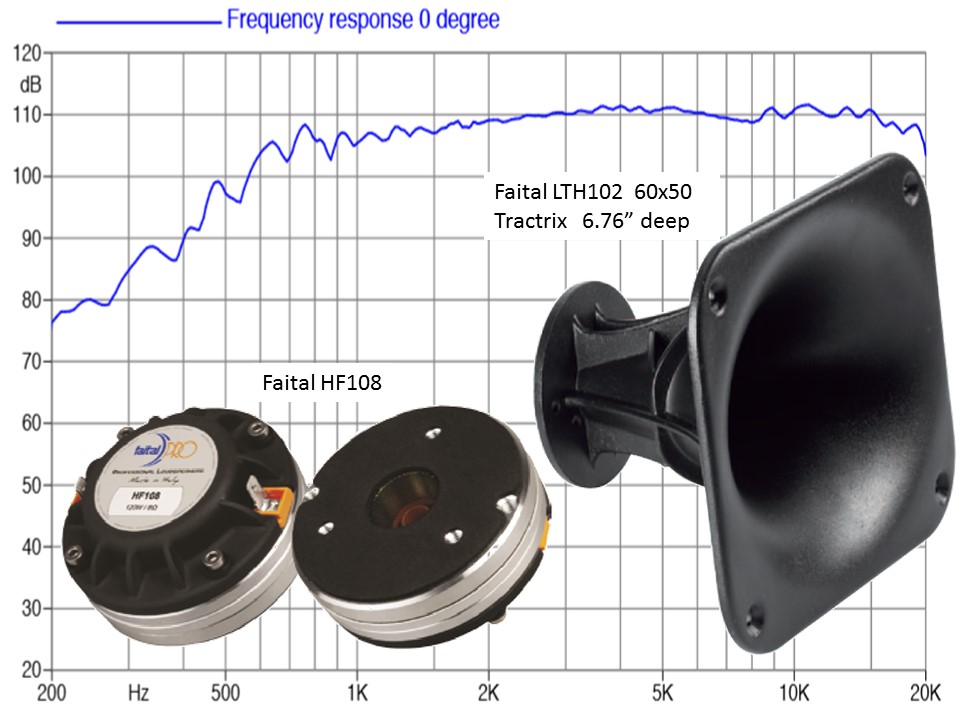

FaitalPro HF146 1.4" Neo Compression Driver Plastic dome $250
FaitalPRO LTH142 1.4" 60 x 50 Elliptical Tractrix Horn 4-Bolt. $60
