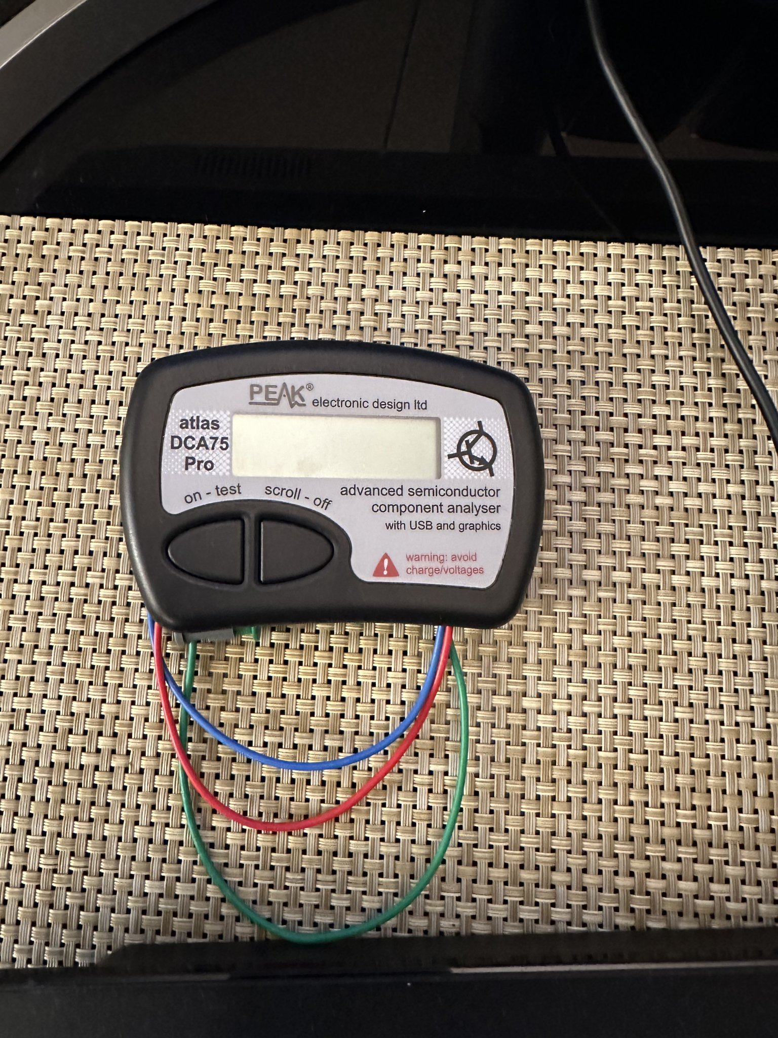

Hi Perry, I don't know if the channel produces audio. I do have a 4 channel lab cope. The bias was dead even on both channels before the capacitor change. I have my pos and neg rail voltages which lead me to believe the problem is a wire or connection to the driver board. The three-legged
transistors that I unsoldered to remove the main PC board had other existing wires soldered to the legs. I think possibly a bad connection when I resoldered the transistor legs to the board.
Ok, were good now. bias responds well on both channels via the pot adjusters. I found a brown wire going to one of the pnp transistor that had come loose. How do i know the correct orientation of the dvom probes. if i invert the probes on the test points the voltage is either pos or neg. does it matter?
Hi Perry, well after getting music on both channels for about 3 minutes there was a stream of smoke coming from the amplifier. the amplifier no longer powers up. what would cause the power supply to shut down like that? What is the most common power supply component that usally goes bad?
