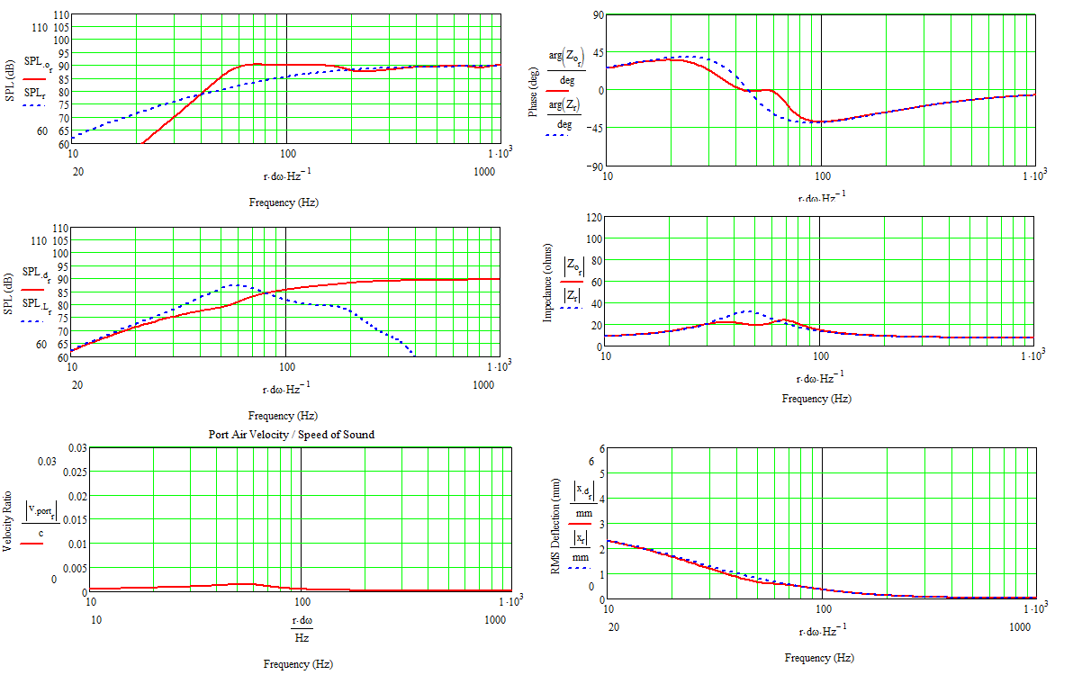

Pretty much Bob. For the sake of interest, this is the stock pensil alignment with the default damping levels; the target is broadband gain with the ~60Hz - 150Hz region where the majority of LF energy resides tickled up slightly to give a little extra slam factor (these things being relative), & as flat an impedance load as possible without going to a 'pure' TL. In practice they usually do a decent open E double bass, although the end results of course depend on what damping levels people prefer to use in their boxes.
The so-called superpensil (or the current one at any rate) has broadly similar characteristics except it's got another 10Hz LF extension, although it was intended for higher output impedance amplifiers to achieve the target response.
I should note that this is not the only MLTL alignment I use. ;) It just happens to be one of my favourites.
