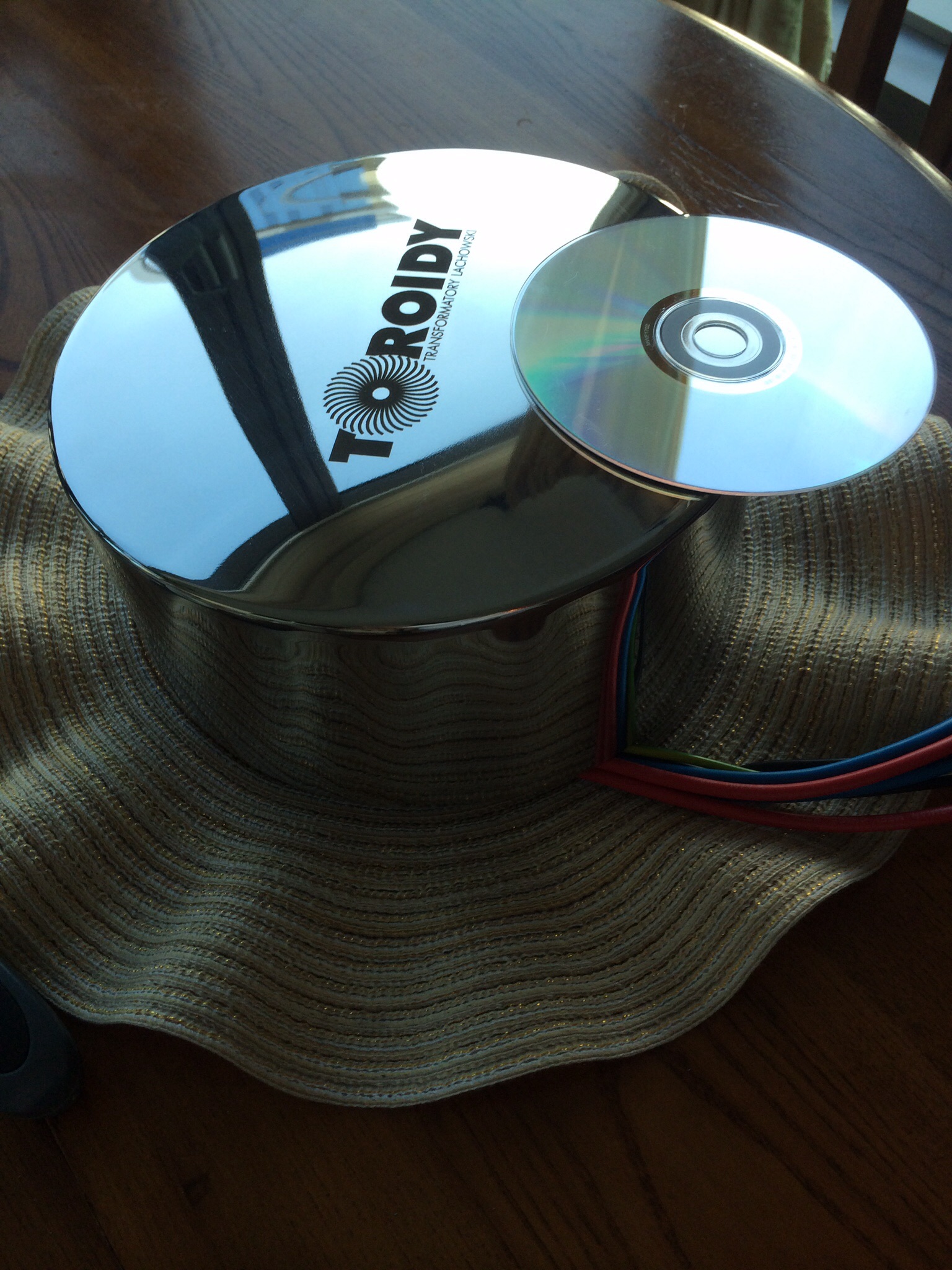

The first one of the pair of Toroidy Transformers arrived yesterday. I guess between Poland and Hawaii they got seperated😥
I knew the actual size, even made a template to use while I was building the chassis so I knew it would fit, but sure looks bigger in person. 28 1/2 lbs.
