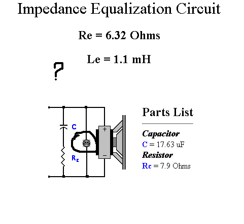

Yunick said:
Ya mean, you would add that woodo part (see pic)

The RC I have used even on tweeter fore a number of years
What is the other secret ingredient ?
BTW ... I do not understand the use of odd component values ... PLEASE do use standard values, as several paralel components to get the whished value sounds like ¤¤¤¤ ... sorry I am not allowed to say that, but it really does ruin good sound
I think you've gotta stick a little 'attitude' in parallel with the whole thing
tinitus said:The RC I have used even on tweeter fore a number of years
sorry- my bad ;
sometimes I just forget that we all aren't in first grade of DIY school
yes- real physical values (with which we make our calcs) are more spreaded than correction we made to implement standard values of parts ;
in particular case: Rc=8E and C= anything between 10 and 22uF , tunable by ear - what else

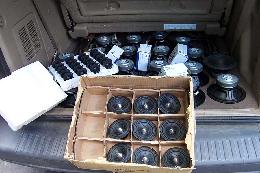

mpmarino said:Just came from the surplus store. Your looking at $45US worth - cleaned them out. I should be able to get a decent OB together if I felt like it. Woofs are peerless, mids are Tangband, tweets are vifa neo.
poor enough for ya?
