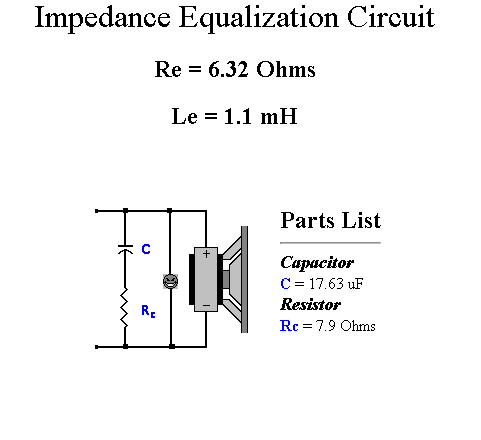

tinitus said:The 10db peak at 2khz ... well, actually from 800hz to 2khz
Should be no problem with "6db", it just needs an RC and a notch

I will have to investigate further on the RC and notch.. Maybe it's time to learn one of those simulation programs..

Yunick is at half way in making good xover for that combo ;
Beta's peak in range of 800 upwards is easy solvable with just Boucherot parallel to driver ;
goal is to stay at 6db/oct to preserve what we can preserve from energy of sig going in system .
slightly dislocated xover points for bass and main driver,along with just few minor correction elements and- finally - EnABL and phase plug will do the job .
