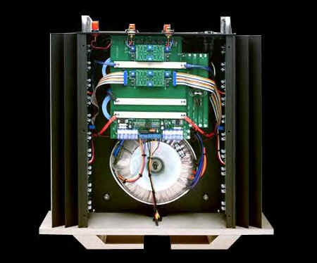

Why not also space them 7.5mm apart so we could use a PCB terminal block if we wished. If one wants to make a repair or modification, soldering and desoldering those large wires only a few times will most likely destroy the pads on the board. If you look inside one of Nelson Pass's production amps you will see he does use terminal blocks. If you look closely you can see them. Certainly couldn't hurt to but the proper spacing for a pcb terminal block and let the builder decide if he or she wants to use them. BTW, you should do this on both the main PCB and the Gain/CSS boards. Oh and please work on the board first, then have your 5 beers.;) :D
