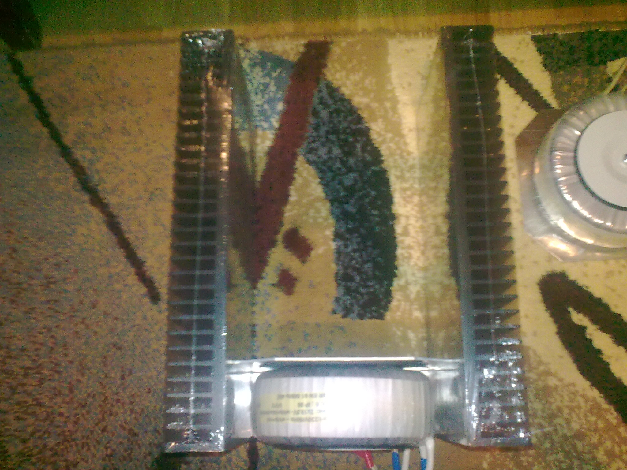

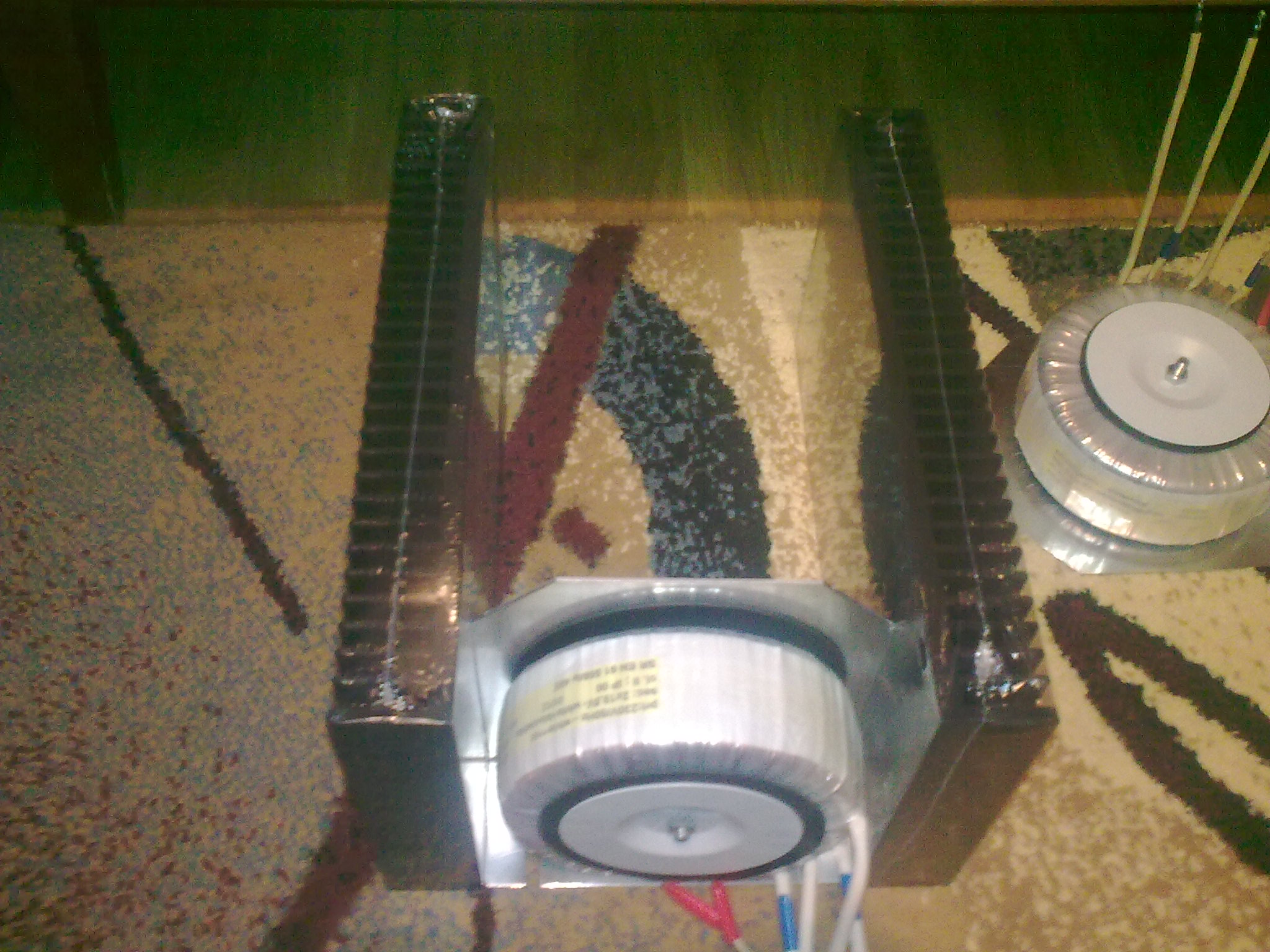

Hello
I have some speakers rated at 4 ohms with a minimum 3.5 ohms at 190hz, that is why i want to bias my amplifier at 1.6-2amp per fet depending on heatsink temperature.
I will build it in two monoblocks each monoblock having 2 x 0.31C/W heatsinks , one 400VA(2 x 19.5V/10A) toroid and an CRC filter 66kuf - 0.22-0.47R - 66kuf
From what i have understood i have to lower R16-R19 and R20-R23 to same value.Would 0.33ohms be enough or i have to lower the value to 0.27R?
What about R27? What value should this have? If want to remove definitely R27 what value do you recommend for R16-R19 and R20-R23 to have so i can bias the amplifier in the desired range?
I am thinking in lowering a little bit the raills to 22-23V so i can manage easily greater bias without having dissipation problems
And finally some first design pictures (for the moment i have only the heatsinks ,toroids,2SJ109 and matched irfp240,have to buy the rest)

First item is that you may have doubled the heatsink capacity, but the larger part of the thermal resistance is at/within the output device.
Going from 100W dissipation to ~180W (2A) by 4 output devices may result in similar heatsink temperature, but output device load goes from 1/6th power and 50% temperature range, to ~1/3d power and ~75% (~115C die temperature)
Second one, even 2A bias will not enable to reach 100dB at 190Hz.
(Plenty 4 ohm loudspeakers that do >6 ohm below and above 1KHz. Driving full Class A at 190Hz midbass is a luxury, similar to taking a full-size 4WD truck to a parking garage of a shopping mall)

Standard Aleph-J does 2.5A peak, twice the bias level makes ~5A (is for 2A per device, not 1.6A).
5 Amps times 3.5 Ohm is 17.5V peak, is < 12.5V continuous.
12.5V makes less than 20W in an 8 ohm load, is about 13dB up from 2.83V or 1W/8.
(from 20W to 200W is +10dB, from 200W to 100W is -3dB. => 20W is 7dB down from 100W. => 100W is +20dBW => 20W is +13dB. Me like head counting )
If your loudspeakers are 88dB/2.83Vac/M => 88 +13 = 101dB SPL.
Unfortunately, there's a thing called phase shift, voltage out of phase with current, so you'll likely not reach the 100dB level for 190Hz.
Try using the correct number at line 7 of William's calculator, instead of 50%.

As you said, 0R33 for R16 to R23.
At 1.6A, voltage drop across the source resistor will be a little above 500mV.
Vgs will be higher for 1.6A, easiest to adjust is by swapping in trimpots for the DC bias resistors, get a reading, then exchange for a same value resistor.
(btw, sensitivity of your loudspeakers is 86dB/2.83V/m, as you posted earlier. At 3.2A bias total you'll likely not even reach 97dB SPL at 190Hz. And looking at the impedance curve, even much less. Seems a whole lot of heat for little volume. Just mentioning it. http://www.soundstagenetwork.com/measurements/speakers/dynaudio_excite_x12/ )
