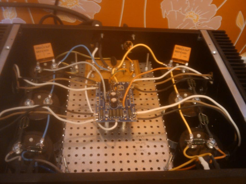

Horrible photo but should do the trick, doesn't have any fancy input. (I'm using XLR)
As it is now I'm using -21 db H-pad attenuators before the amp so turning it into a power buffer would probably be ideal, but for that BA1 might be more suited?

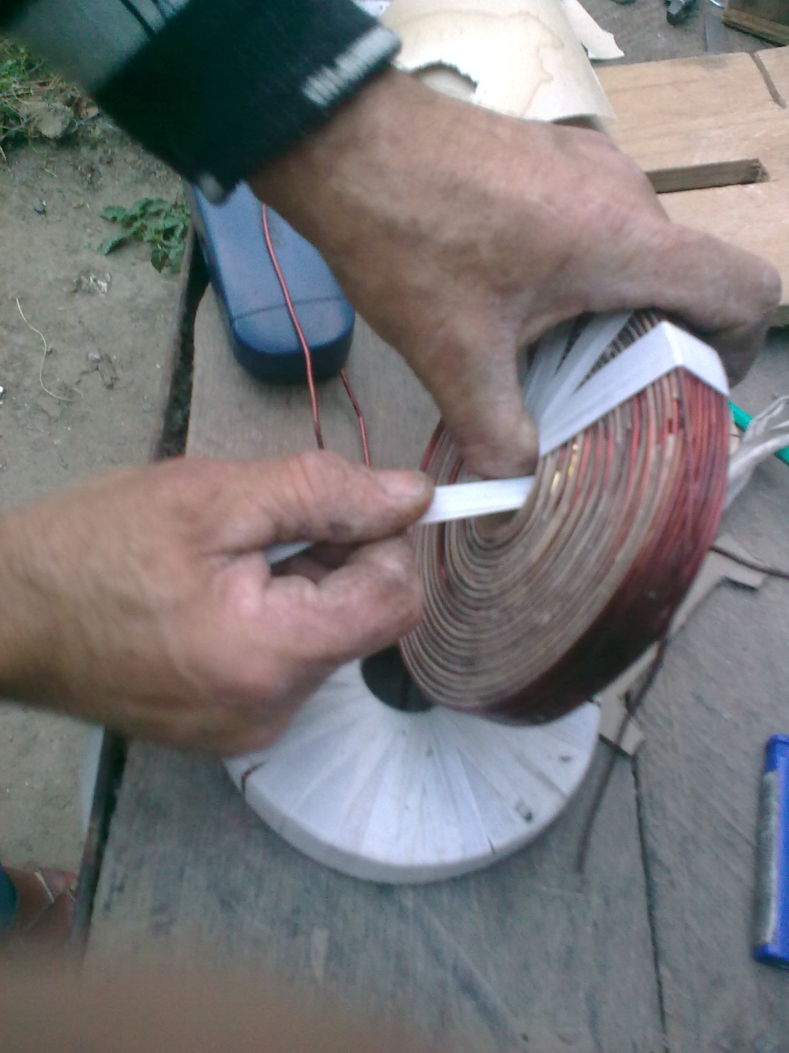

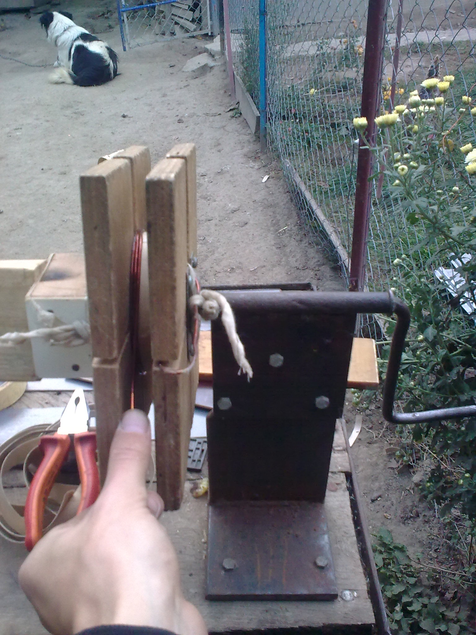

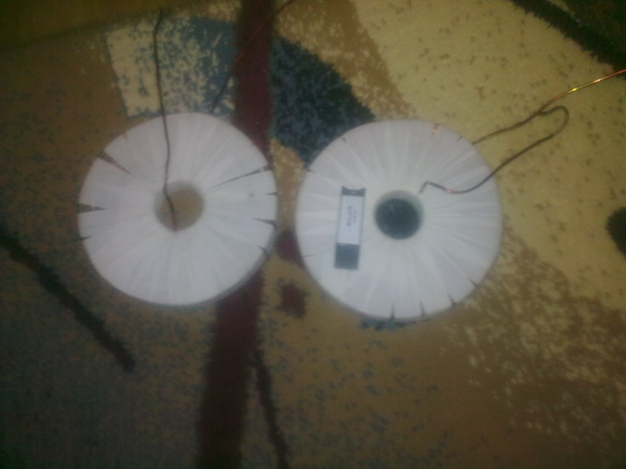

i have started with building the power supply filter coils.i have hand wounded them with Ø2mm copper wire and after a day of work i have finished 2 of them for one monoblock.now my problem is that one coil has 2.35mH and the other has 2.44mH(the bigger one has one extra layer).would there be any problem if one is bigger than the other ? should i get off the extra layer? or should i bring both coils to same schematic value of 2.2mH?
please help me so i could continue with building the last 2 coils for the other monoblock

We're talking 3% difference between the 2 here..... your transformers and capacitors have probably 5 times more tolerance than that.
In any case, the inductor are here to lower down the ripple, so they don't need to be matched at all. They need to have enough inductance to do the job... 2.44 mH is actually even BETTER.
and to go even further.... most people here are happy with a small R in their power supply (CRC) instead of the 2 L (CLCLC)... which is technically (theoretically) inferior, but just sufficient for the job.
