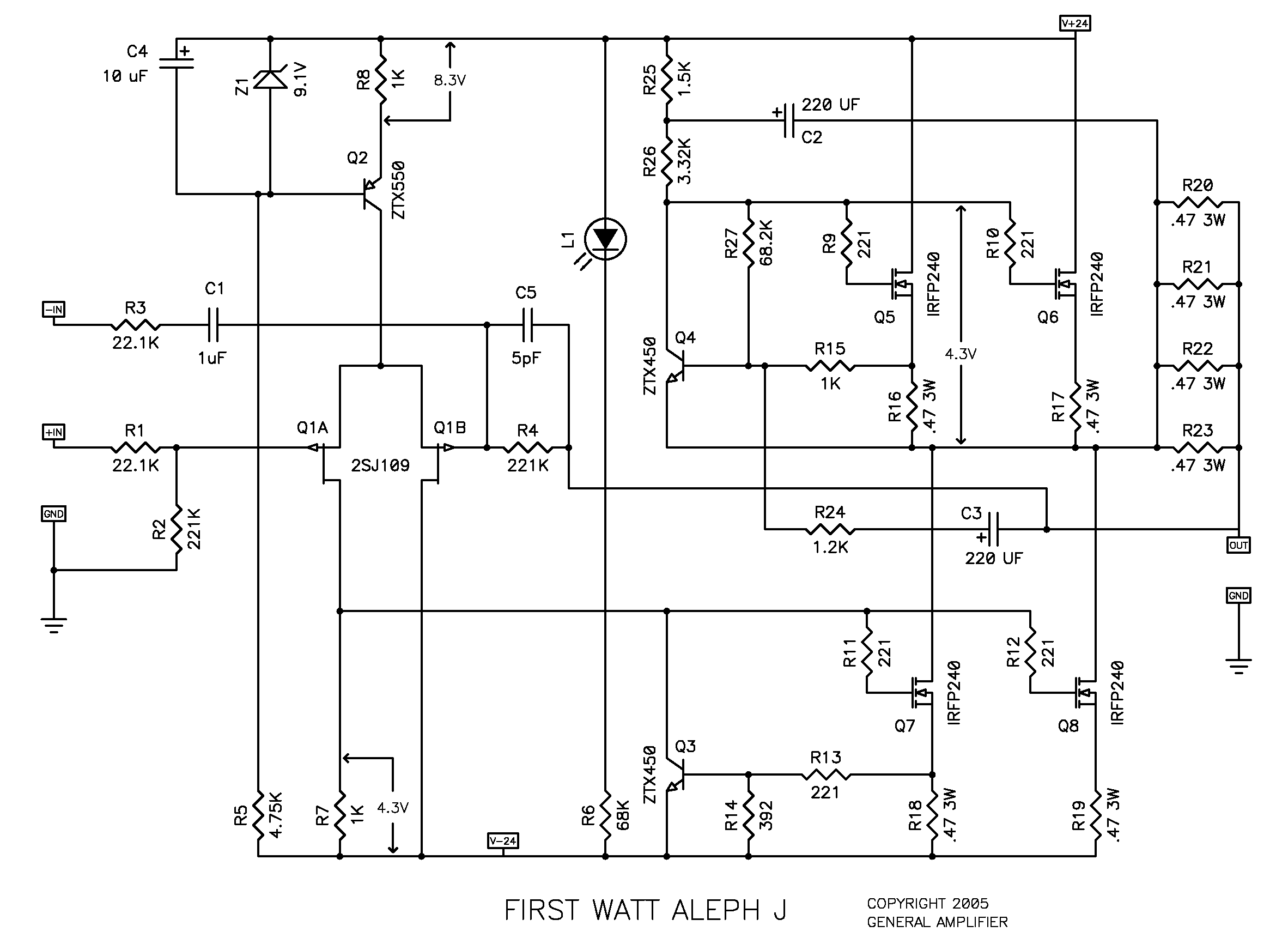

Hi
I would like to build an Aleph J. Can anyone help with schematics (original pass version) and/ or PCB's?
I have very efficient speakers ( >100db) and I do not many watts. What would be the minimun voltage rails that I can use?
Roberto
Look at the first post of this very thread....
And there is a corrected version here
http://www.diyaudio.com/forums/pass-labs/111197-aleph-j-schematic-7.html#post1343785
Thank you!
Thanks a lot Nelson!
