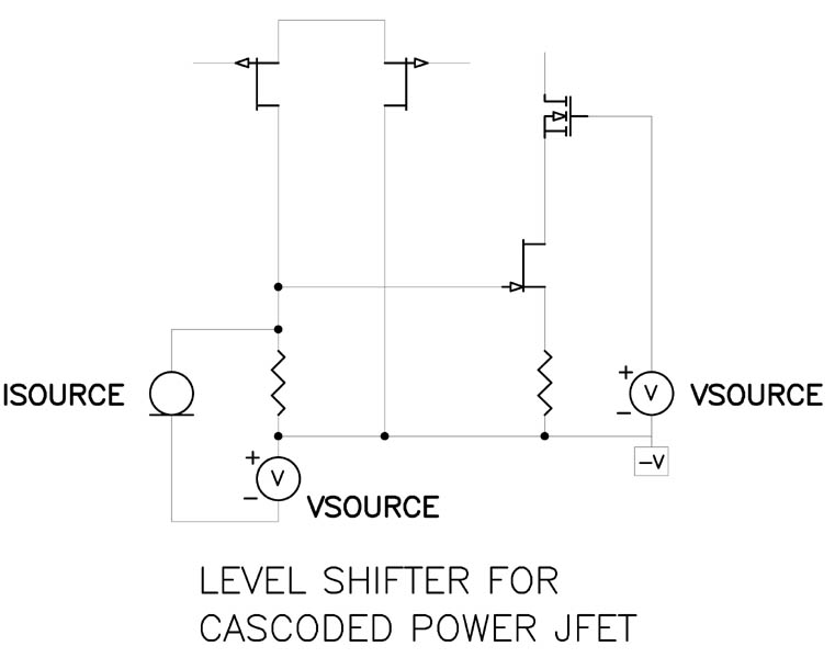

So, while driving home tonight, I have the following idea.
Actually so simple that I should have thought of it before.
Take the schematics from :
http://www.diyaudio.com/forums/attachment.php?s=&postid=1343785&stamp=1194303063
Replace Q7,8 by LU1014, then R18,19 to 0R66, then instead of driving the gate of Q7,8 with R7, add a high pass filter of 22uF / 10k in between.
If you do the maths, I don't think the open loop bandwidth would suffer much because of the high Yfs of the LU1014, and the cascode.
No rail voltage change necessary.
Now, this is really difficult to beat in terms of simplicity.
Patrick

Sadly, the Lovoltechs won't take that much voltage/power dissipation. You could cascode it, at which point you'd have a Zen #9 with a front end. The idea is seductive...however, the JFET front end will run out of juice if the amp is driven hard; the LU1014D draws a significant amount of Gate current if pushed. The ticket would be to add a strong follower after the first stage to ensure that the LU1014Ds get all the current they can eat.

EUVL said:> Replace Q7,8 by LU1014
Sorry. My mistake.
I meant of course Lu1014 cascoded by IRFP240, a la ZV9.
PS My understanding is that the LU1014 will draw current at the gate IF the Vds is high. I suspect that it is not the case for the Vds level as in ZV9.
Patrick
one little birdie , with gray beard and gray haired , with mucho funny hat on top of everything , told me that my idea is ......... full of drek
anyway - if I understood you correctly - ya mean that drain of input jfet will be connected via 22uF to gates of lovoltechs , and that 10K is for ground referencing of LU gates?
if you think like this - that's boiled water ........ triode LTP with totem pole output ....... and then you need servo for offset maintenance .

EUVL said:Replace Q7,8 by LU1014, then R18,19 to 0R66, then instead of driving the gate of Q7,8 with R7, add a high pass filter of 22uF / 10k in between.
This will work, but of course you will need to deal with the DC.
The same is true of transformer coupling. Of course on the ZV9
the DC is adjusted via the cascode voltage.
Zen Mod said:one little birdie , with gray beard and gray haired , with mucho funny hat on top of everything , told me that my idea is ......... full of drek
I thought the word was "merde". The problem was that the
Source current of the JFET was passed through the Mosfet that
you used as the level shifter. An alternative here is a separate
supply for the load resistor off the input JFETs, regulated to the
AC value of the main negative rail, but minus a few DC volts.
> Try this one.
Isn't that the same as post # 258 (which I built) ?
http://www.diyaudio.com/forums/showthread.php?postid=1358353#post1358353

Patrick-
Since you asked:
I'll will whine again about somehow getting rid of that distortion in the active current source at high output level and high frequency? Any ideas???
What causes it, anyway?
is it voltage dependent?
is it current dependent?
or is it due to some characteristic of the source vs. the drain???
