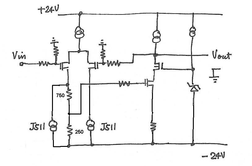

EUVL said:> .........
A better one would be one without any additional -ve supply.
That is now the challenge.
Patrick
if we use slightly higher rails - is it cheating?
and - rail to rail is must?
EUVL said:> if we use slightly higher rails - is it cheating?
No. But that gets you back to post#241 which is really equivalent to the first solution in post#220..
I have the feeling that you are really going round in circles right now.
Patrick
hehehe ........ then teach me .......
there it is - another perpetuum mobile from ZM's cousine
EDIT:
have you measured data for LU xconductance?
The J511 on the RHS somehow stops the diff pair from working ??
And splitting the 1k into 250 does nothing but reduce 1st stage gain by a factor of 4. In fact, the 750R might as well be removed.
You can calculate from the slope of Id vs Vgs.
Under ZV9 bias, it is about 4S, and the source resistor is dominant.
Patrick
Patrick
EUVL said:The J511 on the RHS somehow stops the diff pair from working ??
Patrick
so looking at difference between LU and , say, IRFP150 - it's >cunning< to increase drain res for same ratio .......
naah ...... maybe I'll just use nice choke under that 2SJ
EDIT _ I know that that J511 can't work like that ........ I told ya that is Perpetuum Mobile
EUVL said:> naah ...... maybe I'll just use nice choke under that 2SJ
Good. You get 0V across at DC, right.
BUT, now you need a choke that has a constant impedance from 20Hz to 200kHz, or you have frequency dependent open loop gain. AND 90� phase shift ??
Patrick

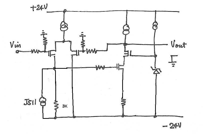

Zen Mod said:
is this cheating?
I think that this schmtc is good enough for start ; without Aleph CCS for start ( without CCS modulation) , just twidling with few parameters ; it's easy to implement right amount of modulation for upper half .....later
edit:
I forgot to say that PSU filtration is premised to be good ......... anyway , same as for any A class amp
