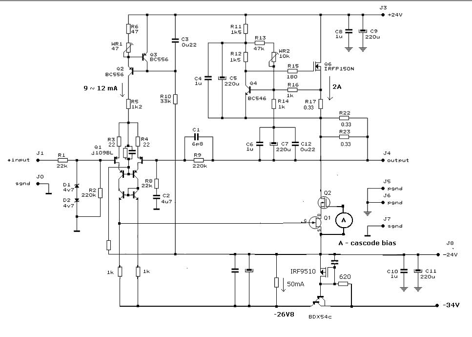

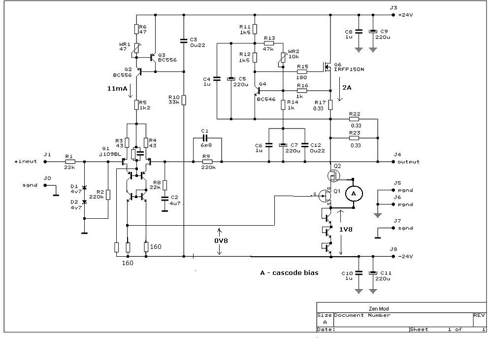

Diff pair first.
Drain resistor is lowered to 160R.
R3 + eq. source resistance of the J109 (= 1/Yfs) is about 80R. So your 1st stage now has a gain of 2, instead of the original (1k/40R=) 25.
Of course you can parallel 12x LU1014s to get it back.
But you may also choose to use 7x bipolars (min 3W each) below Q1 and change the diff pair drain back to 1k. That would be in principle the same as using a 25W 4V5 Zener below Q1 (post #220).
Seems like 2x J511 at diff pair drain is still the front runner ......
Minor details; but that is also where the devil is.

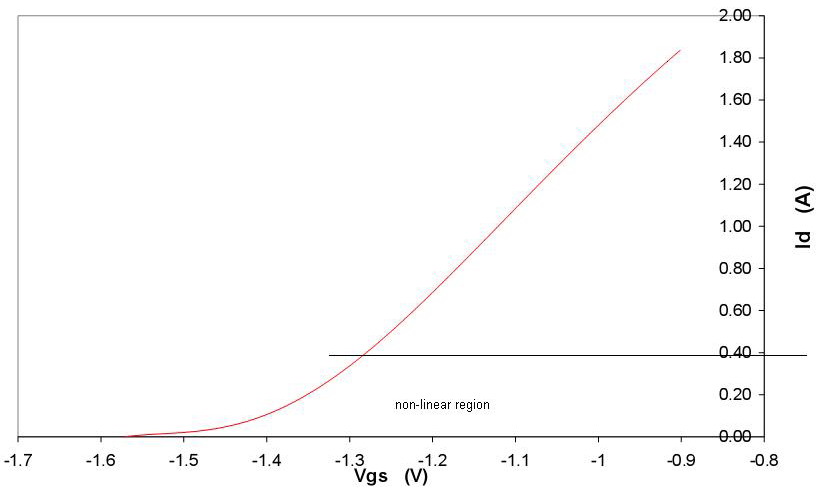

Man responsible for that fine graph is my grumpy fellow from Germany ........... his nick is starting with E and finishing with L ........ four letters ..........third letter is V ,second one is U

One hint : a cascode LU1014 has WAY too little capacitance as seen by the diff pair source resistor compared to uncascoded IRFP240s.
Patrick

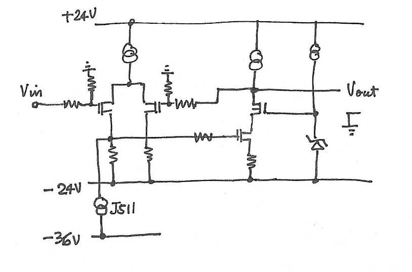

> gimme your proposal
Already did.
http://www.diyaudio.com/forums/showthread.php?postid=1355853#post1355853
Keep the 1k (820R) drain resistors connected to -24V.
Connect an additional J511 from the J109 drain to -34V.
The J511 drains the 4mA bias away to give you 0V across the 1k resistors, AND gives you PSRR between -24V & -34V rails.

draw me that .
I can't exactly catch what you mean
EUVL said:Quick & dirty, just to illustrate the idea.
Patrick
yup; I see now .
that's cunnin' ........... hehe - even more cunnin' than my cunnin'

in that case you don't need 1K in right half of 2SJ ;
so - there is no need for current mirror
editedit:
after third look .........
dunno it is J511 solution really simpler, just because we still need pretty nice filtered lower lower rail
I only build balanced. So I actually would need 2x J511.
The J511 has a dynamic impedance of about 300k. That is a lot of PSRR (>45dB), compared to none if you hook the 1k to -28V.
> at least - there are now more than just two paths for solving that ..... I see now at least 4
A better one would be one without any additional -ve supply.
That is now the challenge.
