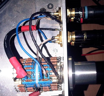

well, first impression with this aleph j was a bit clumsy
but the detail and other goodness can be feel directly
so i think, the component need to be break in for a while.
several days waiting, no changes in sound quality.

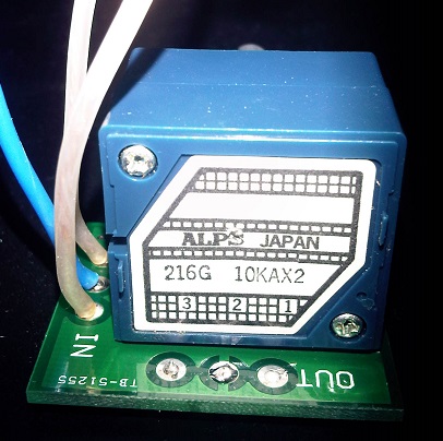

and then i try to change the volume pot,
before was alps blue velvet 10k
changed into this 10k 24step attenuator
very very much more improvements
finally the true sounding of aleph J can be heard clearly.
a real nice amp. no regret. i love it.
