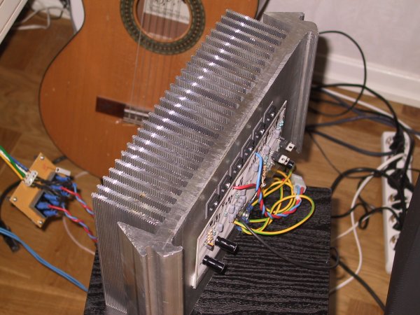

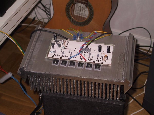

Aleph30 measurements again
It was quite some time ago I did my initial measurements. Now when I have some real speakers to play on (finished my ProAc 2.5 clone project the other day) I had to assemble the second channel. No pictures yet, but I found out that one of the channels were a lot hotter than the other one. Both gets really hot, but I got the answer from Mr. Pass a couple of months ago, pointing towards the "BC550 transistor instead of ZTX450"-direction.
Here are the measurements:
Well I believe I dissipate 127W on the left channel and 93W if my calculations are right. I'd like to keep myself in the 100W playfield. I know I have quite a bad matching of the Q's on the left channel. (I wonder how bad it can be?)
So, my question (for which the answer I've been searching for on the forum for a while today) is:
Is it correct to lower the value of R19 to decrease the bias? Should I tamper with any other resistors?
Best regards,
//magnus

New measurements
Well...
We'll se how it turns out with R21. I did that aligatorclip thingie...
It turned out pretty good... Cool, I never thought of using a large value resistor in parallell with R19. R19//470k = 43.1k
It looks a lot better now.
