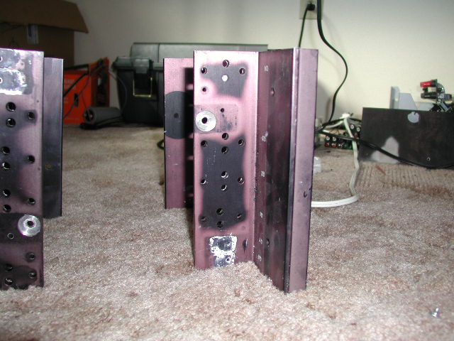

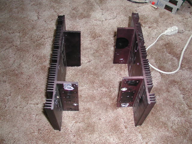

3/4 from back of base to tip of fins and the initial heatsink ie flat back is 7" x 12" and the l's on the base are 2 " aand the base thickness is 1/4 " and the l's are the same if yuo need any more info let me know and i dont know what to charge i know i cant use them and i want to get 2 heat sinks for my aleph 5's im making mono blocks and need 2 heat sinks one per block ..
