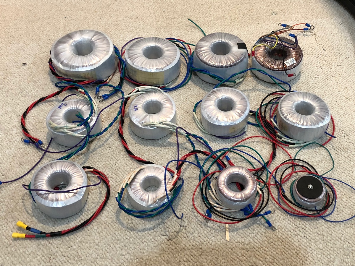

I guess I went about it the wrong way, and rather having multi-tap, I have individual ones (15v, 18v, 20v, 25v, 28v, 32v, 35v, 42v,...). These are all the ones that are currently free. The 400VA 18VAC is tied up at present driving the Alpha 20. And a bunch of other smaller 25VA 15VAC ones are on smaller headphone amps and such.

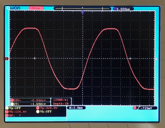

I measured my AC mains with an O-scope and it looks pretty badly distorted. It measured 320vpp and 124vrms but resembles a rounded sawtooth with clipped tops and bottom. Pretty ugly, but the other transformers don't seem to mind. I can see why some people get a power conditioner where they rectify and invert and generate their own clean sine waves.

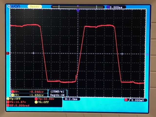

I tried several different outlets and all without any big load running in the house. Just the distortion in the mains will make some nasty higher order harmonics at the bridge. The output of the secondaries leading to the bridge looks like low slew rate square wave. This is under load with amp on and flowing 3amps, We get 32.8vpp:

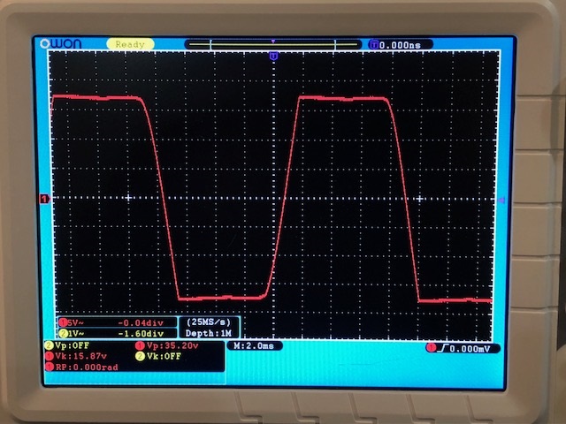

Here is the waveform of the secondaries before the bridge under no load conditions (bridge still connected but amp +ve and -ve disconnected). We get 35.2vpp:
So this may explain in part the strange behavior I am getting. With the secondaries flat topped like that, does that mean the transformer is saturated or is it supposed to look like that leading to a rectifier bridge?
What does your AC mains look like on a scope?
