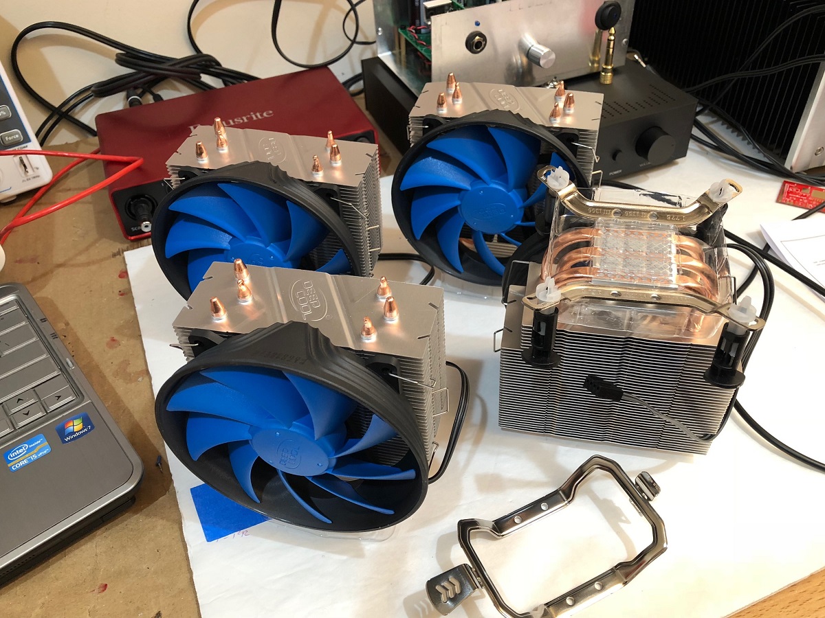

My BB CPU coolers arrived. These are really nice. (note that just order them directly from Amazon rather than the eBay link I posted as that is a drop shipper store that just resells Amazon). Anyhow, these are triple heat pipes with direct contact to the MOSFET being cooled. I hope the included brackets line up with JPS64's holes cutout on the PCB. I just got word from Hugh that we will only go with single large outputs rather than allow for three smaller IRFP's as they need to be matched over both Vgs and Gm, a real difficult problem requiring a sample size of at least 100. So let's just buy the $8 big MOSFET and be done with it. So PCB will not have triple output option. I will order a small order of 5 boards to test the amp and make sure it works before offering the PCB as a GB for the Forum and then committing to a big order.
These are PWM fans with 4-pin connectors that I assume will fit the pins that JPS has spec'd for the fan controller board. That board has an NTC temp sensor on 2-pin connector and that goes to the cooling block and the fan speed will be adjusted accordingly to keep noise levels low. The 120 mm fans are supposed to be really quiet. This is a pretty high tech Class A amp and it will resemble a computer more than audio. Actually a PC cabinet may not be a bad thing.

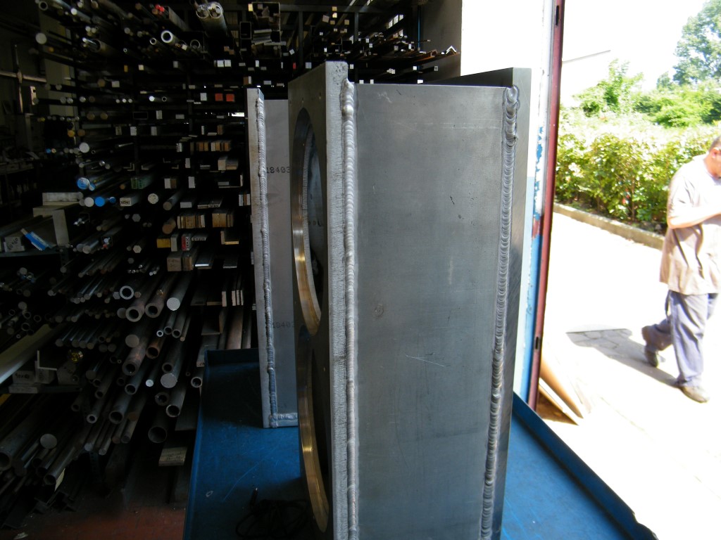

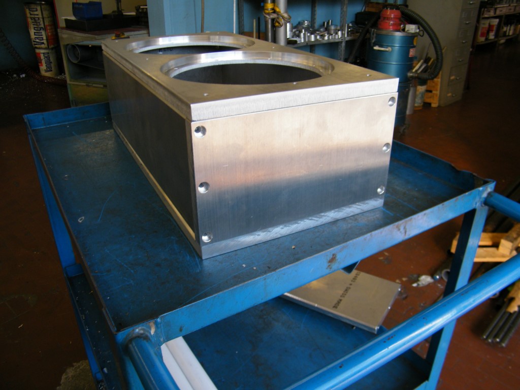

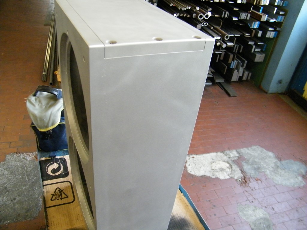

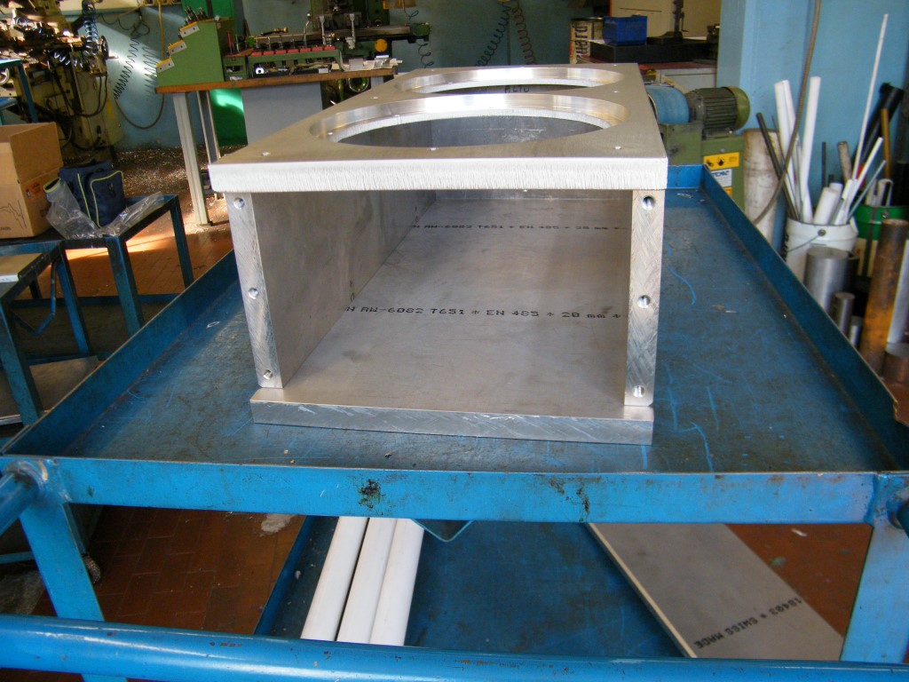

It would be an incredible waste of fund, energy etc, to give up the already existing 15" tall about 25-30Lb heatsink enclosure (ready-made for an Aleph 4) and start from scratch with fan cooling what I hate so much. My second amp was a Technics fan cooled cr...... always shut off the power. I said never again. But the main reason these over to me because I have everything ready, transformer, heatsink, PS caps etc. I do not have the tools to do it by myself with the 3 par transistor. I wish you good luck to all for your build.
