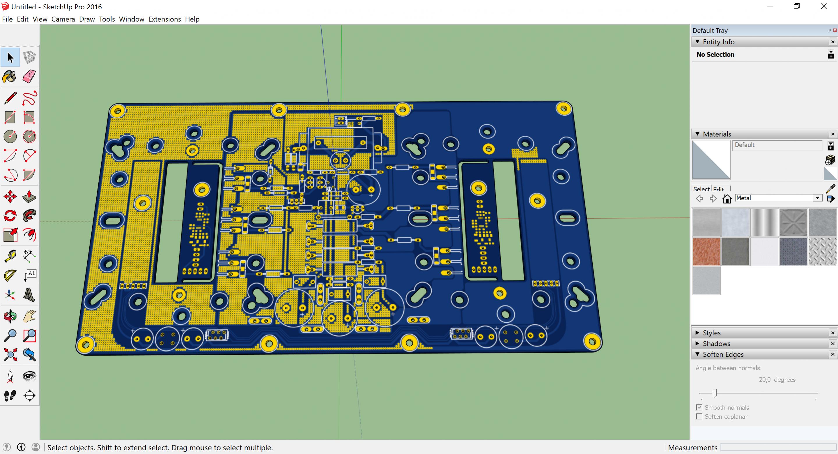

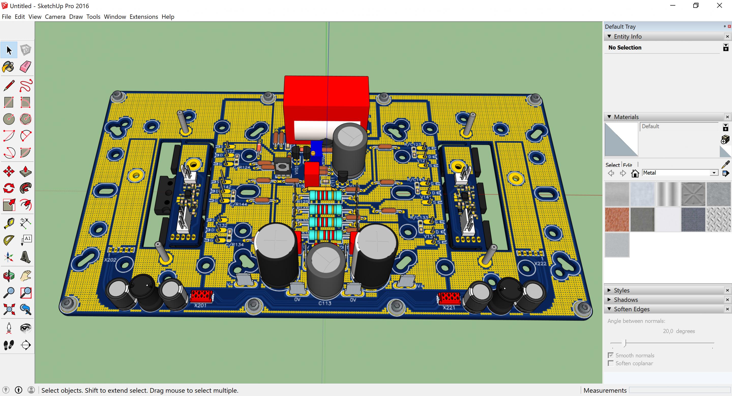

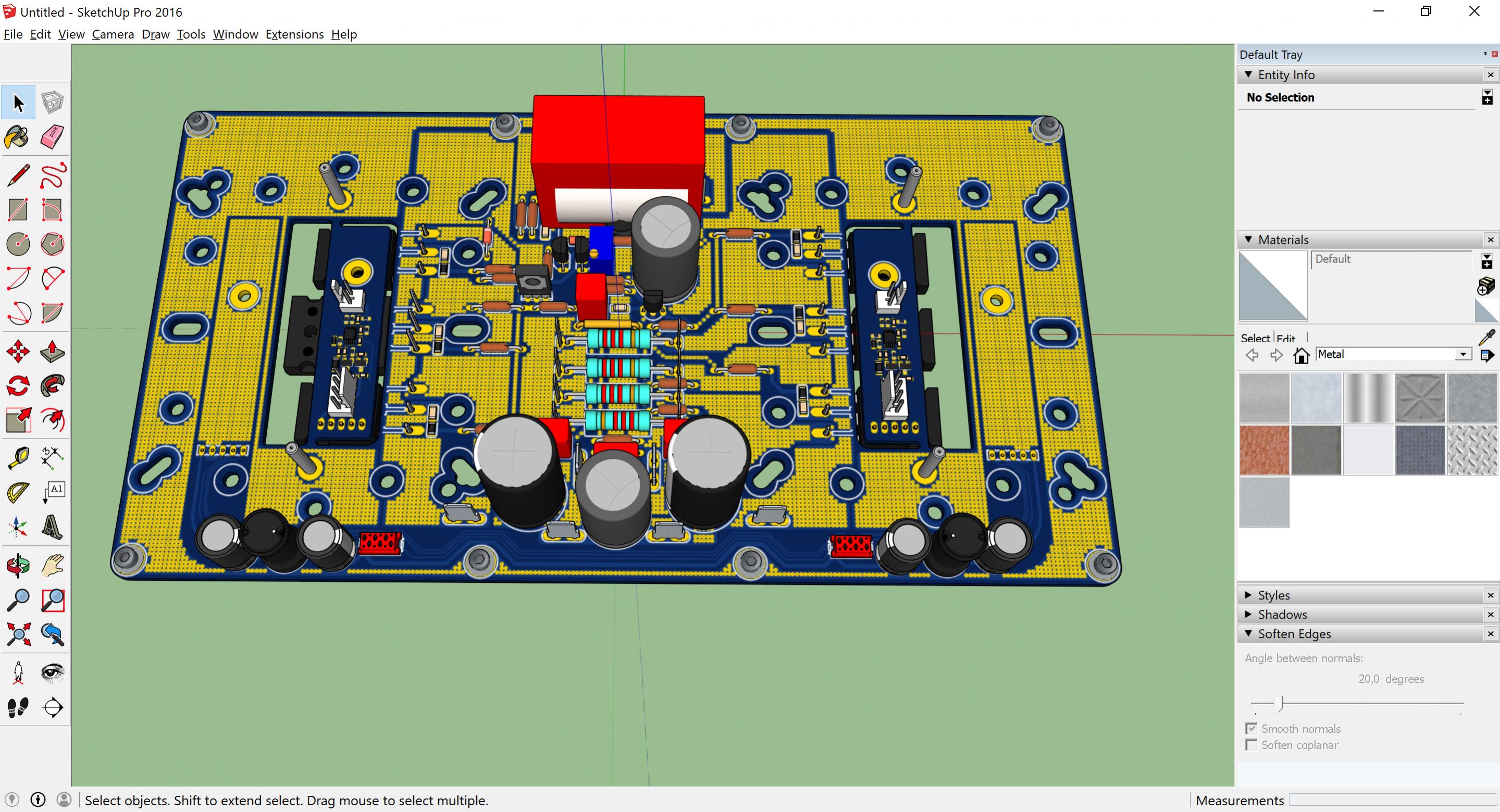

Will do, these are just latest developments. It will work with 0.33R and 0.12R resistors, but just burn a lot of heat. The feedback resistor value of 22k is still recommended by Hugh if you don't have a preamp with gain. So I would leave that as is for now. I might just add a note in red text next to the schematic on the first post (only post that can be editied in time).
work on progress...
JP
Founder of XSA-Labs
Joined 2012
Nice work JP! Beautiful look with a bizzilion vias! The PCB board fab houses will love this design. Can’t inagine how many drill bits they will go through?
attachment.php
It reminds me of filigree in archaic artwork with detailing. Do the plated vias dexrease Wright or increase weight of boards?
I like the breakout PWM fan controller boards too! Nice touch.
What is your average (non peak SPL) loudness? I typically listen at 80dB (not dance floor 89 dB). So 15dB peak for DR is 95dB. For 82dB speakers to get 95dB is about 16w I think so well within range of this amp. If you like THX 115dB top end then that’s another matter. Only pro audio speakers or big multiways can do that.
