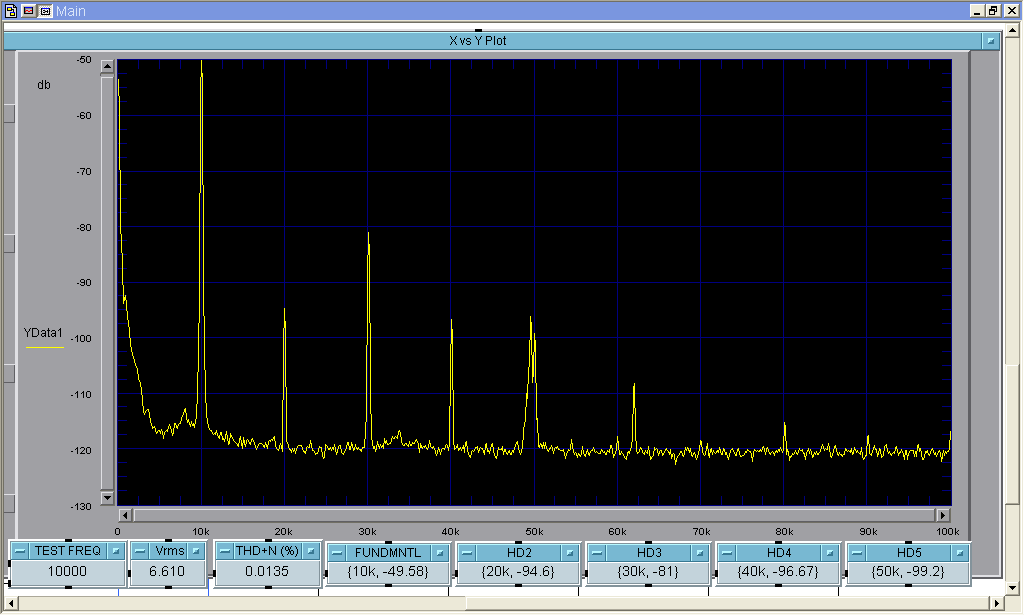

...The THD + noise you're citing is at the final measurement, where my power supply runs out of steam and clipping is starting. The 1k THD + N power plot looks pretty good with the 1 watt reading being about .007% (note the vertical scale 0 to .045%) - as mentioned above I believe that it's better than the graph shows. What the graph does say, is that the noise is low, otherwise you would see a steeper drop in the graph as the power come up.
The 10k spectrum was made with a Krohn Hite 4402b as the source. In it's current state of tune the KH measures .00018% THD at 10kHz 1Vrms. Using the Harmonic values of the 10kHz 1vrms measurement (the values could be lower than whats shown, but, it's all I've got) the THD calculates at 0.0012%. The 10kHz 6.6Vrms calculates at .00925%.
It looks like above is FFT near clipping which typically will be 3rd order. Is there FFT of Fetzilla at 1w or 8w rms?

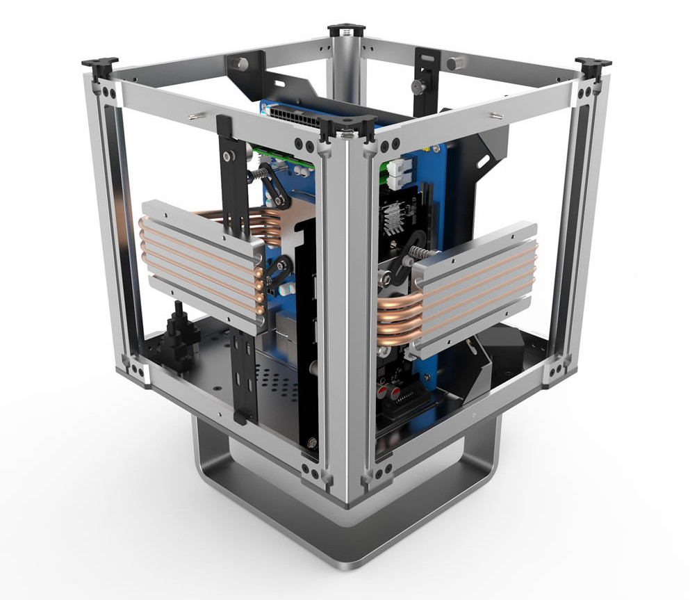

Ooooh... I like this look. Can you get link?
Streacom DB4
It could be a slight challenge as the chassis is intended fanless but they offer an interesting folded heatpipe-LEGO to get the processor or GPU cooled against the side walls. Flexible system of clamps inside could simplify the build. Upper deck has on perimeter four narrow slots and the bottom a big one for the cables so a slow silent fan surely could be mounted inside. The walls are 260x260mm of 13mm alu IIRC so for ALPHA 20 cooling must be viable. I actually wanted my current ICEPower 125ASX2 be my final amp but the ALPHA and this case make me uncertain...;-)

Thanks, Schlomoff...
Built in heatpipes to large external radiator - I like that. But may have to be large monoblocks. The prnicey for two chassis.
Love the design though. Although gives me ideas for use of Bosch Rexroth extrusion channel and a large sink from Heatsinksusa...
Exactly what I was thinking. Would be great if you could DIY the heatpipes to large external heatsinks. That could make for some very clever layout designs, possibly allowing very efficient use of space and short wiring paths to power, input and output.
There might be a COTS solution but I am afraid it won't be cheap as using CPU coolers.

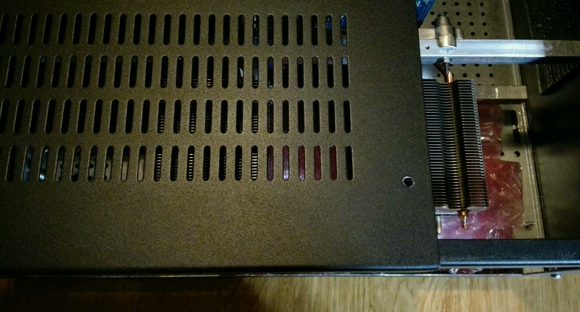

My building might be little confusing..that big proto-frame that I have been showing, it's one channel for BigBoy, there will be two identical of those.
So i'm already doing those side by side with Alpha20.
For Alpha20, I will try those Dell server heatsinks with fans, I'm missing toroid, fans and couple of components from pcb. That black case is Alpha20
Edit: so question is; is it better to suck air through the heatsinks and out from the case? Or blow cold air below and through the sinks? I guess sucking is more efficient?
On CPU heatsinks with thin spacing between heat exchanger fins, I believe the standard is to push air through the fins. Once through the fins it probably makes more sense for the hot air to exit the top or side of the case. Perhaps a sketch of your case and how you want to route air would be useful. But you current layout looks like it would be easier with fan on top sucking air through fins. Try it and if temps are reasonable, keep it. No set rule here in DIY.
This one is going for basic modushop case atleast at first (I have hands full for 2 BigBoy cases now)
Pesante 04P400N 4U 10mm NERO
Sorry for bad photo from previous post, but as seen there, heatsinks lay horizontally in backside of case and I built them much like Vunce did his. Cover is moved a little aside in the photo, so you can see a little insides also
