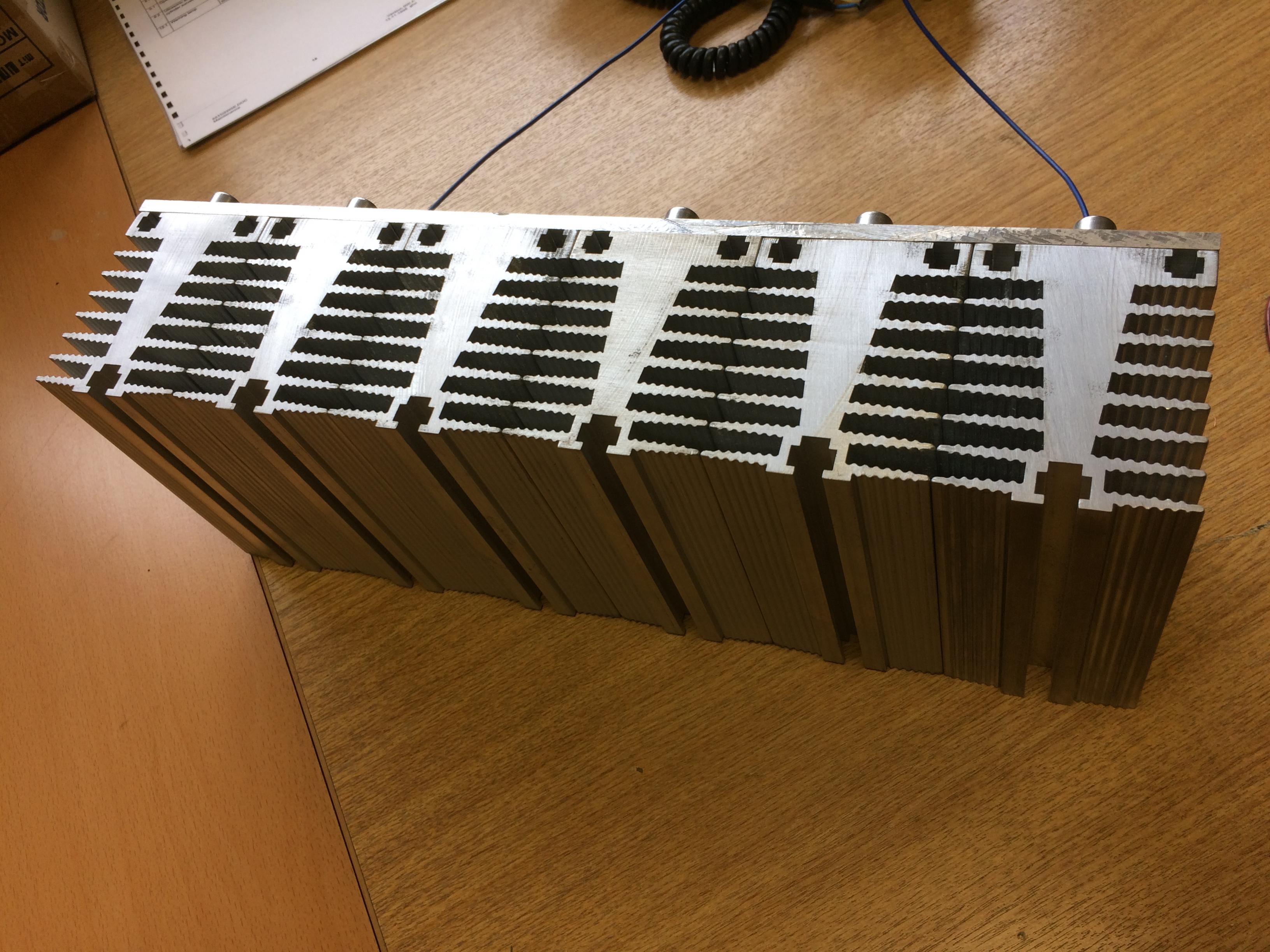

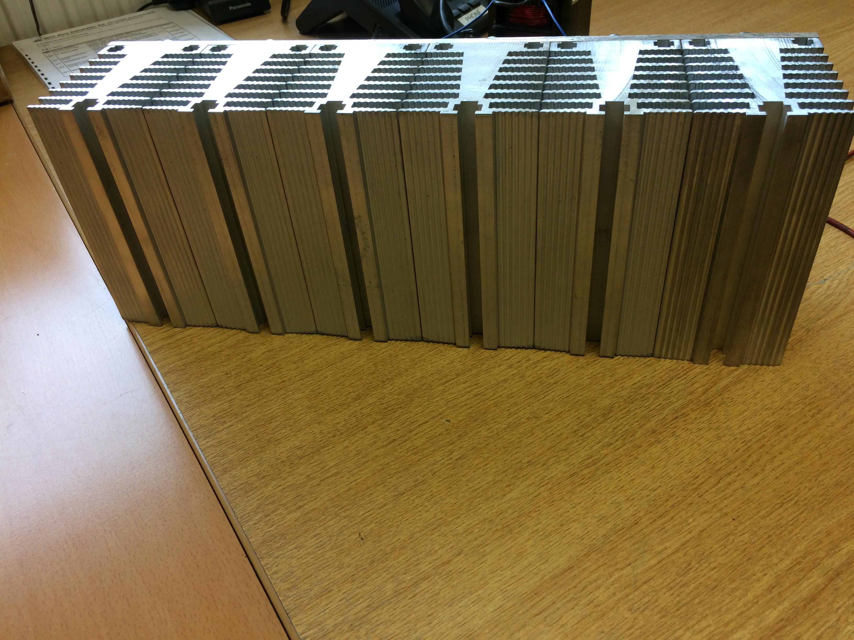

I have two banks of heatsinks as shown in the pictures, I do not know the CW of them, perhaps someone can assist and say if they will be suitable for one channel each ( 20W version )? They measure 400L x 150H x 90W.

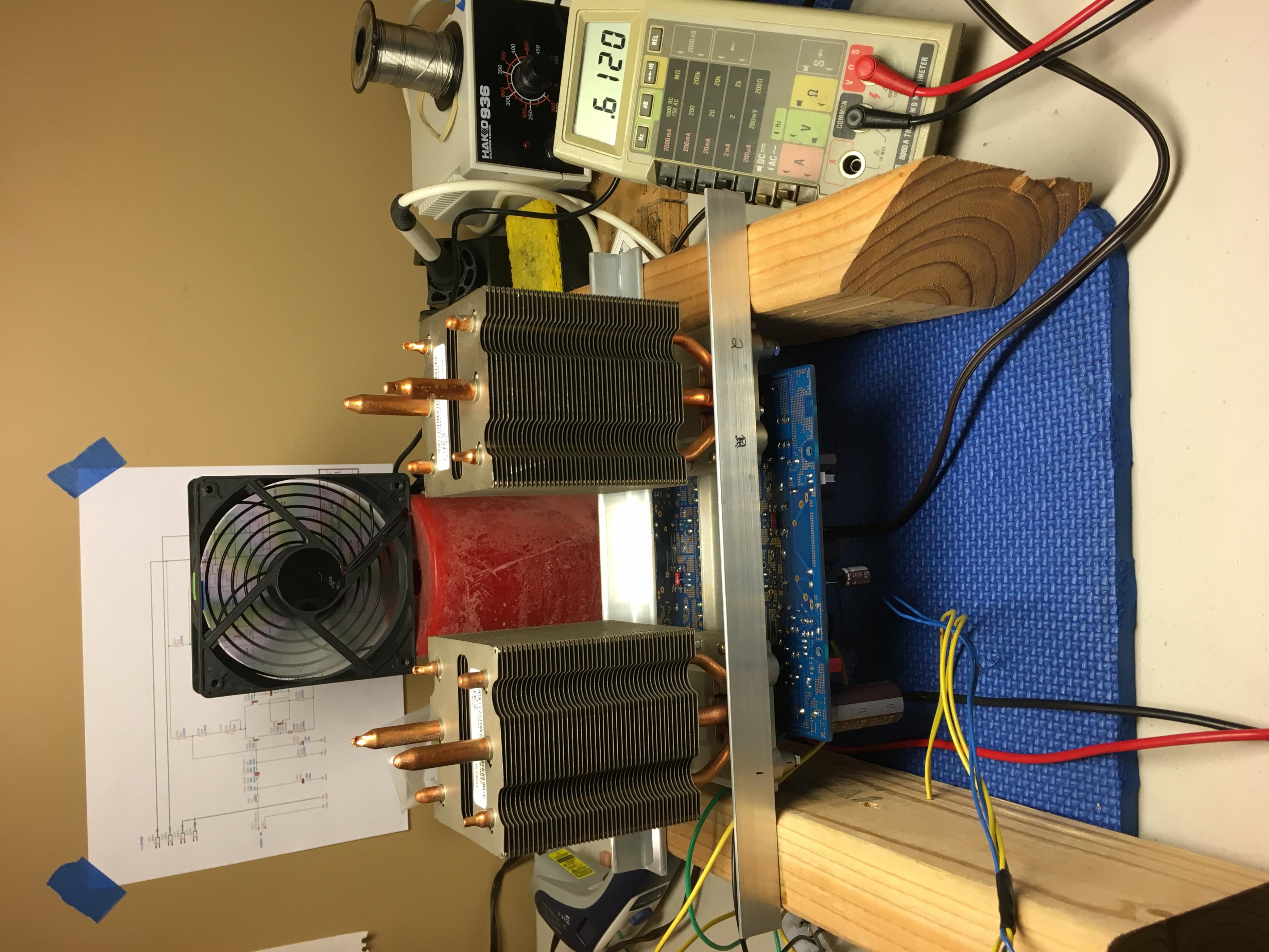

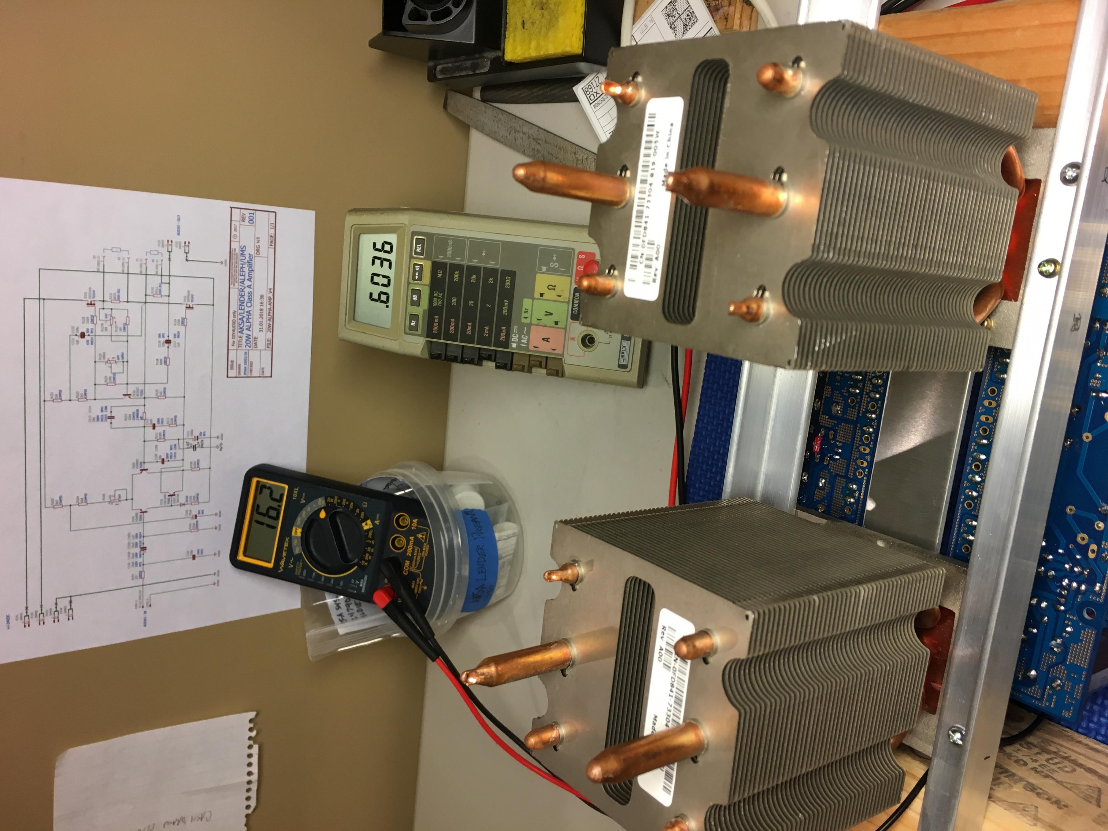

Haha there is no adjustment to make if you did it right! The 0.33R source resistors “sets” the bias. The matched LTP transistors ensures low DC offset and tracking. If DC offset is off, adjust the pot R105. Connect voltmeter across R131 and fire her up. Voltage will take a second to appear and then will be about 0.61v (1.8amps across 0.33R or 1.3amp across 0.47R). Then check DC offset at output. Should be under 20mV and sometimes very close to 0mV if you set R105 at 1050ohm and matched the Hfe of the two KSA992’s. Use a light bulb tester if you have it but this amp is pretty straightforward it should be ok. Of course if voltage across R131 is > 1V for more than 2 seconds immediately turn off and debug.

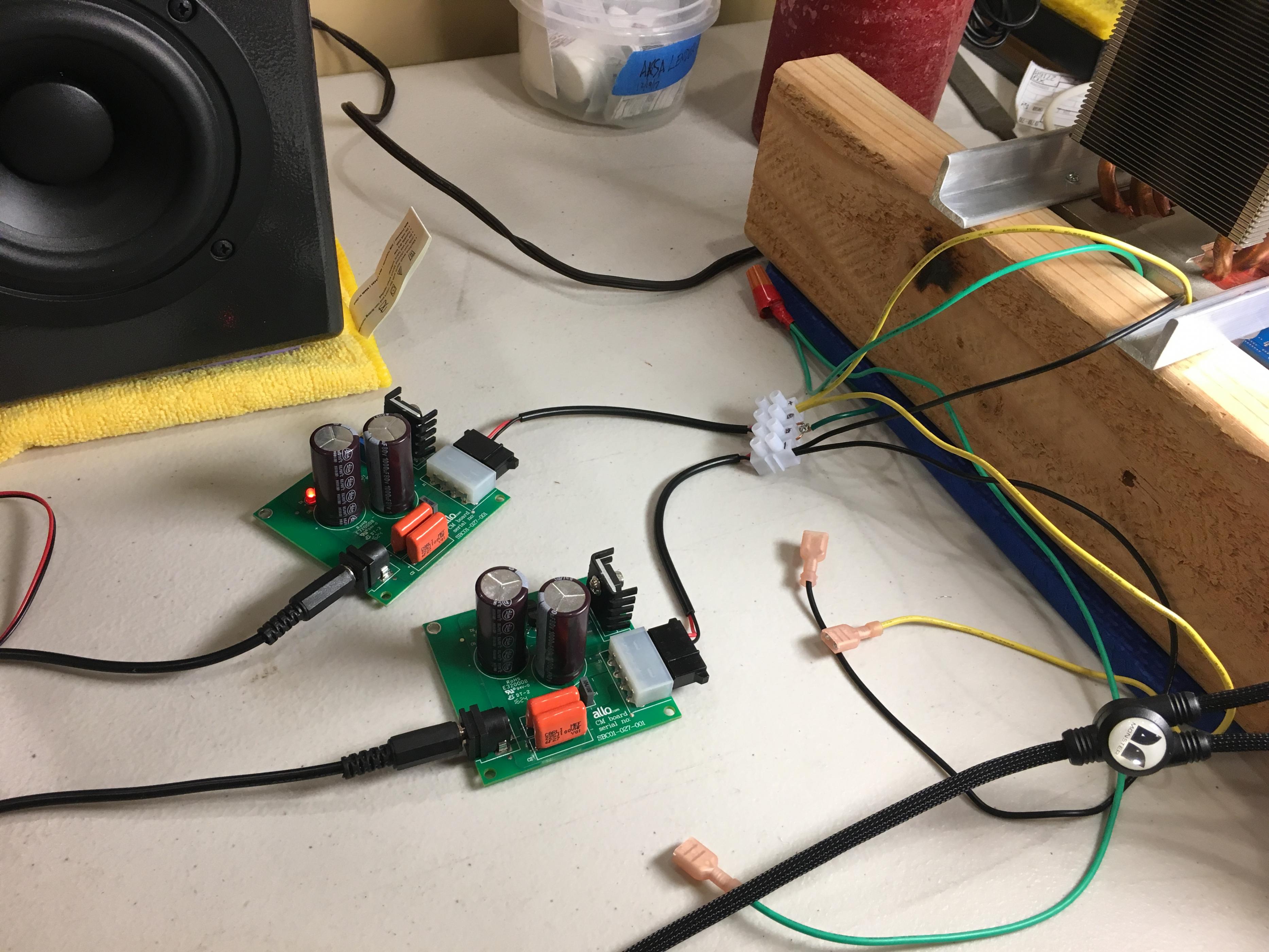

I am fired up!! Mostly great news with a little bit of a puzzling situation.
Both amp boards are working and within spec for dc offset and bias voltage.
Board 1: 17.5mV offset, .604v bias
Board 2: 16.5mV offset, .603v bias
They are silent, no hum, hiss or any artifacts of any kind. Music sounds very good.

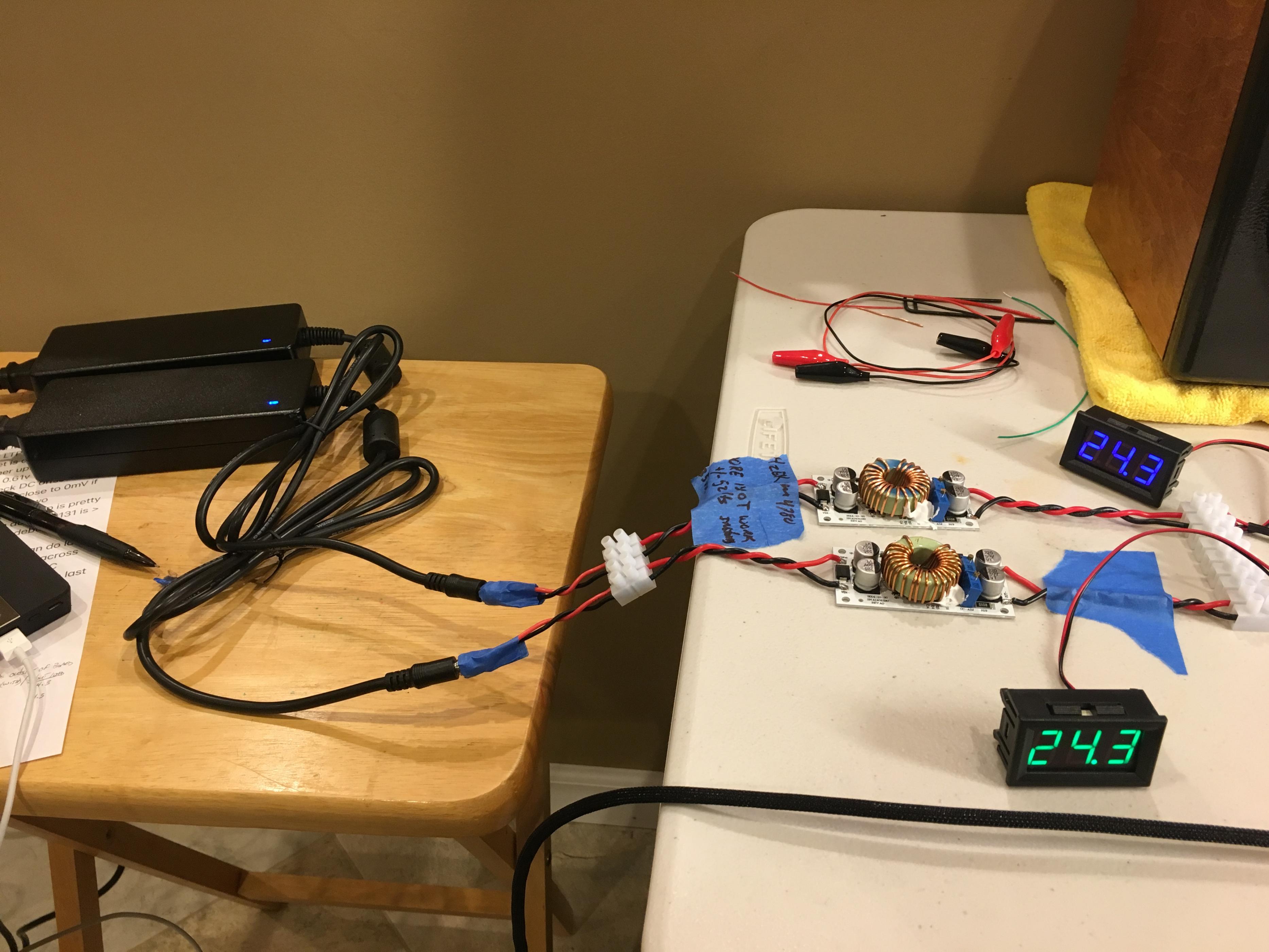

Now comes the puzzling part? When both boards are connected to the power supply, 2 seconds after the power switch is flipped both smps’s shut down.
If only one amp board is connected it works perfectly.
My power supply consists of:
(2) 24v smps->(2) dc voltage boosters->(2) cap Mx
The outputs of the cap Mx are wired in series to get +v/-v/0v before feeding the amp boards.
Any thoughts?

I suspect too much capacitance on the dual SMPS. This is a limitation of this type of power supply and they will often shut down if capacitively overloaded.
Take out the Cap Mx on both, and retest for the two amps. If both smps work fine, then you may have too much capacitance in the Mx. Then you may have a problem reducing the ripple with the missing Mx, and it might just be more viable to use a linear supply, using a 250VA toroid with two 18Vac secondaries and then a Cap Mx.

Sorry forgot pictures in first post
those are very nice heatsinks indeed..any part number / availability on online?

I use this same setup for my MoFo amplifier (albeit just single voltage) with far greater capacitance on the cap Mx output (44,000uF) without ever a problem. That’s why I was surprised they shut down in this application.
I used 16awg wire in the MoFo power supply, this setup has a small section of 24awg wire that exits the capMx. Do you think when both amp boards are connected this section of wire creates to much resistance at turn-on?
