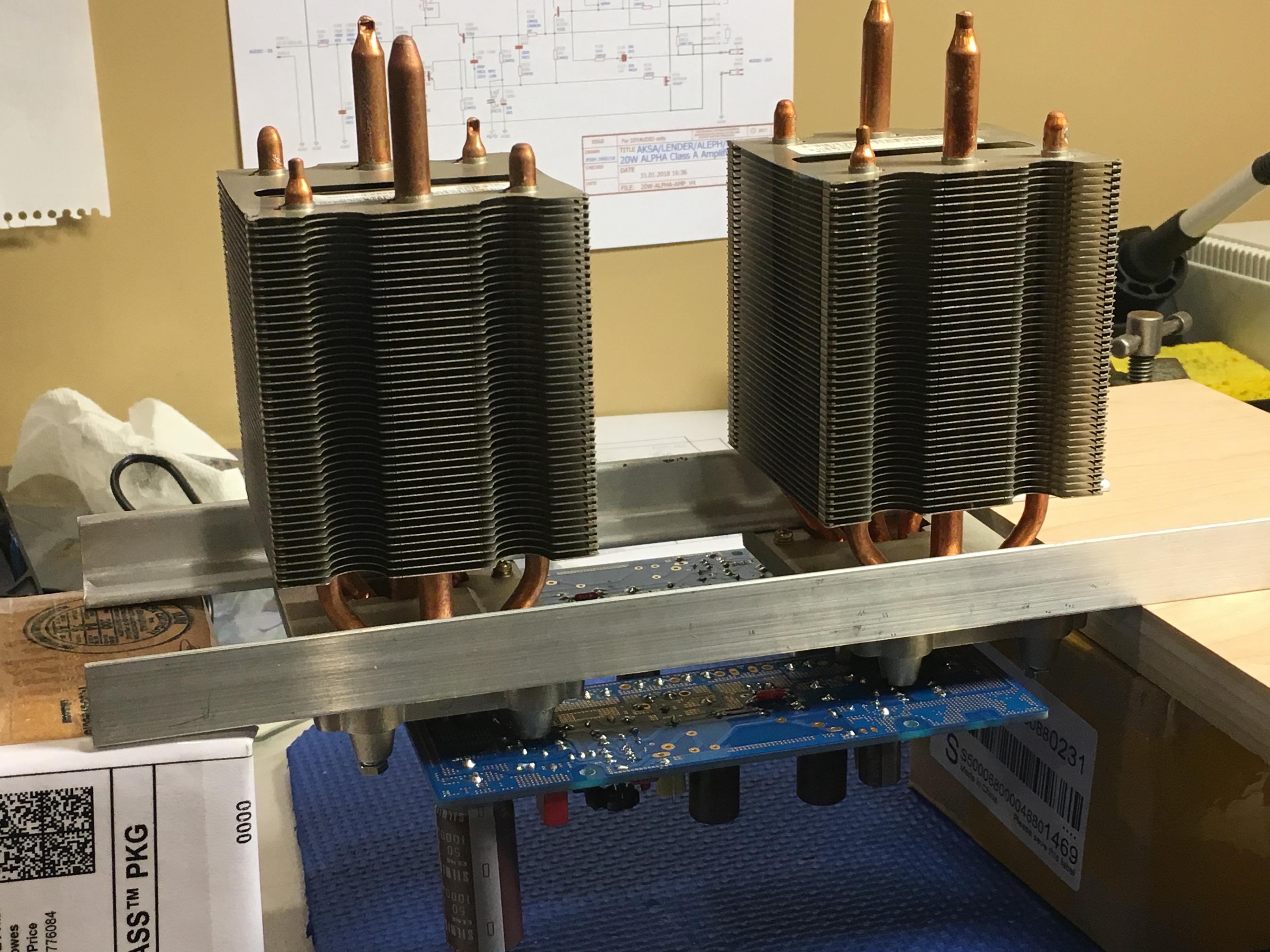

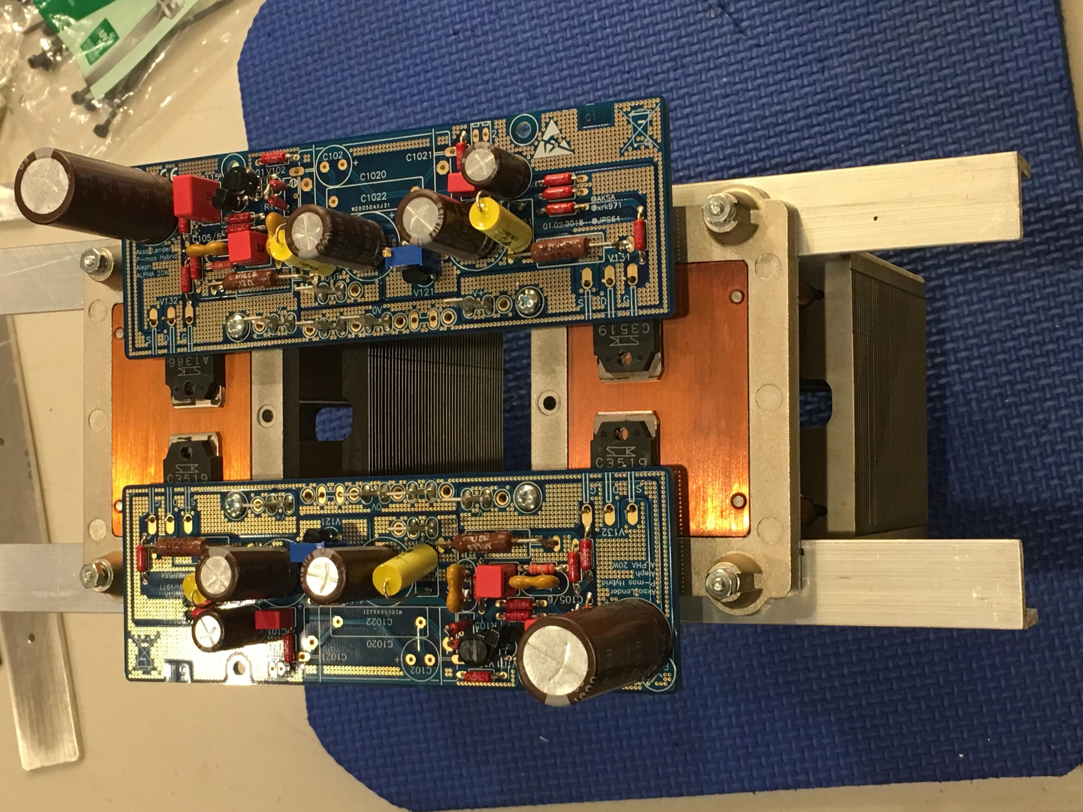

I positioned both boards to use two CPU coolers but the MOSFET’s are not centered on the copper and very close (not touching each other) together. Do you think this scenario would be acceptable?
That’s mighty close and it’s not centered on cpu cooler. I would rotate CPU cooler 90deg and center them and make more room so they don’t touch. That would be bad as the tabs are live. Funny your MOSFETs have exposed tabs. Must be Fairchild? You will need to drill custom holes for mounting the PCB rather than use existing bosses. But it’s not that hard in the soft aluminum frame of the CPU cooler.

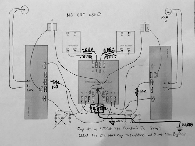

That’s what I did except used two discrete MUR diodes, a 22R 2W resistor, and 1uF film.
I would keep the idea, only I would move the two heatsink closer to each other.
You can drill new holes, just use some lubrication when you drill, I first drill a pilot hole with a thinner drill bit and after go with the size I need. You do not need to use the already existing holes because that would limit the layout very badly.
You can also slide the two PC boards so the mosfets do not touch each other.
I hope you can understan the idea I try to explain.

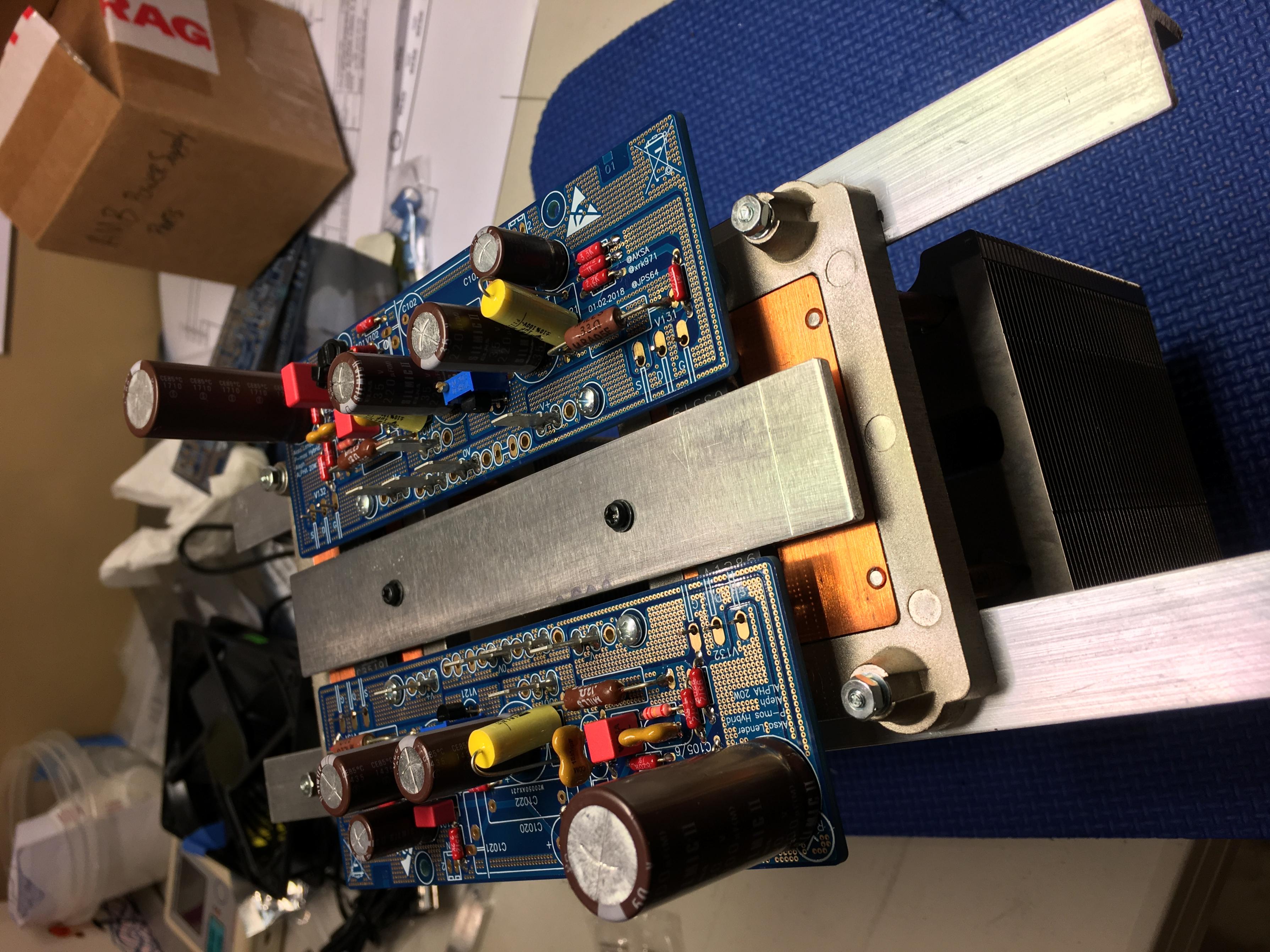

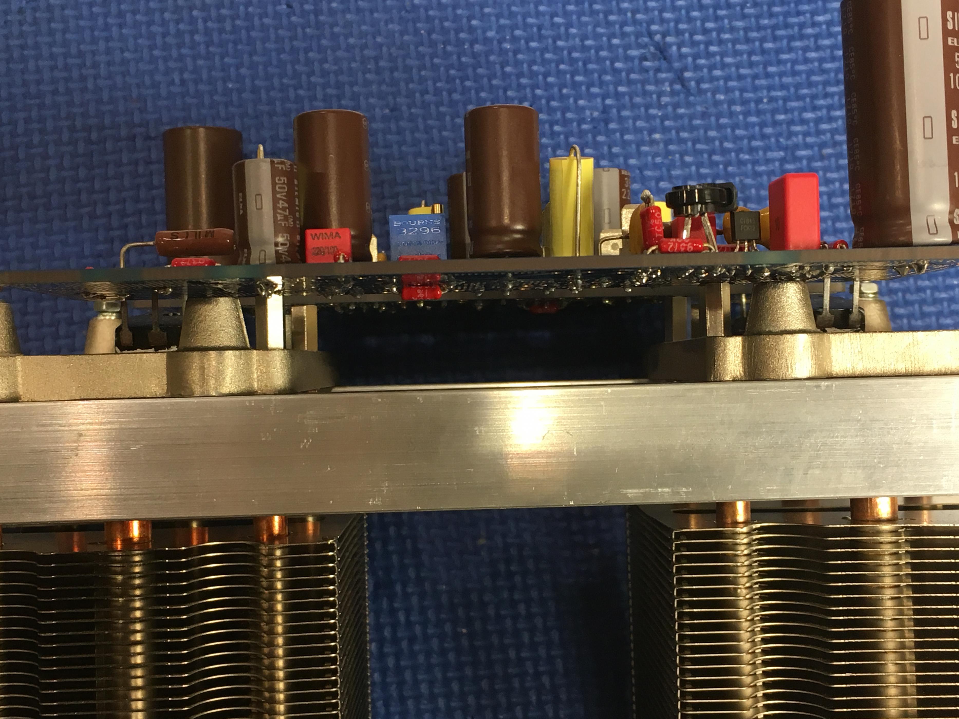

After I thought about the layout and the good input from all of you, I did change the position of the cpu coolers to get the MOSFETs closer to the center and not so close together. I drilled new holes and used 10mm brass stand-offs to mount the ALPHA boards. I do have to cut off the original cpu cooler bosses that are under the boards because they almost touch the soldered components.
I used old transistors to mock up the layout, the new IRFP devices do not have metal tabs sticking out. I used 1” wide aluminum flat bar for the clamp to hold the MOSFETS tight to to coolers. I left extra length of angled aluminum on both sides for mounting purposes and in case I need to attach a fan.
This ‘module’ will be mounted with the coolers on topside and ALPHA boards upside down.
