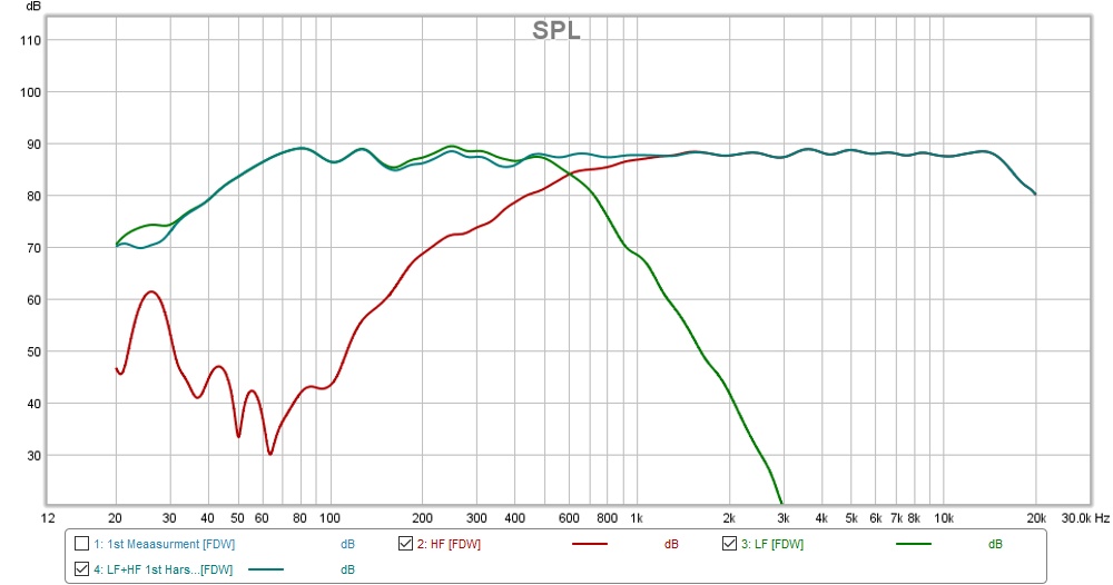

Nice work Jwarch! Aatto is also running Alpha 20 on top with miniDSP in a FAST as well. He even got the Harsch XO going perfectly:
685493d1528418541-10f-8424-rs225-8-fast-ref-monitor-harsch-1st-try-lf-hf-ii-jpg
684637d1527970725-10f-8424-rs225-8-fast-ref-monitor-_dsc6937-jpg
Thanks Vunce and Zman!
I saw that X! Exciting stuff and glad he got the Harsch XO working. I'm going to try my hand at that XO as well. As soon as I get my Visaton's into a u-frame. I just have them playing up into the air behind my Pluvia OB's right now and the coherence isn't very good at all.
Nice work JW!
