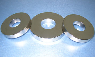

John_E_Janowitz said:
... in your model are you assuming the same size ndFeB+37 as the ceramic 5? If so, this is an extremely expensive piece of neo to start with. There are 2, maybe 3 magnetizers in all of the US that can magnetize a piece of neo this large.
John
John,
In my 2D model, a 0.85" thick (what I measured on my speaker) Ceramic magnet generated 0.18 T in the center of the gap, and a 0.25" thick NdFeB_37 ring generated 0.37 T in the center of the gap. Have you measured the gap flux in a TD15 dipole?
From product pictures, some speaker manufactures use full NdFeB rings, while other use arcs and multiple small circular disks.
For the highest efficiency underhung midrange motor, NdFeB might be worth a prototype test, even with a pre-magnetized ring. If NdFeB saturates the pole steel, a field coil with all of its cost and power supply issues should not yield higher efficiency. Stop global warming with high efficiency NdFeB! :)
"The huge ring type of sintered Rare earth ndfeb magnets magnets
Key Specifications/Special Features:
1.The most large Ring type magnets, such as F88×F30×15 mm, F125×F50×30 mm;
2.The Magnets with high grade material, such as N35SH,N38SH,N40H,N42H;
3.The Magnets be used in the lines of speaker and motor."

We are not set up for large neo motors at the moment. Cost is a primary concern as this is a low production design we are talking about here. This midbass if done needs to use as much as possible that is currently on the shelf, and it will be able to use the planned Alnico and Field Coil motors. We can revisit the neo question in the future once we gear up for it, but it will be awhile as it will be a larger investment than anything else done yet by either Lambda or AE.

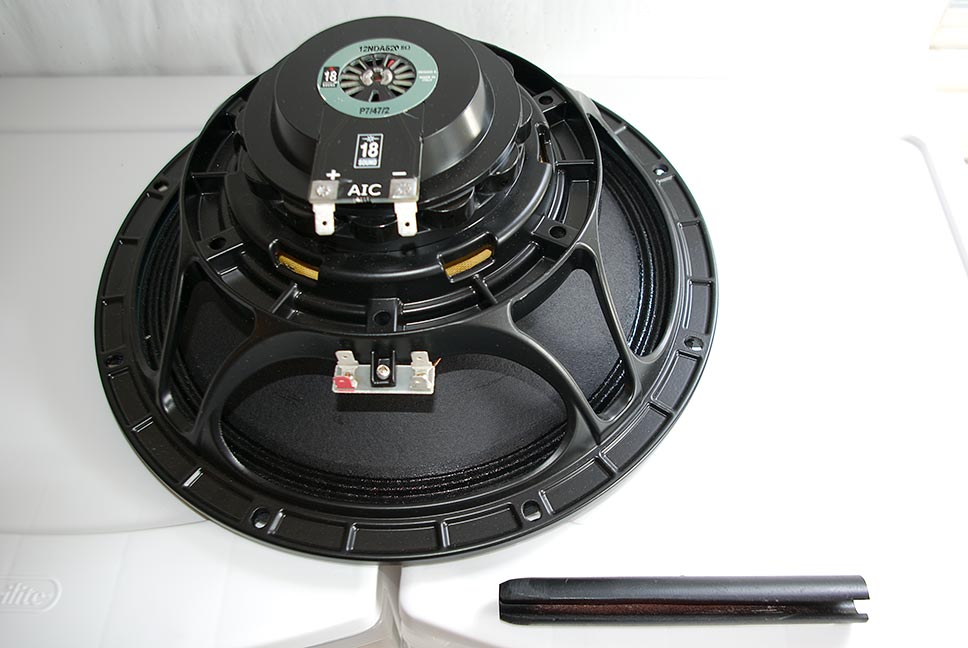

A few things I find interesting in the paper on AIC. Clearly it is a paper written to prove a point and has some bias to it. One thing I see of great interest is the following statement:
"This solution could be further improved in terms of 3rd order distortion reduction using instead of a ring in the gap, a complete sleeve that cover almost completely the pole piece. This solution probably allows for better circulation of eddy currents even at high frequencies where they should tend to concentrate in the upper and lower part of the gap. Incidentally, this add still more complexity to the design and cost more in terms of general efficiency."
That is interesting because the full sleeve on the pole is exactly what we do. They claim it would be better, but yet they don't test against that option. If trying to prove AIC superior in decreasing distortion wouldn't you test against the best possible known option? Secondly, their is no mention as to the thickness of the shorting ring in the gap with that comparison. Quite simply, the thicker the shorting ring, the more effective it is.
They claim in the last section that the shorting ring in the gap had more of a tendency to heat up the pole piece than did the AIC. A full sleeve on the pole would sink even more heat into the pole. This means it is more effective at keeping heat off the coil and lowering power compression, which is a good thing. What confuses me is that they seem to believe pulling heat away from the coil is a bad thing? The first step in dealing with power compression is the immediate need to get heat away from the coil itself.
