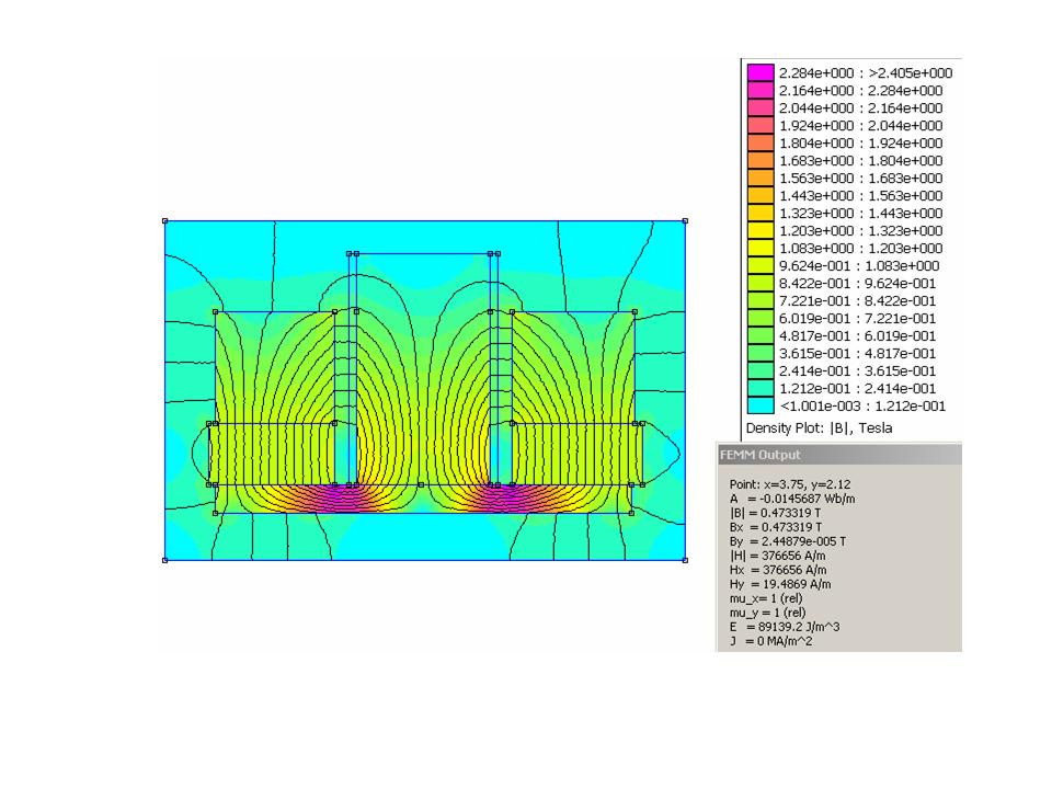

The problem is that underhung motors and high efficiency do not go together. In an underhung motor you use only a portion of the flux in the gap at any time. In the case of the Dipole woofers you use 1/3 of the flux as the coil is 1/3 the length of the gap. The LO series use the same coil but I shrunk the gap from 1.5" to 1.125". Because there is the same overall amount of flux, the density is higher giving more efficiency. This means less Xmax though. Once that happens they cannot play loud enough at low frequencies. There are tradeoffs to everything.
Doing an LO10 is possible but only brings efficiency up to about 89dB 1W. The TD10M is still far more efficient.
As far as the "sound" of the Altec goes, I am not personally interested in recreating that. I go to great lengths to make sure that the woofers I build are free from resonance from surrounds, spiders and cones. The motor design is the biggest contributor though. The linearity of the BL and Le curves are responsible for very low distortion. The woofer should be able to accurately reproduce the signal input with the least coloration possible. This is however not the case with most drivers especially many of the vintage type drivers. If nothing is done to handle eddy currents and the inductance modulation, the distortion skyrockets. If you look through the measurements on the Driver Vault page you can compare the drastic difference in distortion between the TD12M and Altec/GPA 414. The 414 has literally 10x the distortion measured at 150hz at 100dB! From 200hz to 2KHz the 2nd and 3rd harmonic distortions of the 414 are upwards of 10dB higher than the TD12M. This is all attributed to motor design and evident in the Le(x) measurements there. These are things that give the 414 it's sound and not something I would want to put back in.
