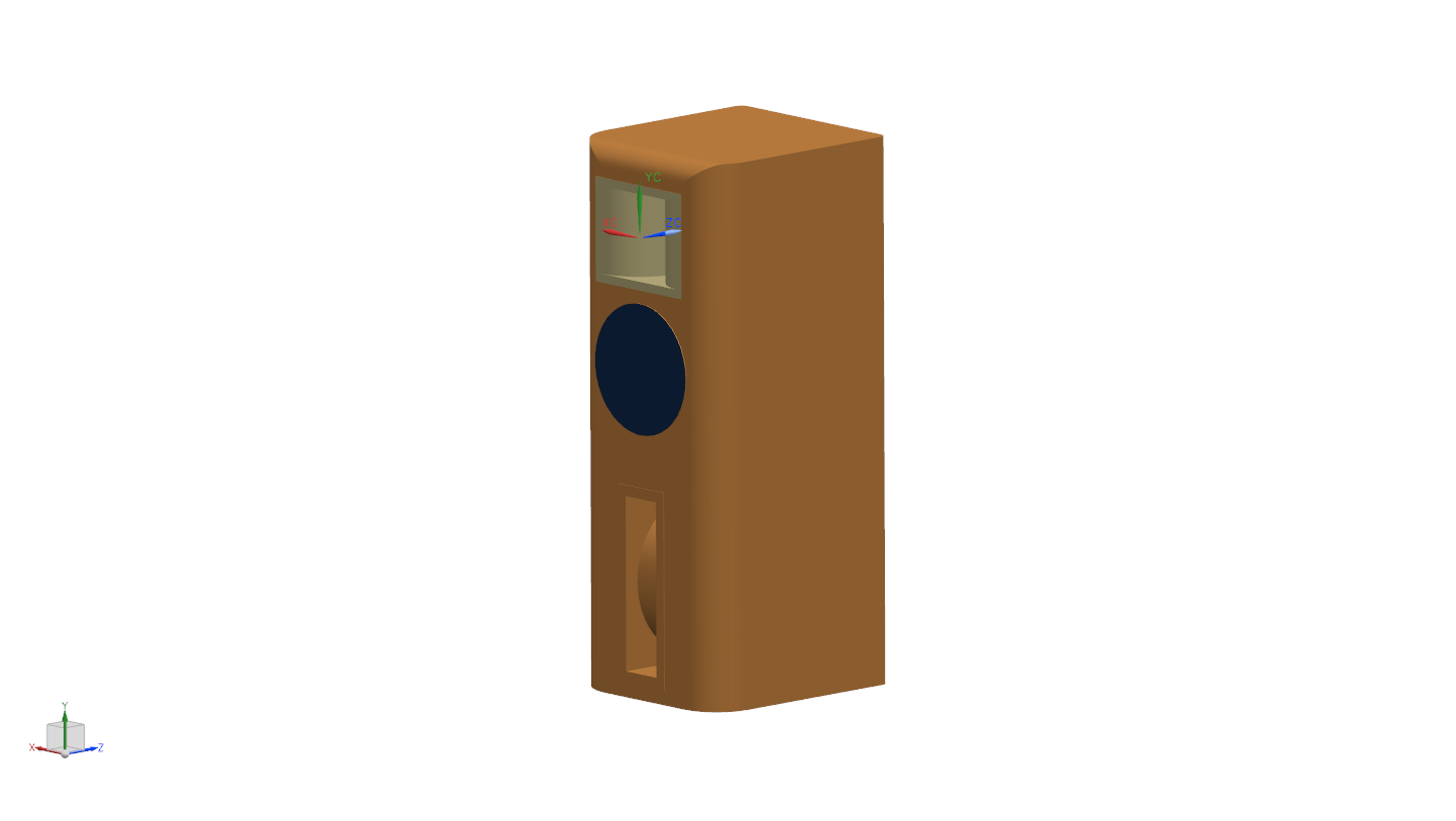

I have attached a couple of CAD rendered images of my throughts.
The first is a PPSL (sealed?) to cover upto 100Hz, where a mid range takes over.
Reckon i could get away with a pair of 15" for this - recommendations for a suitable (Qts=0.31) driver?
The second is just an 18" in a sealed baffle, covering up to 100hz again, (similar to the Daniel Hertz M1?).
Looked at modelling a PPSL in Hornresp, tried modelling to a qtc of 0.7, not sure if this is the right approach or not. (my make a test cabinet for the deltalites to see if PPSL is all its meant to be.
With regard to an 18" sealed driver, i have the offer of a couple of 18 sound 18nd9100, which i think is like the 18w1000, light cone, big BL, at a good price. I know a pair of counter force drivers have been recommended, however i reckon, trading the cabinet resonance against volume and cost, if i can control the resonances then it looks a good compromise. (I am an aerospace engineer). I have looked at the beyma 18" range and cannot find a light coned driver, all seem to be 200grams +.

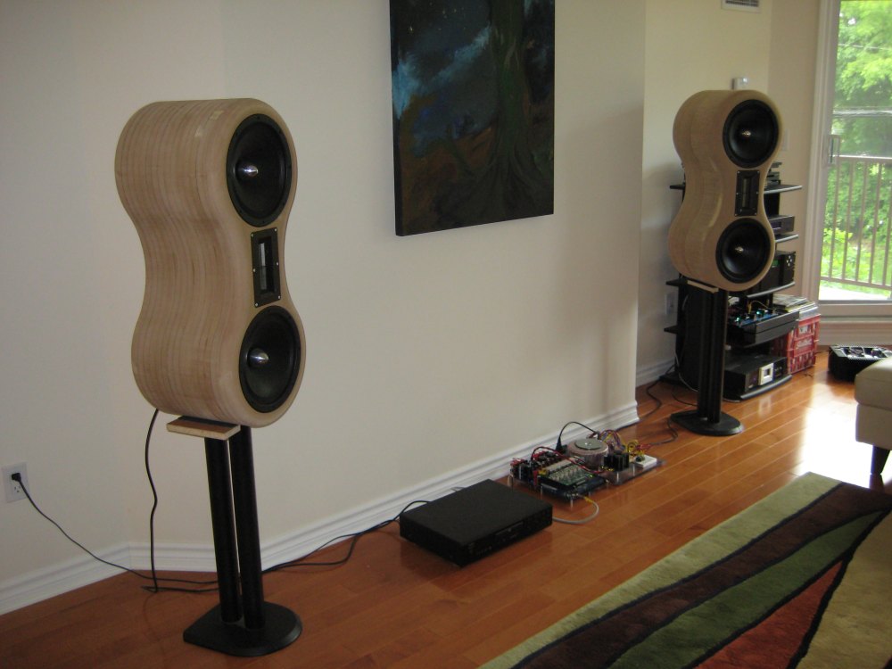

Doug's thread "10" MTM with NeoPro5i Ribbon - Build Thread" is a good reminder of dispersion and lobing limitations in an MTM when the M-M center-to-center spacing is greater than half the crossover frequency wavelength. Doug's summary:
"1. Unacceptable vertical response caused by the MTM arrangement of the TD10M drivers.
The drivers ended up being spaced about 18” apart C-C to make room for the NeoPro5i in between. That 18” spacing corresponds to a wavelength of 750Hz which means the first serious null would be around 1500Hz. If you take a look at the vertical response of the two TD10M drivers in their MTM arrangement, you’ll see the severity of the problem. At just 15 degrees off axis, there’s a 20dB dip at 1500Hz which is completely unacceptable. Things only get worse from there, with a plethora of peaks and nulls as you move farther off axis."

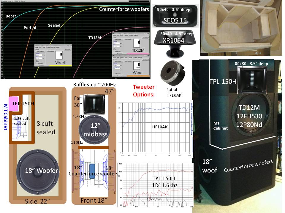

The latest TPL-150H designs in diyAudio are TMW, or TM-WW for higher efficiency bass. The debate continues on the best T-M crossover frequency between 1600Hz and 2000Hz, and this will decide the midrange size which can match the 80-degree TPL-150H horn at the crossover frequency. A custom built TPL horn with 60H x 30V has been used to provide a better polar match from the narrower sound stage to select 12" midbass at-and-above 1600Hz.

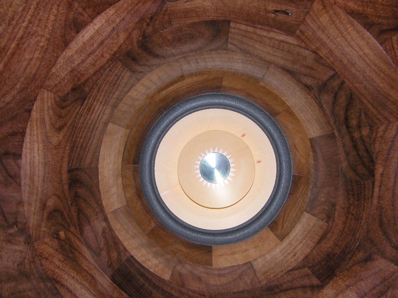

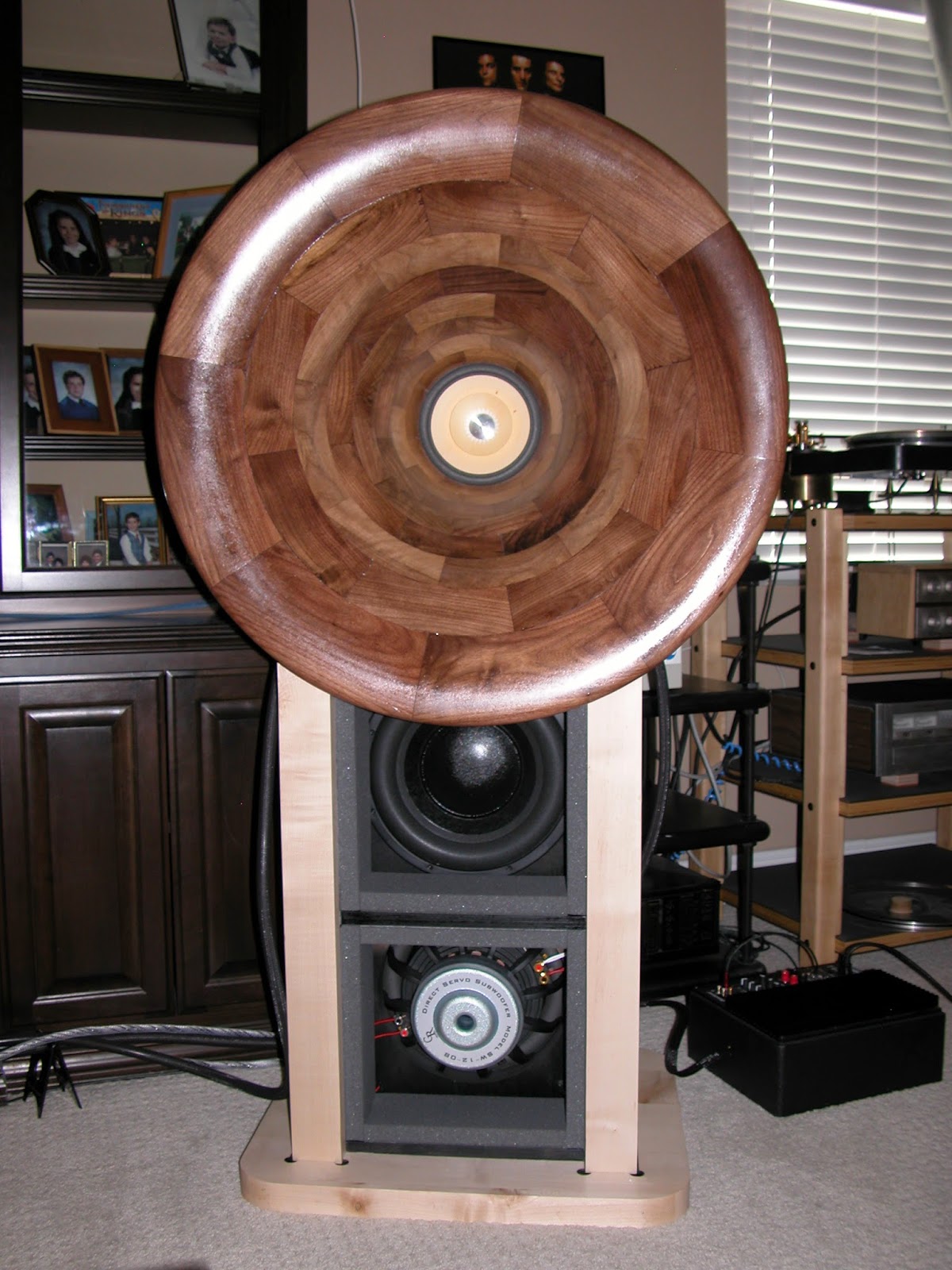

Are those Sierra-Brooks horns ? They certainly are beautiful, just like the S-B
models of years past, were.
I can't ever remember seeing a model with a large throat for a cone driver.
Does that driver (which is it?) cover all the way up to give you enough highs ?
Also, it looks like you have Danny Richie's servo di-pole beneath !
Mr. Lewinsky, if you are also reading this, have you pondered on a large round horn like this, for mid range ?

Of course I am, Scott! :)
Those are pretty. I'm guessing I would have a tough time selling them to my wife, though.
I know close to nothing about horns, but wouldn't it be a challenge in terms of center-to-center distance between a horn like than and a TPL?

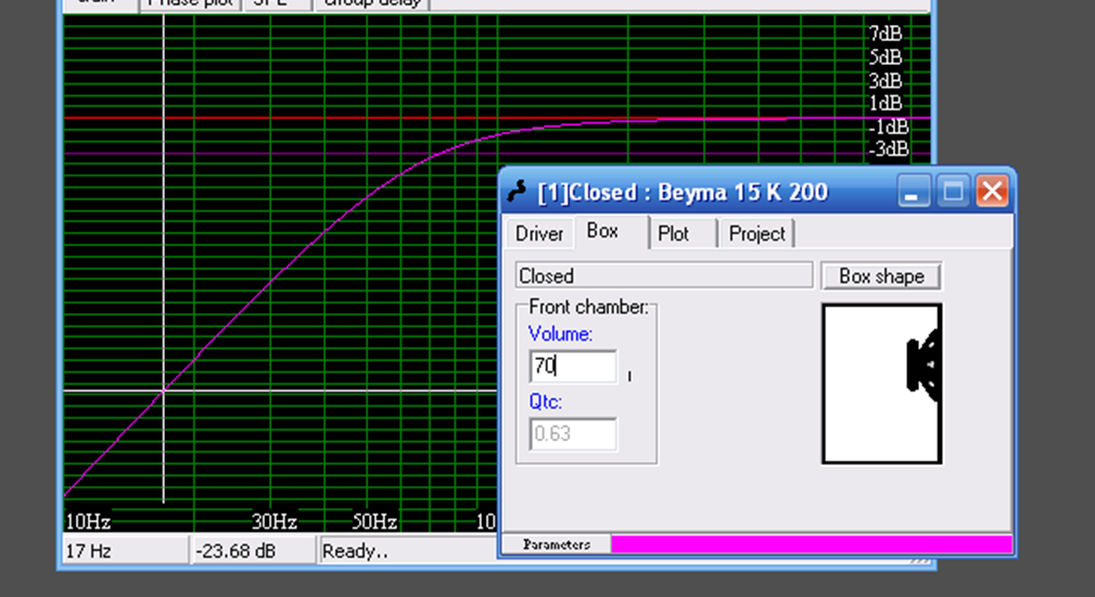

Its not the size of the cabinets but the cone area being OTT. I sort of feel that a WW using a couple of 15" drivers will be adequate based on my recent experience. A 15" driver that people seem to like tonally is the beyma sm115K. Simmed it up in the counterforce arrangement, needs the same size box as the Faital 18" due to its lower Q, but should give a similar response with equalisation (need more watts but i have 250W available so should not be an issue.)
See attached my sim for the sm115k in a 70 ltr box. Do i want the qtc =0.71 if i am going to boost the bottom end? if so box is only 50ltrs. I assume i am modelling it correct, assuming i need the box twice as big for 2 drivers opposing each other.

You are correct.... A 15" woofer is a better solution than an 18" woofer at the 250 - 350Hz crossover to a JMLC midrange horn.
I have used twenty Lambda TD15S woofers in both ported and sealed alignments and understand the joys of fast-transient bass.
Large Sd 18" woofers are the best solution for 80-160Hz crossovers to a speaker midbass like the 12P80Nd.v2 used with a TPL-150H. Textbooks call it "matching the bass wavefront launch"
