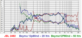

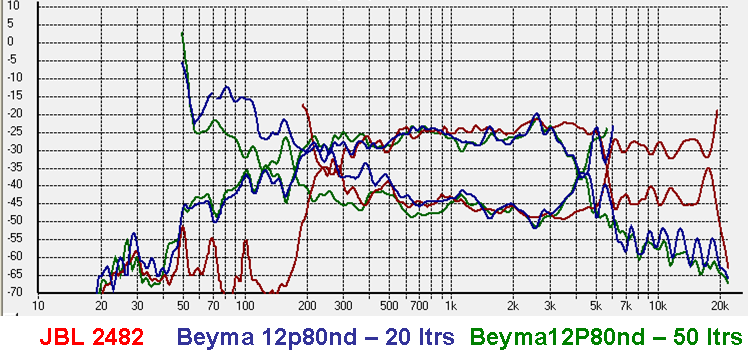

There was some suggestion, in a coupe of posts back, that the 12" IB would have a lower distortion than the JBL 2482, so i thought i would measure it.
Hopefully the trace is self explainatory.
It looks as if the distortion is worse from around 400 hz down, between the IB and the CD driver.
The suprise to me is the effect of cabinet size on the distortion, changing from a 20 ltr to a 50 ltr cabinet, has quite a difference at the lower end of the freq response. Maybe its not really a suprise?

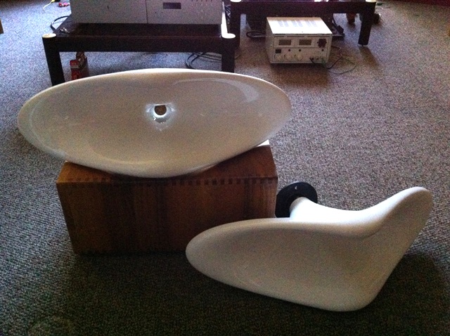

My wife likes the E-JMLC Mick Jagger Lips horns.
