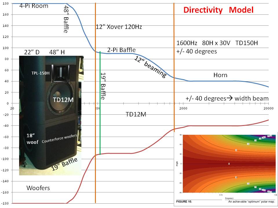

I always thought that the deeper cone of a 12incher had a narrower dispersion and was matching that of TPL-150h at the typical Xo point much better than an 8 incher. that also seemed to be a consensus in the other thread(s) discussing the same combo.
Around the common crossover frequency range of 1600-2200Hz, the TPL-150H horn produces an 80 degree horizontal polar pattern and a 30 degree vertical polar pattern. A well designed 1600Hz Xover is considered by many as the lowest "good sounding" TPL-150H point. A well designed 2000Hz Xover is considered by many as the lowest "great sounding, no strain" TPL-150H point.
A FEW 12" midbass speakers beam into an 80 degree polar pattern around 1600Hz, and these drivers can produce a "smooth" polar function when properly crossed to the TPL-150H on a clever low diffraction baffle. SOME of these 12" midbass speakers have T/S parameters which support ~100Hz F3 bass in a tight transient sealed box. Add some high efficiency woofers and you have an excellent 3-way speaker.
A FEW 8" midbass speakers beam into an 80 degree polar pattern around 2000Hz, and these drivers can produce a "smooth" polar function when properly crossed to the TPL-150H on a clever low diffraction baffle. MOST of these 8" midbass speakers have T/S parameters which support ~250-300Hz F3 bass in a tight transient sealed box. Add some high efficiency woofers and you have a "good modest low-bass" 3-way speaker, but also add a subwoofer and you have an "exellent 20-20Khz" 4-way speaker.

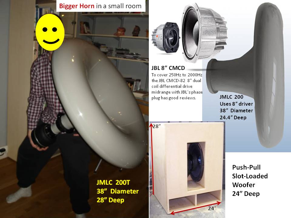

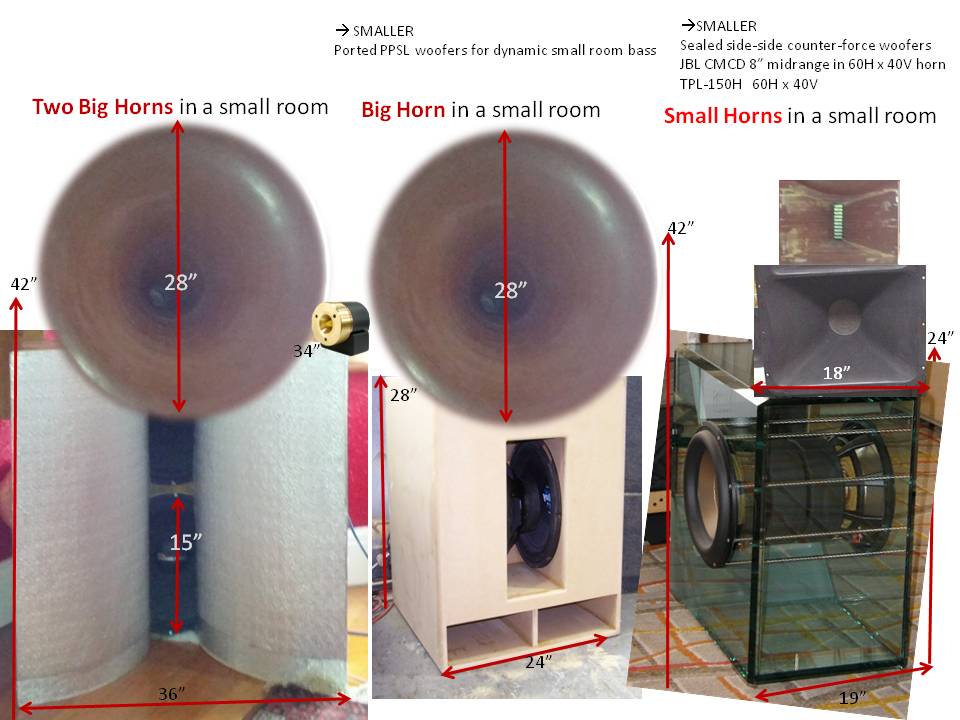

Small Room Woofer Thoughts:
---If you always plan to use a large midrange horn(28" to 30" JMLC), then push-pull slot loaded ported woofers is the best tech for a small room.
---If you plan to move to smaller midrange horns(JBL 8" CMCD in 19" PT horn) or a BMF-1 type 3-way with the TPL-150H tweeter, then equalized Side-Side counter-force sealed box woofers is the best tech for a small room.

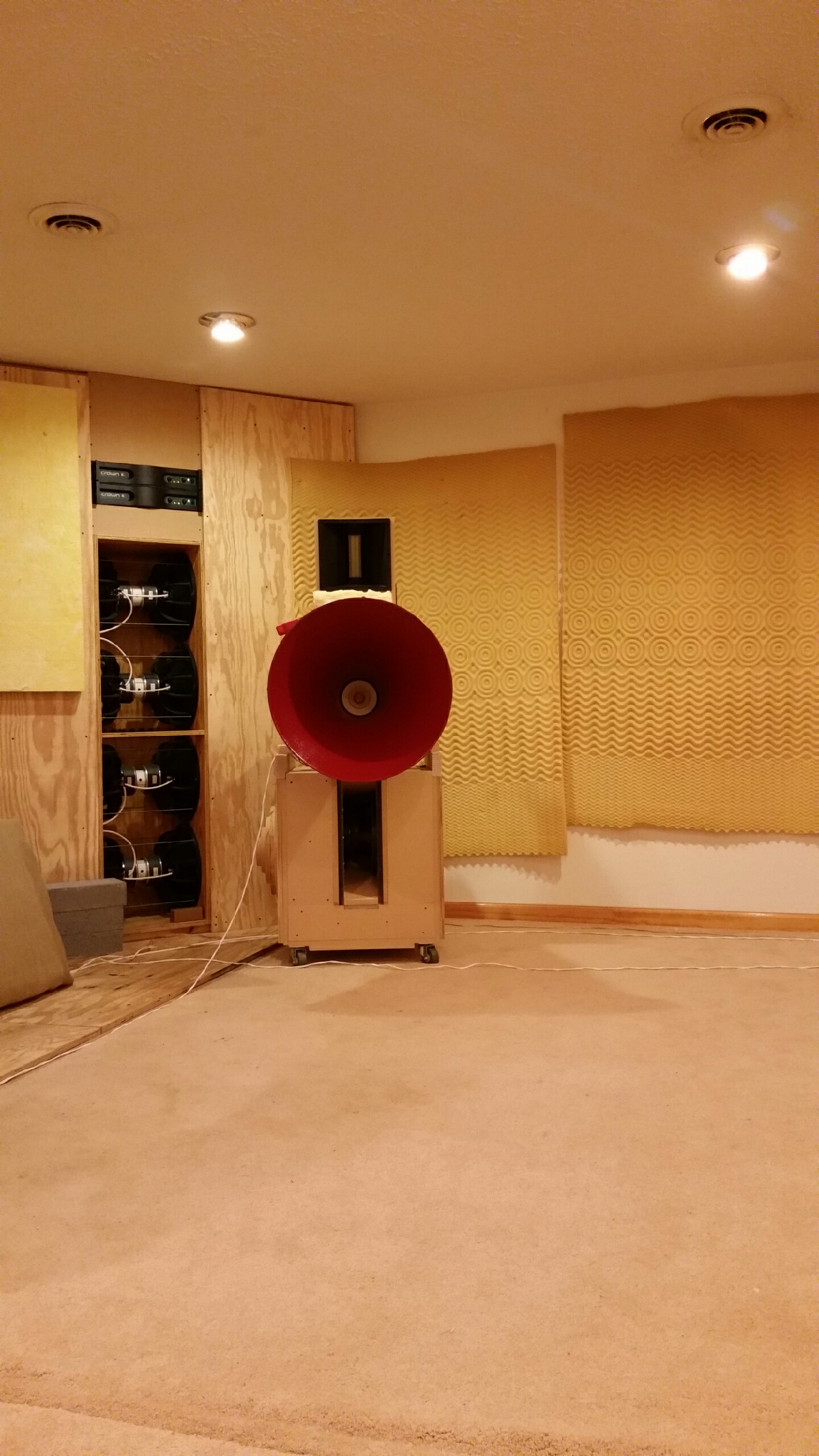

vinylnvalves: "My room is only 16 ft x 13 ft x 8ft 6."
You have a small room. Your speakers are very close to 2 walls.
Disappointing past systems:
1) 28" JMLC midhorn + Onken woofer + TPL-150H tweeter
2) 28" JMLC midhorn + 414Z MLTL@35Hz + TPL-150H tweeter
3) 28" JMLC midhorn + Dual 15" horn_dipole woofers + TPL-150H tweeter

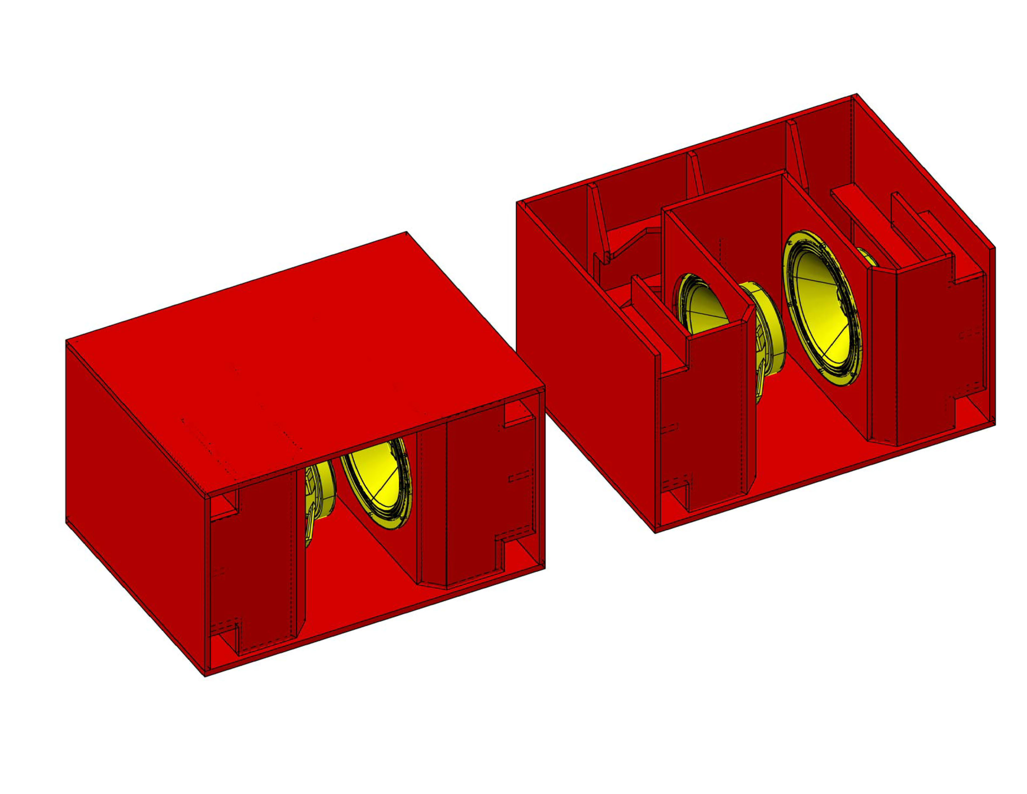

Remaining good woofer ideas....
4) Push-pull, front slot-loaded, ported woofers.
++Slot generates Good Dynamics
++Performs well with passive Xover. Direct connect Tube amp friendly.
---Larger than two sealed woofs.
5) Side-Side counter-force sealed woofers.
---Active Equalization required.
++good SPL/box_volume with active equalization.
++Allows flexible Qtc and complex DSP room equalization
++High Efficiency. Tube amp after equalizer.

Looks as if the counter force sealed woofer's have the most going for them. I have simmed the faitals and all pair of beyma sm115k's little more natural extension from the 18" as they have a higher qts. You haven't mentioned a ppsl sealed arrangement, could the bottom end be argumented with a dsp? Would this not be the best of option 4 and 5?

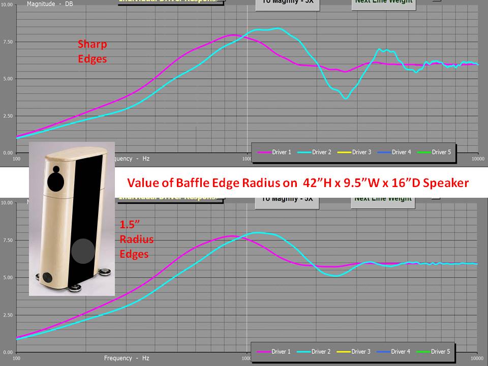

low diffraction baffle ?
Please,
What exactly do you mean by a "low diffraction baffle ?
A FEW 8" midbass speakers beam into an 80 degree polar pattern around 2000Hz, and these drivers can produce a "smooth" polar function when properly crossed to the TPL-150H on a clever low diffraction baffle. MOST of these 8" midbass speakers have T/S parameters which support ~250-300Hz F3 bass in a tight transient sealed box. Add some high efficiency woofers and you have a "good modest low-bass" 3-way speaker, but also add a subwoofer and you have an "excellent 20-20Khz" 4-way speaker.
Please,
Your speakers require a woofer that covers 20Hz - 250Hz, and blends well with a big midrange horn, in a small room, when placed near two walls.
Push-Pull slot-loaded woofers generate a high impact bass wave launch with a focused air pressure energy that travels several feet before diffusing. In a small room the slot is aimed at the listener in an effort to increase the perceived dynamic impact. A very good match for a horn midrange. At low SPL levels, the slot's focused energy wave is linear over the operating frequency range. At high SPL levels, the high air pressures between the two drivers in the narrow slot can affect the perceived T/S parameters and create a non-linear response.
With sealed woofers, one narrow single push-pull slot must deliver high-equalized low(20-50Hz) bass in addition to voice-critical 150-250Hz. Slot loaded 20-250Hz (with high efficiency+bandwidth woofers) creates baddd audio JuJu. A narrow slot is required to avoid resonances anywhere near 250Hz, BUT a wide slot is required to avoid T/S parameter shifts from high air pressure 20-50Hz low bass. Baddd audio JuJu.
--The low bass air pressure in the narrow slot affects the (high efficiency+bandwidth) sealed woofer's perceived T/S parmeters, and this modulates the ear sensitive midbass.
--The low bass air pressure in the narrow slot competes with high-impact percussion impulses.
--Increasing the slot volume to accomodate the low bass pressures starts to reduce the directional high-impact percussion impulses.
Moving the low bass energy out of the shared narrow slot into ports is my JuJu charm.

You have just described my operating system
(view of the left channel; I sit 13 feet away.

I would like to understand what a low diffraction baffle is as well.

As early as 1951 researchers like Harry Olson published experimental measurements on cabinet shape vs. diffraction, so there is a great deal of tech literature on the topic.
In the Big Horn world, the LeCleach large radius mouth provides low diffraction. There is now an extended Tractrix that includes a large radius mouth roll-over.
I use a 1.5" radius round-over bit with my router table for narrow box edges, and use a friend's cabinet shop shaper for 3" - 4" radius for wide box edges.
Today's better speakers:
--Drivers get flush counter-sink into the baffle. All
--Cabinet edges get round-overs with a radius of 1.5" or greater. Gary Dahl 6" radius Altec Midbass
--Sliding-angle chamfer edge cuts used to spread diffraction and control polar response. Avalon
--Sphere + tapered tube = low diffraction and reduced resonances. B&W
--Tweeter location offset on baffle to spread diffraction over wider frequency range. Many
--Large mouth radius horns. LeCleach
I would expect 15" Deltalites will make a large difference in clean bass output. I am very interrested in your listening impressions. Have you sim'ed a sealed back design with your bass horns? They are so close to walls that dipole cancellation may not form.
PPSL.... A sealed subwoofer pair up to 80Hz should work well if you select ROBUST subwoofer drivers. Expect "modest" efficiency. A quick sim of the required slot volume also seems necessary. One alternative is to put two single subwoofers around your walls to reduce room bass modes at the listening area.
PPSL.... I do not have any knowledge to help with a 350Hz PPSL design.
Scott - any further info on your PPSL bass, it looks like you would be crossing around 200Hz with that horn. The big question is this about the limit for PPSL's? Quickly looking around the PPSL thread - i don't think even with a clever plenum chamber i will get a response upto 350Hz.
Starting to think that it is going to be a sealed EQ sub and a sealed mid, thats the safe bet
Won't be trying the deltalites in the OB horns as they are so physically different to the existing drivers i would have to build a whole new back frame, shame.

To answer the first question, I cross at 250Hz, 18db/oct.
As to the frequency performance of these ppsl's I have also wondered that, for a long time. Today, I measured. Using Stereophile's TEST CD#2, tracks 16 & 17. These are 1/3 octave warble tones.
These are the results, using a Radio Shack SPL meter, and adding in any corrrections IF more than .5 db
BASS DECADE; 200-97, 160-104, 125-105, 100-105, 80-102.5, 63-100.5,
50-96.5, 40-94, 31.5-89, 25-88, 20-84
MIDRANGE DECADE; 250-97, 315-101.5, 400-102, 500-99, 630-95, 800-92,
1.0K-93, 1.25K-91.5, 1.6K-88, 2.0K-91
I placed the SPL meter about 1 inch away from the slot. Sorry, but I don't have an exact power level, but guessing around 1 watt. I was surprised the response went as high as it did. This test was without any active crossover, straight into the power amp. I guess I have a "suck-out" in the 200-250Hz area.
Here's my personal take on this ppsl unit. It's strengths are in the dynamic impact area; the bass "hits" are very quick and tight; effortless, if you will.
On the Sheffield Drum and Track disc, Jim Keltner's Drum solo is mighty impressive, and when there's quick double bass hits, I can hear each as distinct notes, whereas on other systems they sound like mud. However, on other conventional front firing direct radiators, I hear an immediacy quality that I just don't seem to have. It might be the "suck-out" (?) My overall general feelings are this type of unit is best served for the lower frequencies, even though the response does not seem very restricted up until about 500Hz, and even then, it's a shallow roll-off above. My future plans are to restrict the range to under about 150Hz, and use a direct radiator to meet a new mid range system, as I am deleting the big red horns to allow for a greater number of listeners to enjoy the music.
Other builders may have different results that what I have discovered. The drivers are Eminence Definimax 4012HO. The slot is truncated towards the rear, ending in a 4 inch plate, loaded with acoustic. The parallel slot walls are
five inches wide.
five inches wide.
Have you considered that maybe a pair of 8", maybe 10" in am MTM might match directivity of the TPL at a sub 2000Hz crossover? They should then match a 180 degree bass presentation a couple of octaves below if you size the baffle appropriately. (and radius it).considering a sealed mid range driver to replace the midrange and midbass horns, allowing me to drop one way out my rig.
A pretty good idea. I've often wondered the same, using something like this,
above and below the TPL:
http://www.faitalpro.com/products/files/10PR300/8/10PR300_datasheet_8.pdf
