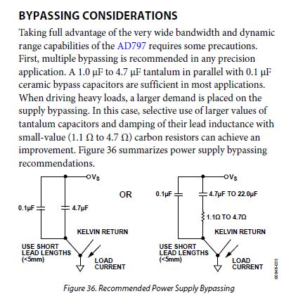

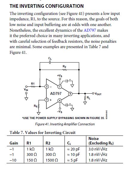

AD797 Bypassing and Inverting Configuration
I presume I should add bypassing caps for Vs of the AD797 (see attached). The datasheet also provides guidance in the section regarding "The Inverting Configuration" which suggests keeping the feedback resistors low and adding a small capacitor across the 'uppermost' feedback resistor. Am I right to add these components to this application?
Virtually every amplifier needs decoupling and many show very significant deterioration in performance if the decoupling is poorly implemented.

Decoupling of the power pins of fast opamps is mandatory where the manufacturer mentions it in the datasheet.
Be careful with Cl it can make stability worse.
Have you read Leach's Lo Tim?
He got it wrong and is humble enough to take you through the story of how to do it properly, although a lot of the detail has been omitted.
Thanks. Yes, large CL is a no-go but a cap of the size proposed here (10-20pF) should be fine I think. It doesn't change phase margin materially at all.

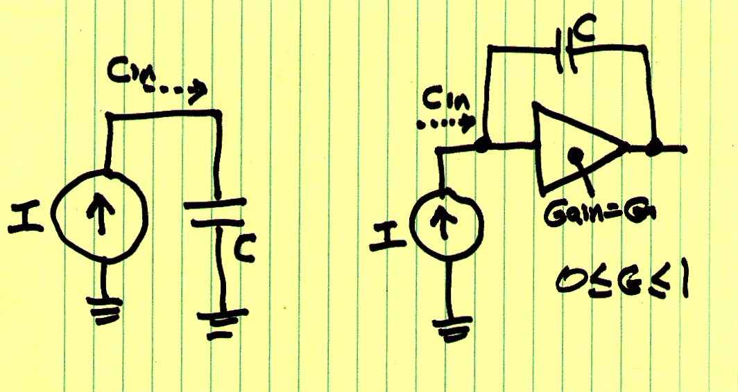

Whoops, you forgot that when viewed from the gate, the MOSFET is acting as a source follower, an amplifier whose gain from input (gate) to output (source) equals +G, a little less than +1.0. The gate-to-source capacitance Ciss is *bootstrapped* by this amplifier and so its effect upon input capacitance is reduced. (Cgd and Cgb are not bootstrapped.)So Rgate forms a low pass filter with MOSFET's input capacitance of 10nF. The pole of this filter is given by:
f-3db = 1/(2 x Pi x CISS x Rgate)
The standard analysis procedure is shown in the attached diagram. You squirt a small signal test current into the input and measure the ratio (v/i) which equals input impedance. Comparing the input impedance of the left circuit versus the input impedance of the right circuit, you can calculate the ratio and obtain an effective input capacitance. It varies as the amplifier gain, G. {the circuit on the left is in fact the degenerate case G=0.0000}
Of course the exact same bootstrapping phenomenon occurs in the BJT emitter follower version of a series pass regulator, too.

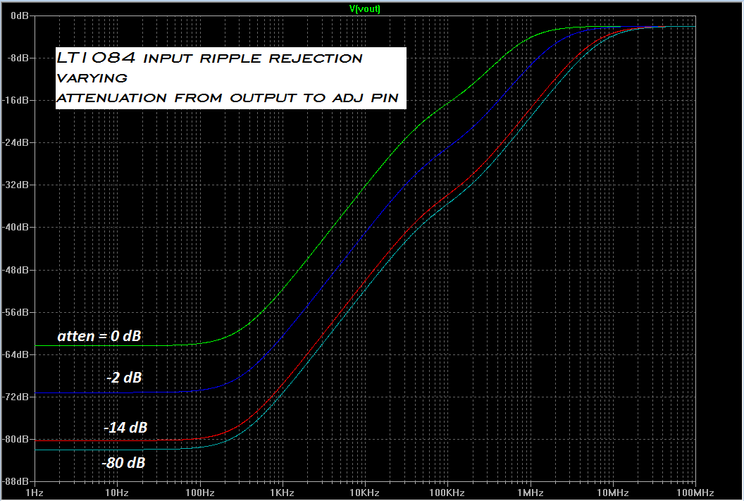

Perhaps it is about time to decide how much input ripple attenuation is good enough.
If you use an IC preregulator (post #84) it will give at least 60dB of attenuation at 100Hz. If you install series resistors between your smoothing caps, that will give another ~3dB of input ripple attenuation at 100Hz.
If your opamp + series pass transistor circuit gives another 63dB of attenuation at 100Hz, that's a total of 126dB. 0.5 parts per million. How much ripple attenuation is good enough?
And if you heavily bypass the ADJ pin, it seems to give 81dB of attenuation at 100Hz in simulation (12V, 5A).If you use an IC preregulator it will give at least 60dB of attenuation at 100Hz ...
Now you only need 45dB attenuation in the opamp + series pass xitor, to get 126dB total.
Or I suppose you could simply put two of these IC regulators in series and get 162dB of attenuation at 100Hz. That's 8 parts per billion.

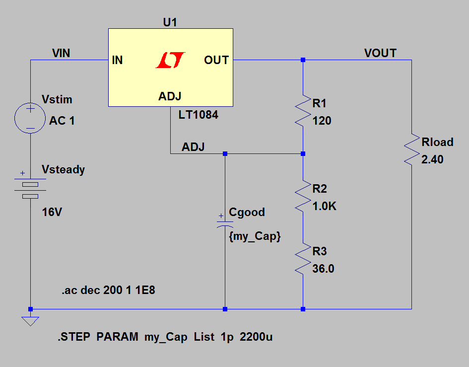

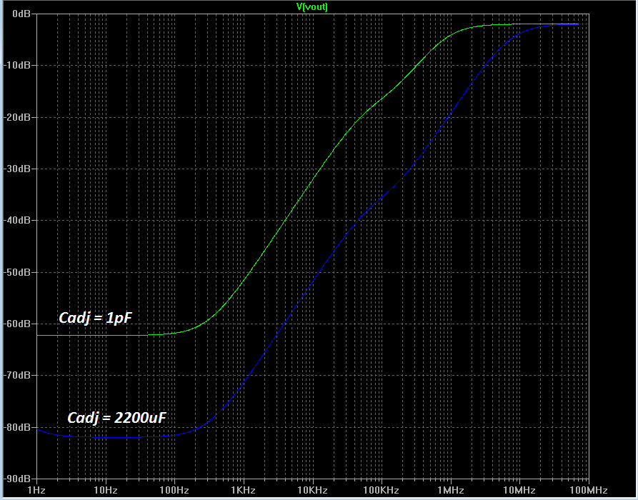

Mark,
looking at the lt1084 sch, could R2 be replaced with a string of red LEDs? Keeping R3 to trim the exact output voltage.
How much would that improve regulation and noise and hum?
How close to the 2m2F performance could we get by swapping out R2 and using a much smaller capacitor?

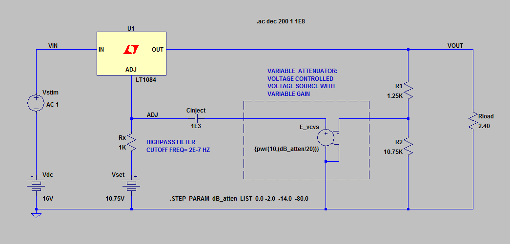

Anything you do to attenuate the AC signal ("ripple") from the LT1084's output pin, to the ADJ pin, will help. Of course the benefits don't go on forever; simulations suggest that there's very little to be gained by attenuating more than -20 dB or so. According to LinearTechnology's spicemodel anyway. LTSPICE results are presented below; notice the tiny improvement when we go from -14dB attenuation, to -80dB attenuation.
Remember that the final circuit will include input-short-protection diodes which give a ripple injection pathway from IN to ADJ. Thus the lower the impedance at ADJ, the less ripple will be injected here. Running a DC bias of 10mA (1.25V / 120 ohms) seemed a reasonable way to get a headstart on rejecting this injection. It also reduces the voltage error that results from the ADJ pin's ~ 70uA bias current. Since the final application is a 5 ampere regulator, 10mA seemed acceptable.
On the other hand, 470uF SMD capacitors appear to cost USD 0.94 in qty=10 (link 1) , while 2200uF SMD capacitors cost almost 3X more at USD 2.72 in qty=10 (link 2). So maybe a pinchpenny would want to get the same lowpass filter RC timeconstant but using a bigger R and a smaller C. Me, I'd say "I've got the extra two dollars to spend on my hobby."
Consult the LT1084 datasheet; it warns that the bigger capacitor you attach to ADJ, the bigger capacitor you need to attach to OUT. Caveat emptor.
