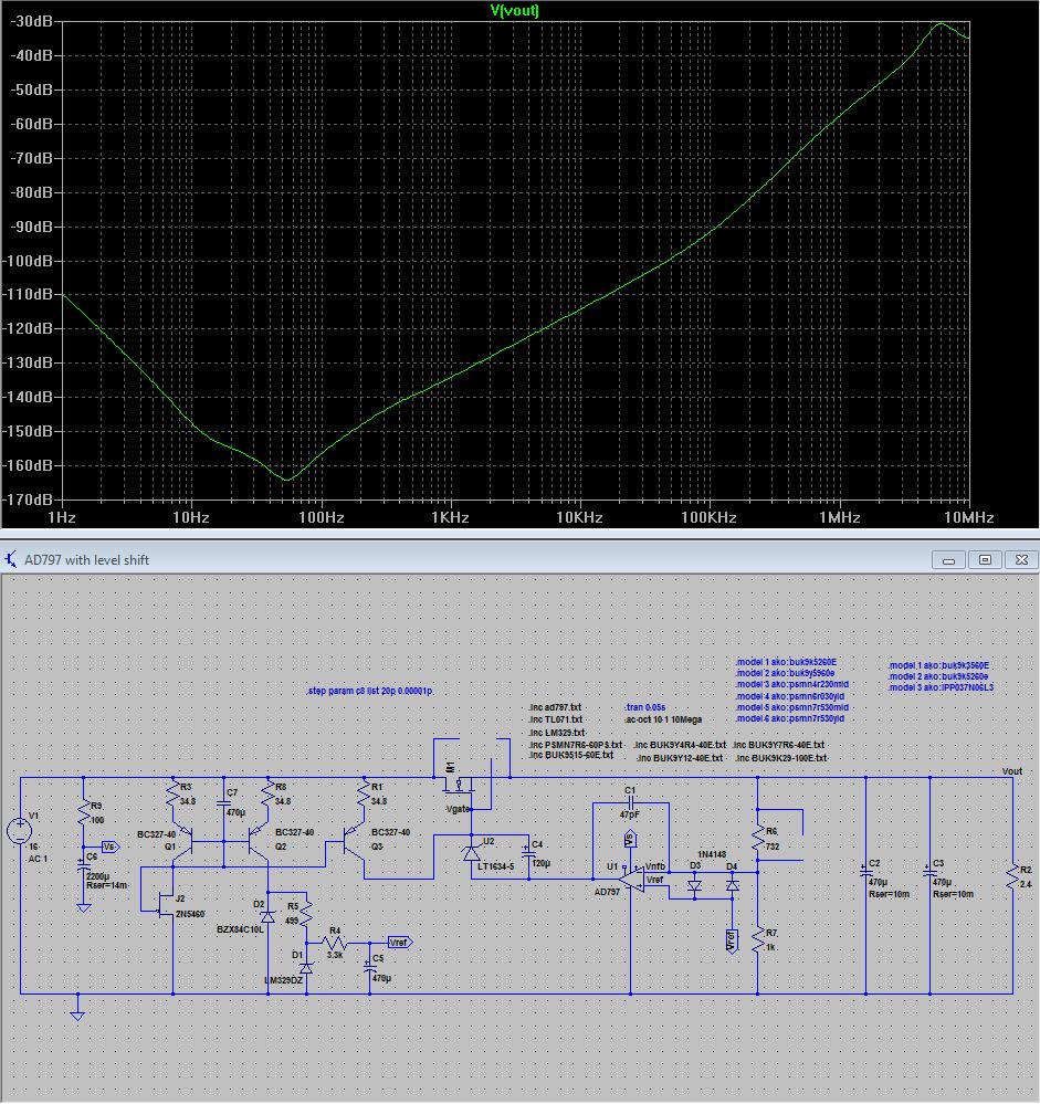

BTW I laboriously went through every MOSFET in LTspice by International Rectifier. Of course it had to be the very last one, but this one shows some promise for applications with lower voltages (for a 12v reg, at start-up Vds is above 12V given the source is sitting at ground): IRLR3802PbF/IRLU3802PbF.
It has almost identical performance to the NXP BUK9K35-60E. It comes in either D-Pak I-Pak. Mouser UK only stocks the D-Pak.
Absolute max Vds is 12v and Vgs +/- 12v. I'm not sure how one would manage thermals with these packages.

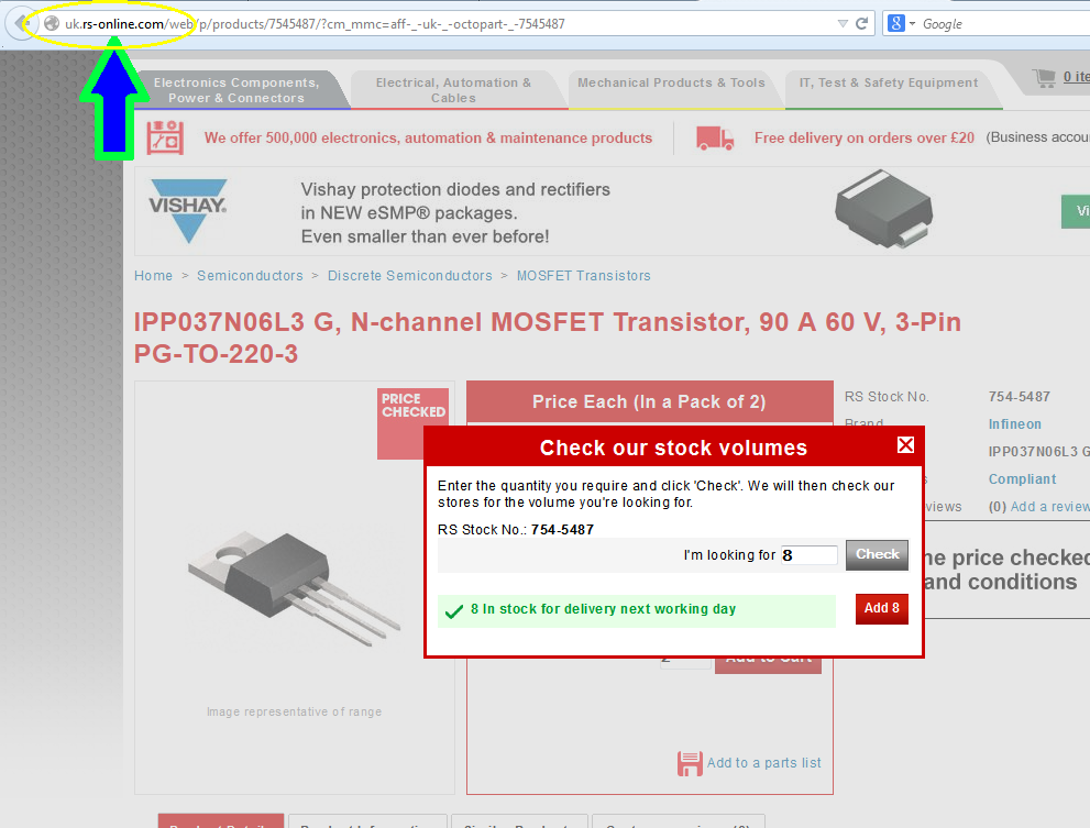

I took another look at the IPP037N06L3 G given its TO-220 package. The performance (attachment 1) is still very good with the updates to the rest of the circuit and even with the larger cap from the inverting pin to the output pin of the AD797; increasing the cap from 4.7pF to 47pF provides good phase margin and 11dB of gain margin (attachment 2). Of course, I should have checked availability more carefully; while Mouser UK shows a price, they have no stock (and Farnell UK no longer stocks it). Lovely.
EDIT: RS Online happens to have 22 in stock
An outfit calling itself uk.rs-online claims to have them in stock. Don't be fooled (as I was fooled!) by the banner ad for Vishay diodes at the top of the page; that's irrelevant click-bait. The MOSFET parts are from Infineon and the link is to the Infineon datasheet.
Yes, I decided to grab a half dozen plus a few LM4040 in 5v, 2.5v and 2v to bump the order up so as to not incur £5 postage. Better to have some of the voltage references "for free". At least that's a key variable bedded down.
I need to re-read the section on bypassing the AD797... and model out the 5v and 3.3v regs.

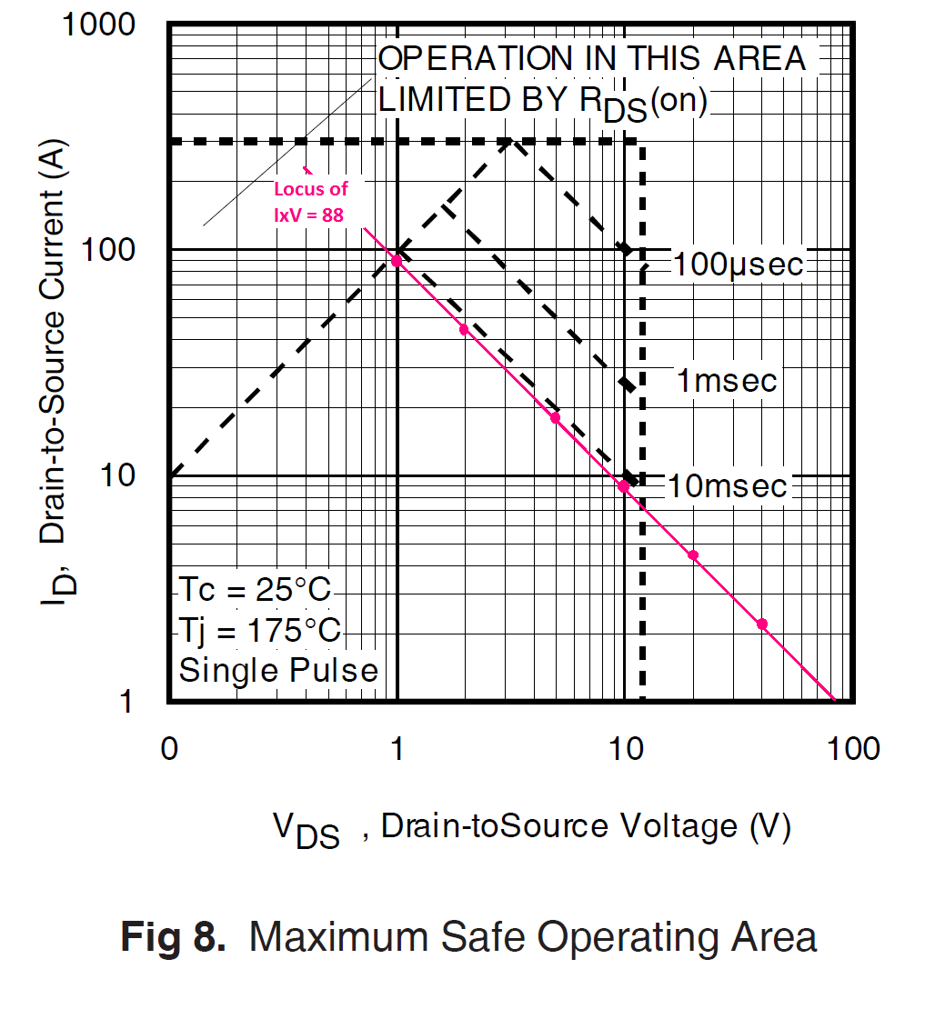

the datasheet seems to give odd values.BTW I laboriously went through every MOSFET in LTspice by International Rectifier. Of course it had to be the very last one, but this one shows some promise for applications with lower voltages (for a 12v reg, at start-up Vds is above 12V given the source is sitting at ground): IRLR3802PbF/IRLU3802PbF.
The data table shows Pmax as 88W for Tc=25°C
but the plot of SOA also at Tc= 25°C shows nearly the same 88W (10Vds @ 9.5A) as a 10ms one shot limit, instead of a continuous 10Vds @ 8.8Adc

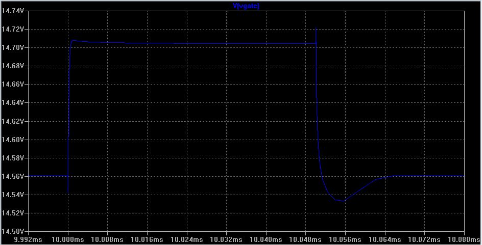

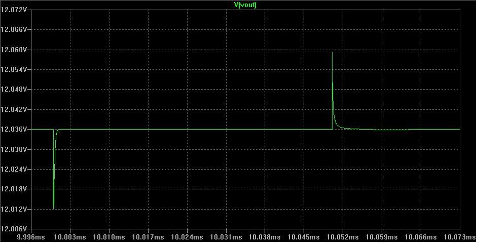

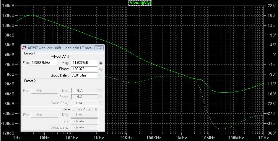

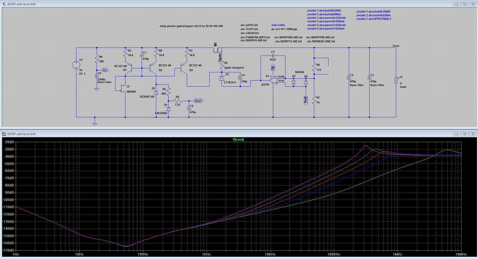

When I look at modelled waveform of Vgate and Vout while stepping the load from 0.1A to 4.9A and back again I see no evidence of under-damped oscillation with the IPP037N06L3 Mosfet (in contrast to that which was observed earlier, see post 48). This suggests to me that any natural resonance is already damped by driver circuit. See attachments.
Am I missing something?
PS: any gate resistor impairs PSRR from about 2kHz and up
Yes you have made at least two mistakes. One of them is to omit the resonating inductors from your simulations and then conclude when you don't see resonance, all is well. Another mistake is to assume that the red resistor "R3" below is a base stopper resistor, and to further assume that replacing NPN Q1 with an Nchannel MOSFET, turns R3 into a gate stopper resistor. A third mistake is to overconfidently conclude that when your simulations do not agree with both Nelson Pass and John Curl, the error must be Nelson Pass's and John Curl's.
Why don't you read Bob Cordell's book p.194 & 206 (base stopper resistors), and also p.215 (gate stopper resistors). Then look at post 81 in this very thread; the 330 ohm resistor is a gate stopper. Then look at Fig 11.17 on page 242 of Cordell's book; that's Bob Cordell's MOSFET power amp. Study resistor R40 (100 ohms) at top right; that's a gate stopper resistor.
Agreed, assuming the models don't model these effects.

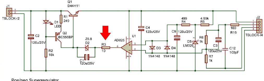

Here I merely meant that any resistance in series with the gate/op amp output was detrimental to PSRR. When I was trying to understand the purpose/impact of R3 I tried adding such a resistor to the Mosfet circuit. This was before the level shift was present and so R3 was directly connected to the MOSFET gate. The impact to PSRR was readily observable. The question of a resistor at the output of the op amp came up again when looking at stability. The Linear Technology video I linked to some time ago includes a couple of tips for dealing with op amp stability, one of which is placing a resistor at the output of the op amp to roll off gain. It also "fits" with the discussion in the paper I linked to that such resistance slows the charging and discharging of the gate capacitance and the speed of the Mosfet. I was therefore not at all surprised to see that adding, for example, a 20 Ohm resistor at the gate of the Mosfet damaged PSRR.
No, I had merely questioned what I was missing and, at best implicitly, whether their recommendations were for a different sort of application.

Note that before looking at the model, I did try to apply Balogh's formula to my situation. Unfortunately, while Ciss and Rgi are provided in the data sheet, Ls isn't that I could see. I would also have to estimate the impedance of the circuit driving the gate.
There is no measurable effect upon simulated circuit performance when Rgatestopper is 1E-5 ohms. There is tremendously bad circuit performance when Rgatestopper is 1E+5 ohms. But where is the midpoint? What is the largest Rgatestopper which still has no measurable (in simulation, using somebody else's MOSFET models, whose inductances you don't know) effect upon circuit performance? Call it Rx. Why on earth wouldn't you include a gatestopper of value Rx in your simulation and more importantly on your PCB? This makes it possible to swap in any value of Rgatestopper you like (including zero ohms, or Rnelsonpass ohms, or Rjohncurl ohms) on your real board in real life, if you see too much resonance or too little resonance when you measure the real thing with a real load.
Make sure to connect Rgatestopper correctly in simulation; don't screw this up. Make sure there is absolutely no circuit path from the MOSFET gate to any other component, except through the series Rgatestopper.
You could ask your assistant to devise a set of simulation experiments, which will extract the values of gate inductance, drain inductance, and source inductance of a given MOSFET subcircuit or model. This has the advantage that you don't have to trust the documentation of the simulator or the documentation of the model. You simply run your own tests and trust your own results. If your MOSFET's simulated behavior is indistinguishable from Lgate = 8 nanohenrys, then Lgate IS 8 nanohenrys. If it walks like a duck and quacks like a duck, it's a duck. When completed you will know whether or not your particular MOSFET model includes inductances; and if it does, you will know their values. Comforting.

If we take for granted for a moment that one is necessary, how does one determine how large a resistance to add? How to apply Balogh's formula? Attached is the impact of adding a gate stopper stepped through 0, 20, 50 100 and 200 Ohms.
Someone else can answer that question; "Balogh's formula" from SGK's link in post#112, is shown below.
_
Ok granted re first point although I have a reluctance to have to jumper over pads which I suspect I have to get over.
Infineon use 2n for Ls in their IPP037N06L3 model (Ld=2.5n, Lg=4n). Ciss from the datasheet is 10,000pF. Rgi = 1.3 Ohm
Rgate,opt = 2 x SQRT(Ls/Ciss)-(Rdrv+Rgi) = 2 x SQRT(0.2) - Unknown - 1.3 = less than zero
