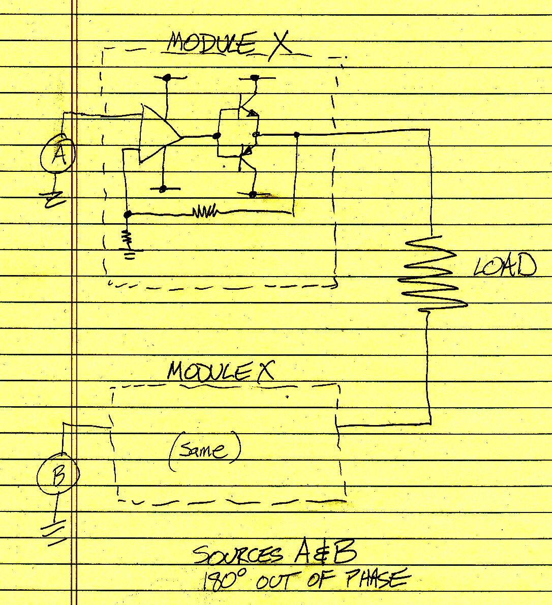

If I am reading your post740 sch correctly it is a series style regulator.
The average current becomes the load that the transformer must satisfy.
add up all the average current demands of the various modules/chips. That becomes the current demand of one rail regulator.
When no Zero Volts/Power Ground current flows all that current passes to the other supply rail.
Thus both supply regulators pass the average demand at the same time.
That then is where you can check the demand on the transformer.
It all changes when there is output current. Some, or all, or in some topologies none of the output current returns via the zero volts line.
Now the two supply regulators do not supply current at the same time.
Fortunately these current to output periods are short as in half cycles and generally of low amps values. The high amps demands tend to be transients and of very short durations.
These do not cause significant heating of the transformer. But they are very significant demands of the decoupling and smoothing capacitors.

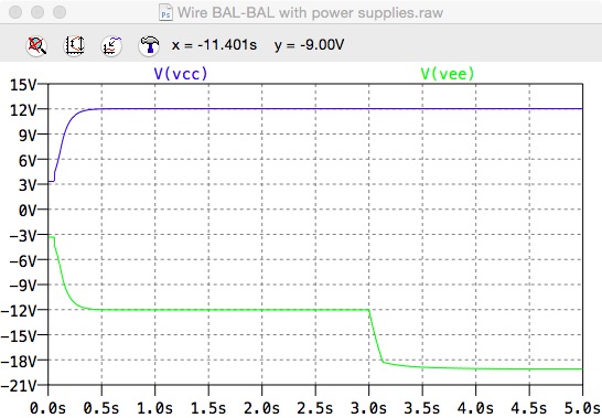

Here's a completed version of the Wire BAL-BAL spice modelling. After some schoolboy errors forgetting I had +/- supplies and hence the voltage across the load is twice the amplitude the input signal and some help from the LTspice Yahoo Group I got there. Interestingly the model suggests the amp will oscillate without some compensation around the op amps which Owen has not provided for on the board. Perhaps it isn't necessary in real life.
The only peculiarity remaining in the modelling exercise is that while current flows to/from Vcc and Vee for each individual devices seem to match, when I look the aggregate at the voltage sources there's a very slight mismatch. I'm not going to get too bothered by this however.
I still need to sit back and reflect on this a bit more. I now see that with a balanced/bridged typology how each reg is asked to provide current for both halves of the cycle. Multiply by two for two channels. I still find it a bit confusing when I look at the Vee profile for one of the output buffer ICs and think about it sinking the quiescent and sourcing current on negative halves of the cycle.

You can pretend to be the EE professor and ask yourself a series of sanity-check questions
One might expect that the amplifier's "efficiency" is greater than 0% and less than 100%. How much power is drawn from the DC supplies when delivering a full amplitude 1kHz sinewave to the load? How much power is dissipated in the load? What is the ratio of these two powers?
One might expect power-in (from the AC mains) equals power-out (to the load) plus power-wasted (heating up the rectifiers, capacitor ESRs, amplifier transistors). What are these three numbers?
One might expect that since a bridge rectifier contains 4 diodes but a sinewave only has two segments (top_half & bottom_half), there may be times when some diodes are working {dissipating power} and other diodes are resting {dissipating no power}. For each of the four diodes in the bridge, plot instantaneous_power vs time, and calculate the long term average power dissipated in that diode, averaged over 100 milliseconds. Notice that 100ms = 5.0000 cycles of 50Hz and 6.0000 cycles of 60Hz, so it's a good averaging interval for both European mains and for USA mains

Can I check the correct wiring to operate two of these reg boards as dual supplies +/- 12V?
I was planning to configure two boards for 12V operation and connect them as shown in the attached graphic below which I understand to be consistent with Fig 11 here in order to achieve +/- 12V. But maybe I am missing something....because when I try to simulate attaching this supply to my Wire BAL-BAL circuit the Vee voltage level breaks lower when the input signal to the amp turns on. See attached output plots of Vcc and Vee (from the reg boards in the sim). This is with a 3V peak sinusoidal signal input to the amp with a 3 second delay. Doesn't make sense to me.
Also, should all three wires be twisted together as best as possible?
(I've attached the sim but be warned it takes FOREVER to run. Unfortunately I do not understand why. Reducing some more of the time constants might help it run faster but I suspect the issue is more complex. It runs slow as soon as I supply the amp from the reg circuits.
This issue with the supplies - assuming my configuration is correct - plus the instability exhibited in the model while it seems the actual circuit without any op amp compensation has performed well for many people is very much undermining my confidence in this model.)
