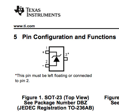

It seems the LM329 may have been the problem. See attached for measured voltages at various points in the circuit. With the LM329 in trouble, I don't see the oscillation previously witnessed on the output. Maybe the LM329 is the cause?
Before I replace the LM329 I want to double-check the pin configuration and its resistor value. R10 is 499 Ohms and my LTspice model suggests that this will mean 6.5mA through the LM329 which seems to be straight down the middle of its operating current. When looking at the board, I have the middle pin connecting R10 and R11 and the top pin going to ground.
Yes I agree that the circuit needs debugging before swapping opamps. Even when oscillating, that still should not cause the funny voltages you see. For instance, the pencilled-in voltages at the opamp inputs suggest that the opamp output should be slammed to the pos rail. Is it? Why not? If you open the opamp output, does it slam to the rail? So what is drawing it down?
The LM329 circuit also looks fishy. If you isolate the right side stuff from the 329, does it correctly go to around 6.9V? So what draws it down?

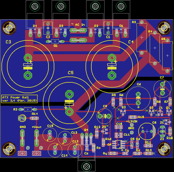

Is the board really conforming to the schematic?

Just a question: was the PCB layed-out manually or was there a DRC-link to the schematic?

Re your last question, the PCB was laid out in Cadsoft Eagle and passed DRC for the board provider's design rules. Of course DRC doesn't help when one screws up a part's pin configuration. (LM4040 pin configuration attached.) I have attached an image export of the board from Eagle. The Z3 LM4040 problem now seems to blink at me in neon.

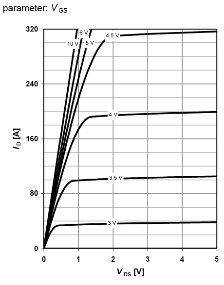

You know, I just realized that your MOSFET pass transistor does NOT contain any internal zener diodes to prevent VGS from exceeding the ±20 volt datasheet max. Nor does your board design.
So there's a teeny possibility that you may get +22V on the gate while there's +0V on the source, and Poof! goes the gate oxide. This may happen at start-up, and/or it may happen during wild oscillations. Or it may never happen at all, I don't know.

The easiest way to guarantee you won't blow up an NMOSFET pass transistor during debug, is to plug the primary side of your transformer into a Variac and use the Variac to sloooooowly dial up the primary voltage. When the post-rectifier raw DC voltage (across C5) equals 19 volts, stop. Voila, it's impossible to put 20V across your MOSFET when there's only 19 volts to work with.
It does seem that perhaps your opamp isn't doing its job. When VIN- exceeds VIN+ the opamp is supposed to slam its output pin down as low as possible. On the other hand if the Nchannel MOSFET is a big solid short from drain to gate and gate to source, then the 50mA opamp is fighting against the 100A MOSFET and I know who I'm betting on.
