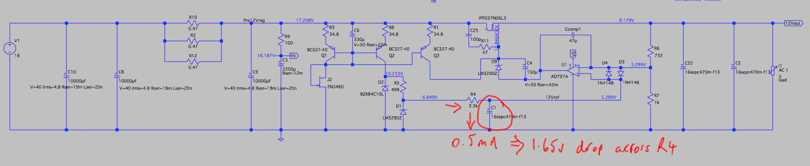

I have even swapped out the pass transistor for one with less transconductance (e.g. IRLI530N) and the problem remains.
Even the 5V and 3V3 regulators that don't have a good number of the parts of the 12V show the same issue. (The Vref of the 5V and 3V3 is powered from a 12V voltage source. In reality the idea is to power them from the output of the 12V reg.) I can strip the circuit back to absolute basics and it persists. Is the issue inherent to a FET source follower? How real is the problem? I'm stuck.

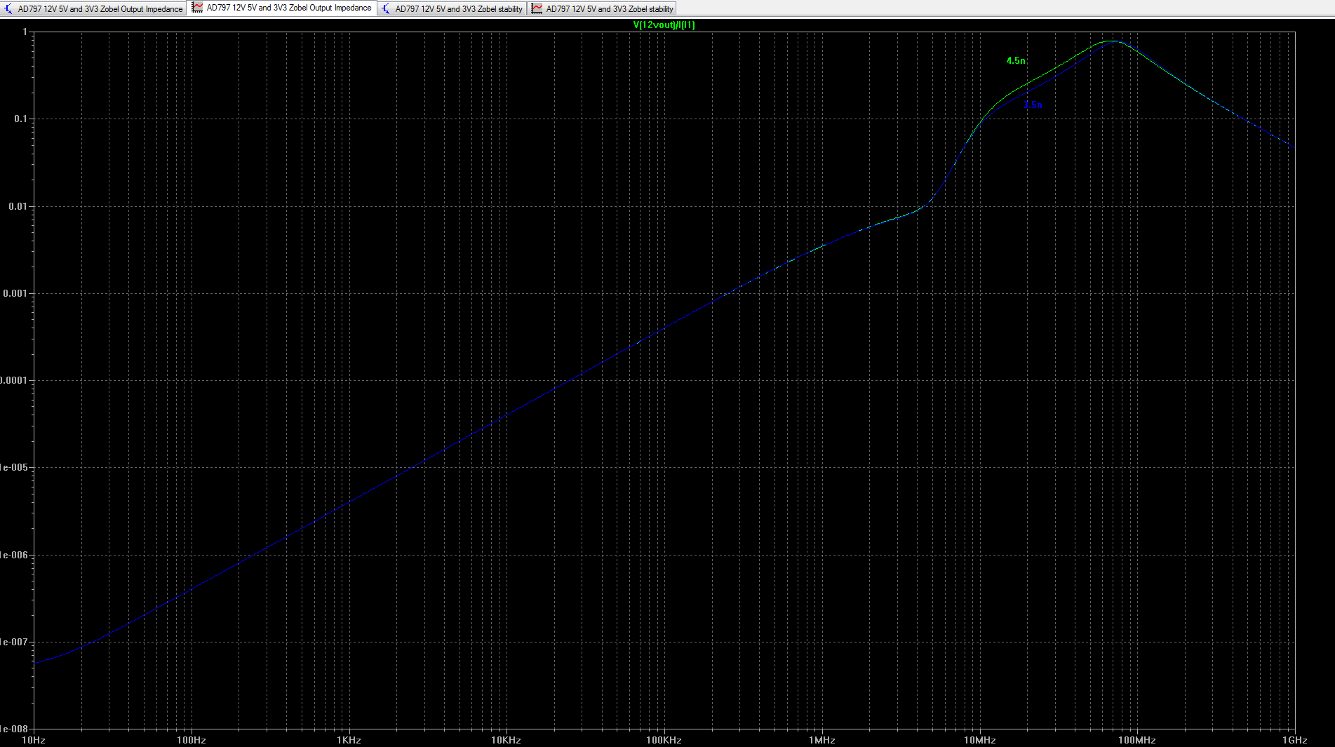

The plot attached to post #234 appears to show that the output impedance at 5MHz is 6 milliohms. If that is true then a 1-amp sinusoidal current at 5 MHz is expected to produce a 6 millivolt sinusoid on the output. V = I*R where R=0.006 and I = 1.
If the transient analysis agrees with the AC small signal analysis, and if both agree with human intuition, then I don't think panic is a justifiable response.

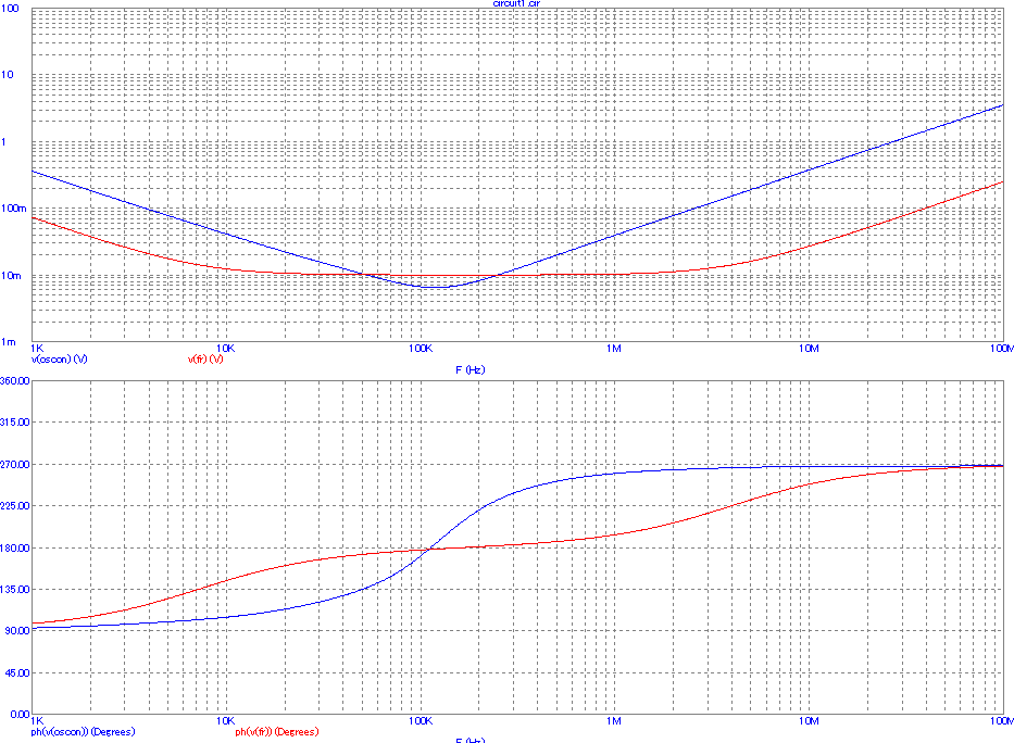

While searching for ESL info on the Panasonic Os-Con caps I was planning to use for output caps I looked at Panasonic's website and found that they have provided impedance charts and Spice files for the caps. However when I plug in the Spice file in lieu of a 'standard' capacitor with Value=470u and Rser=10m, output impedance of the model collapses - massively. I don't understand this. I was expecting impedance to rise due to the impact of series inductance (for all frequencies except c100kHz which is where total impedance falls to just ESR).
I just did a basic circuit (voltage source with small signal AC=1, a cap with the Panasonic subcircuit model, and current source) to check the impedance plot of the Panasonic .subckt cap and, of course, it looks very much like the plot provided by Panasonic which I believe was created from measured data also made available by Panasonic in the same download. So I now need to go back to the regulator circuit and try to understand why using the Panasonic model makes such a difference - firstly checking I haven't made a basic mistake implementing it.
(FYI impedance plot from Panasonic attached)

I just tested the model provided by panasonic and it looks fine. It gives approximately the same results as cap with 470u, 6.5 mOhm ESR, 6nH ESL.
Maybe your subckt connection is wrong ? check pin numbers etc.

Ok. I had used ESR of 10m as listed in datasheet and as you previously highlighted no ESL. But, yes, I need to check everything for silly mistakes before I post the .asc.
Isn't the impedance of those caps 10x more at 100kHz? (130 milliOhms)
EDIT: I misread your 10x. I don't think there's any way I can fit 10 x 6.3mm diameter caps on the board but let me look. I am at my max board dimensions and have already had to redo it to reduce the width (i.e. rotate everything 90 degrees so that the diodes protude to the top and pass transistor to the bottom. (BTW the right compairson is 2 x SEPC470M versus 10 x EEU-FR1C221 but I take on board your point re examining the impedance profile more carefully. I was also thinking about bypassing the output caps to ensure output impedance doesn't keep raising but, as Mark might say, it sounds like polishing a coprolite. I need to get the above sorted first.)
Re cost, I have some already (and in lots of 10 they cost 56p each) but cost isn't a necessary factor.

I ran the output impedance model with the Panasonic .subckt in place for the output caps here at the office on my Windows installation and I am not seeing the issue I had on my Mac at home on Sunday so very likely a fat finger mistake. (It was late and also I've noticed that on the Mac version if you don't exit a component's value cell after editing it then your changes aren't necessarily saved. Either way I will check when I get home tonight.)
I've attached the impedance version of the LTspice file (and necessary related files). I need to get a grip on all the caps. When I edited the Vref filter cap C1 from 470u/Rser=10m to the 16SEPC470M .subckt it whallopped Vref and consequently Vout...

I spent some time this afternoon looking at various output caps and their affect on output impedance and phase/gain margin. On the face of it, while bypassing the caps with 1uF would seem to help output impedance beyond 1MHz significantly, it screws up phase and gain margins.
I also compared the use 16SEPC470M caps versus 470u/ESR=41m/ESL=4.5n caps. Re the latter my eye is on the 'low impedance' EEU-FM1C471L: 3.5mm spacing and so I just took the low end of peufeu's guidance. There doesn't seem to be much between the two actually and certainly very little with respect to output impedance below 1MHz. Perhaps actual ESL is lower for the EEU although there's not that much difference in output impedance below 5Mhz when I vary the ESL assumption from 4.5n to 3.5n. (See attached with 5A load.) Interestingly, there also seemed to be little to be gained going from 2 caps to 3 except for some yardage beyond 5MHz.
Unless I am missing something else I'm inclined to use a pair of the 'low impedance' EEU-FMC1C471L on each rail.

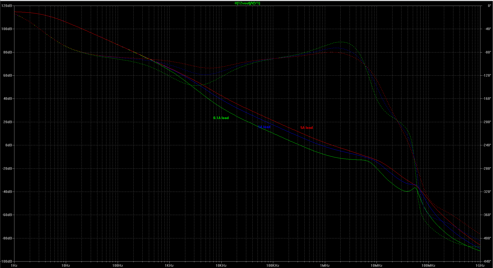

There's an issue which is bugging me from a conceptual point of view. As you can see from the loop gain and phase plot, as load increases the gain crossover frequency shifts to the right and overall feedback at any point increases. Yet when I look at PSRR it falls as load increases (albeit still at very good levels). Intuitively I would have expected PSRR to improve with the level of feedback (in the same way distortion does in a power amplifier). Apart from the peaking around 6MHz output impedance decreases with extra load. (It's not due to lack of Vin headroom as a result of increased drop across the filter resistors.)
I'm struggling to rationalisewhat I am seeing in this regard.
