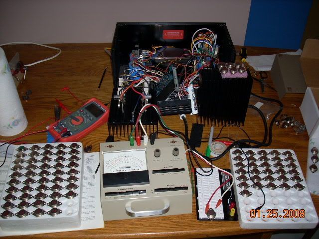

Adcom GFA-585 Blown 20w 4.7ohm on soft start board
OK
I hook up V+ directely to E, and C
I will use 1k res on B
and 10ohms on C
Can I use 5.17 volts, and still get accurate beta with IC / IB?
Are 1/4 watt resistors OK
A heat sink is no big deal. I plan on making a jig. You know how many I have to deal with.
IF 5v is too much how about 3v, or 1.5v
Thanks Ben

Hi Ben,
Transistor checkers often use a 1.5 VDC battery or two. 5V would be better and not cause excessive heat. I typically run my jigs at either 10 VDC or the actual working voltage. Heat sinks are required in that case.
Your base supply will normally supply less than 1 mA (normally tens of uA). Your injected current will be the applied voltage, less the E-B drop (call it 0.55 VDC), all divided by the resistance in series with the base. So you might want to add some resistance in series with the 1K. The 1K resistor exists so you can measure the voltage drop across it.
If you make a jig, a more complicated circuit can be made. What I have shown you can be put together with resistors and test clips. You may need to install a capacitor from the collector to base to prevent oscillation.
-Chris
Well I have just about given up on using a jig. I am not sure where I should be testing for the currant. I have fallowed the directions as best I could. I have searched the interenet for something step by step. I have not found one start to finish setup. All I know is when I figure it out I am probally going to slap myself because it is much easier than I am making it out to be.

Hi Ben,
That is also an excellent tester. I have one also. Your unit appears to be in great shape also! Check the battery and switch contacts as you would with any old electronics.
Normally, I would recommend people use the IT-18 as it's simpler and faster to use. The set up procedure is more involved with yours, but not vastly so. The IT-121 should give you accurate numbers.
Now, a beta of 5 is possible, but would not indicate a good audio output transistor. I might see that number on old horizontal output transistors, but not on your parts. Can you check to see if you missed a multiplier? Your beta might actually be 50, on the low side of what I normally see with your transistors. I would expect figures in the range of 60 ~ 90 for the bulk of those. You will see some "fliers" outside this range.
If you have the manual, read it through a couple times. Especially the "operating" section. If you are at all like me, I can't read well off a computer screen. Therefore, I print most of my manuals off. The operation and use sections at the very least. This might be a good idea for you. Keep the instructions with the tester.
-Chris

Hi Ben,
Yes, you will find that your figures will agree reasonably closely with those obtained using a jig at higher C-E voltages and currents. Matches made with this tester will also correlate well from my experience. Beta match is most important at low currents anyway as emitter resistors will force current sharing at higher currents.
Life is beautiful. Your figures are in the range I would have expected to see.
-Chris
I cranked the tester up to 1amp, and there was a little difference I have been able to separate a little better. It is like these things were ordered matched. I have tested some other transistors I have around, and after going through about 150 so far I can't believe how close these are. At 1 amp the beta is reading 80-81 on 90% of these transistors. Just curiosity how close does beta have to be? Would 78 play nicely with 81? I am not worried about this project, just thinking about testing other amps outputs.

Hi Ben,
I might say yes to a 5R1 or a 5R6. Possibly 4R3 would be okay too. I think 8R2 would probably burn out soon. 4R7 is a standard value, so I suggest you order the correct part. 8R2 might work for temporary testing, but I can't say how long it might last as it will dissipate more heat than the original value.
