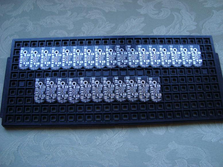

Next up: set of regulator modules. Please review and finalise your selection for this GB:
Preview AKR75 3.3V 3-Term regulator.
Priced at USD 35 but those who are getting the ADC module will get discounted offer at USD 25 for use with AKA102B only and can be shipped together (fully assembled and tested). You will need one for each AVCC section but has sufficient drive if you wish to use only one AKR75 and share power with both the L/R channels. Also suitable for the oscillator section. Optimized and efficient design. Thermal paths on ground plane itself - No bulky heatsinks required for use with AKA102B or other low power loads
Also suitable for your other projects.
Separate GB now open here:
AKR75 GB

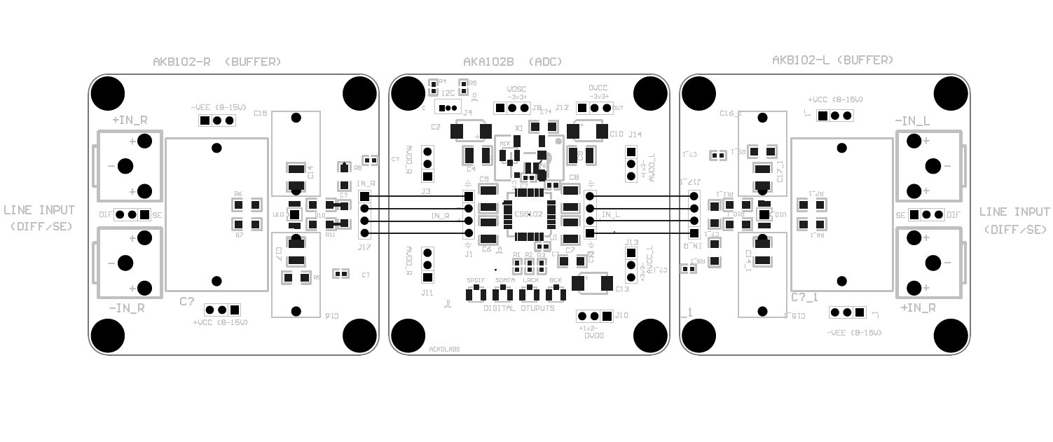

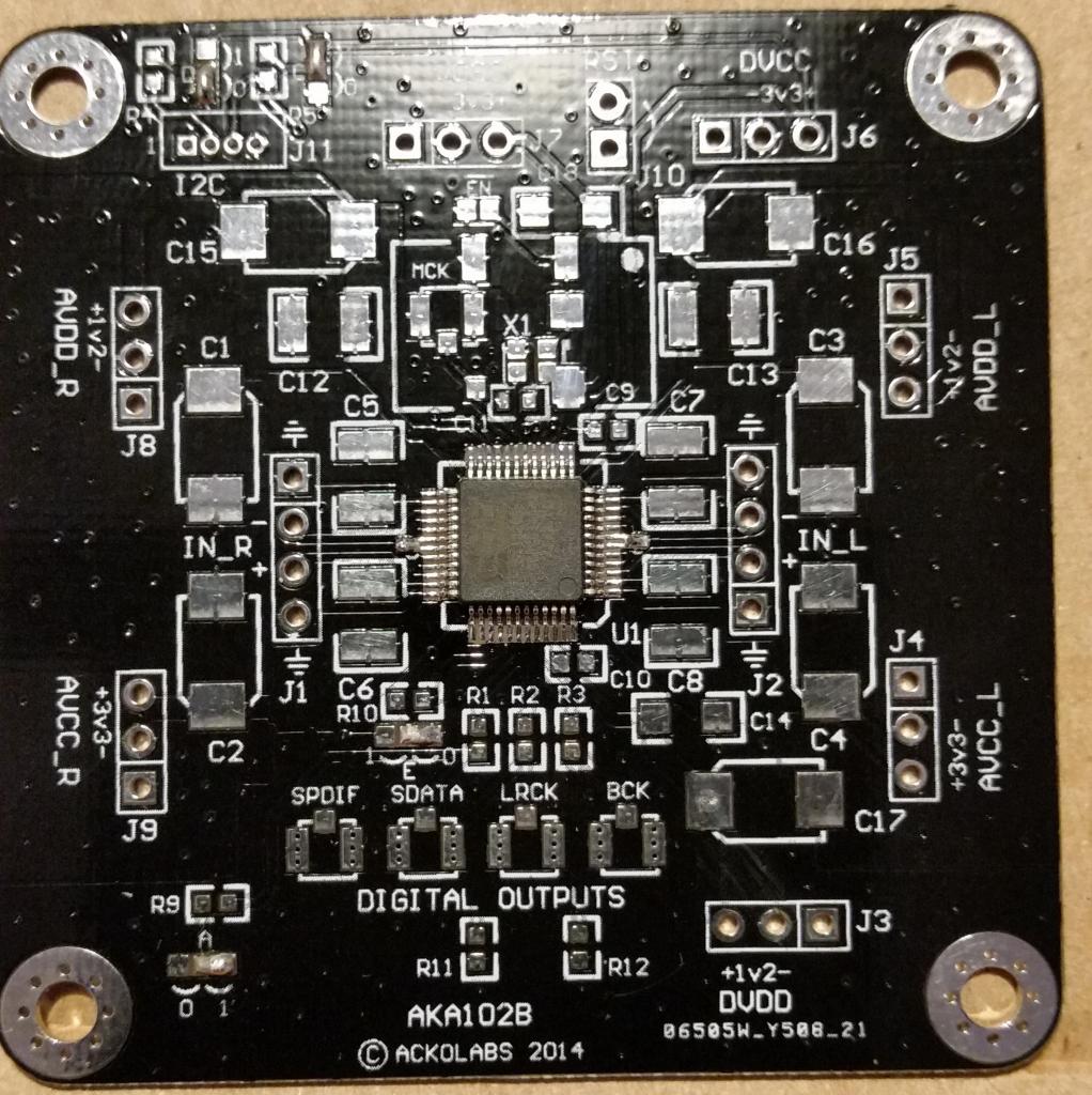

Hello Acko and everyone,
What a nice looking project ! May I ask a couple questions ?
Judging from the board picture, it looks that the differential inputs goes straight into the ADC, with just a (filtering ?) capacitor in between.
I don't have a big experience in this matter but I have studied quite seriously the datasheet of an other manufacturer ADC, ARDA Tech not to name it, and there a buffer at the input, referenced to the 'BUFREF" output of the ADC so the incoming signal never goes over 23dBu.
In regard of the NDA you signed with ESS (I asked them for the datasheet but got no answer...yet), can you tell us if the ES9102 require a buffered, referenced input or am I missing something ?
Second question if you may : the converter can be referenced to an on-board crystal oscillator (there is a footprint for a Crystek one for instance). It also posses an MCK input, to solder what looks like a µFl connector.
Is this the input for a Wordclock signal that replace the on-board oscillator ?
It's been some time that I keep an eye on the ES9102 (that was canceled for a moment). I believe most people of the diyaudio forum will use it for digitizing their analog sources, be it a vinyl or a tape machine. I'm a sound engineer so I'm interested by the pro audio application of the chip. I definitely want to give a try to your board !
Thanks in advance,
Stéphane.
BUFFER is required and will be available as a separate module (PN:AKB102)-TBA see pic:
Factory supplied with on-board oscillator (NDK type) but options to mount other types or connect external one via the UFL connector (goes to MCK directly, not WordClock)
