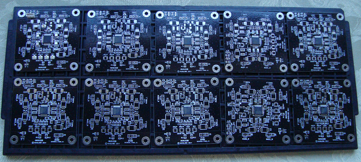

Cool, it'll just fit nice in an appropriate enclosure beside the other ESSs.
PS: Look at the S/R and in case the picture zooming does blur ...

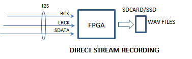

I would also like to see something that is more direct than going through a USB layer ...>
do you think a STM32F429 will do the job ?
MCU based upon Cortex M4 32 bits @ max. 180 MHz clock, just in case you didn't know ....
Learning kit for low price, I bet there is I2S avail
