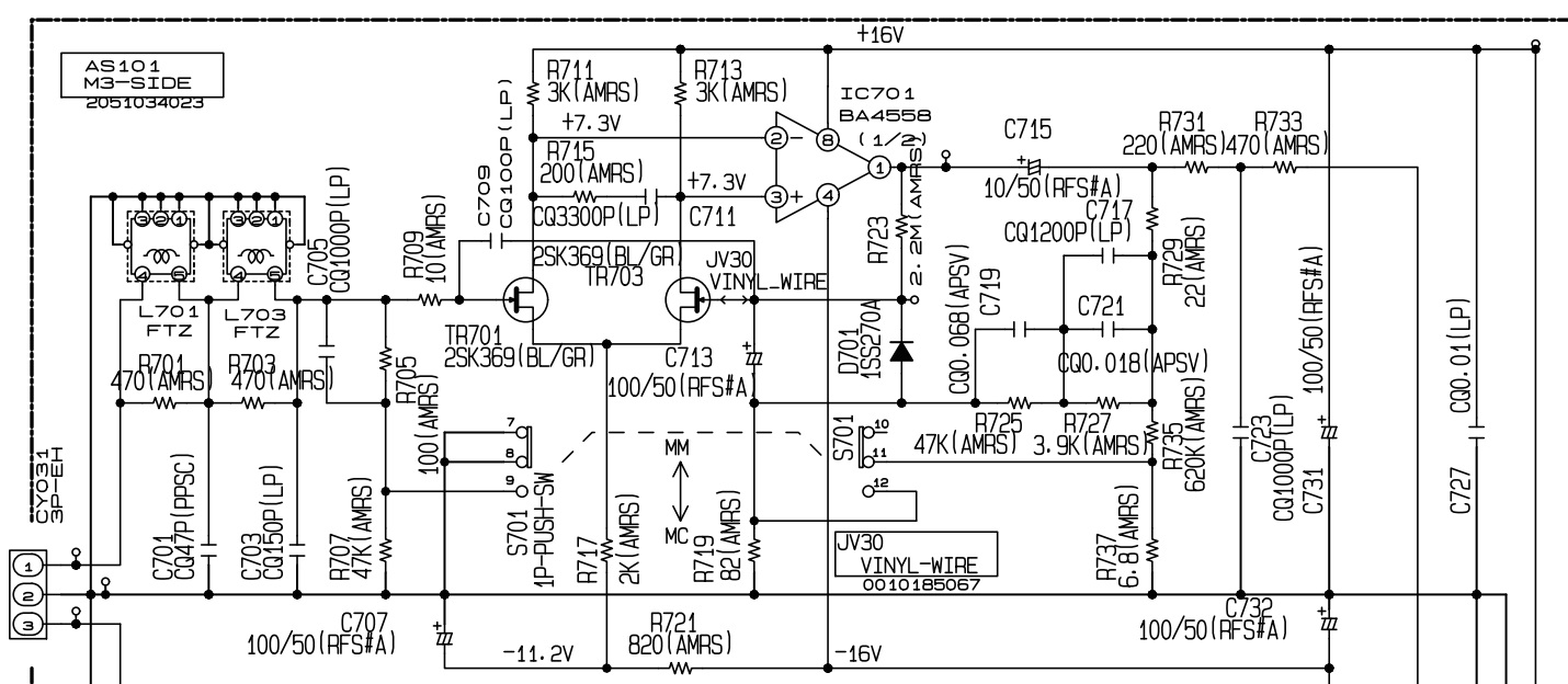

Yes, an interesting design combining both FET and BP; the OP275 Butler opamp IS also inexpensive ($1.40, 2x DIP or SOIC). But its noise, distortion, and CMRR specs are not in the class of an OPA1641/1642.Here is the Butler input stage for opamps

Baffled by people who swap op amps!! Usually the circuit around them has been designed specifically for them. My advice, don't mess about with them unless you are sure all the components used to implement them are compatible with your new selection.
Op amps don't have a "sound" they have a specification which any designer will tell you....!!

The vast majority of opamp circuits are really generic and apart from stability and bypassing concerns opamps are easily swappable. Why would people, and here i mean "listeners", not try do adjust the sound to their own liking if it takes so little effort? And yes, the little critters most definitely have their own sound, even the same opamps made at different facilities do.
