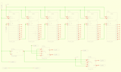

AD1865 the best DAC
Layout IV

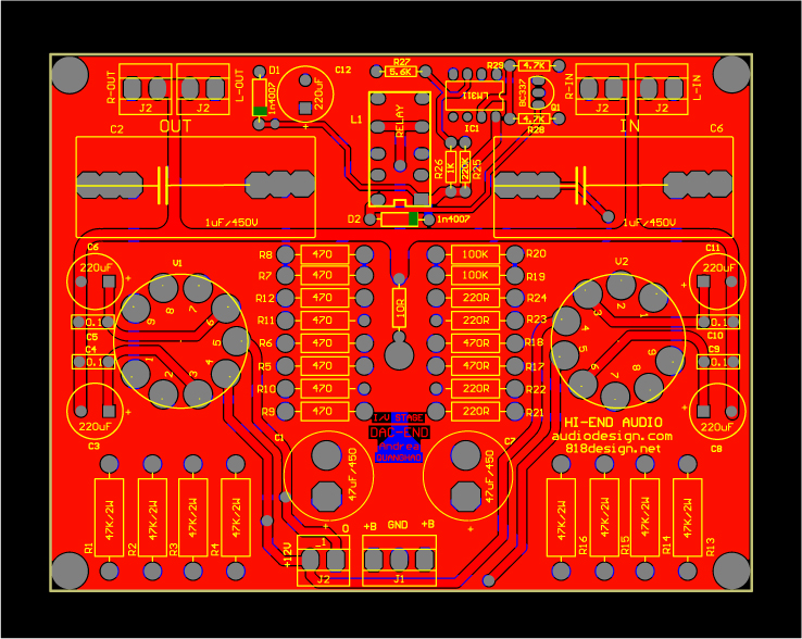

New I/V srage for DAC-end No use tranformer

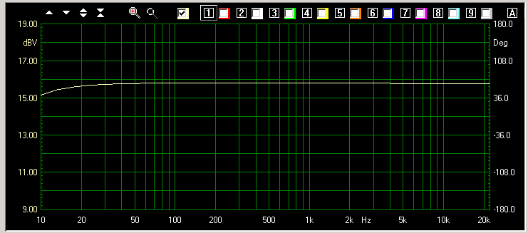

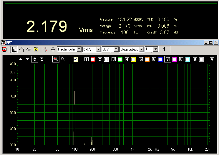

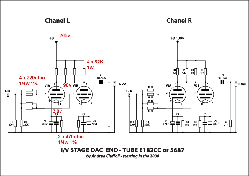

audiodesign wrote:** To get the best performances I have developed a new output stage for this DAC.
It use a pair of 5687 or E182CC to produce a low distortion stage with an output impedance near to 1Kohm so able to drive any amplifier. **
Vout = 2Vrms
Vin = 154mVrms
THD = 0.2%

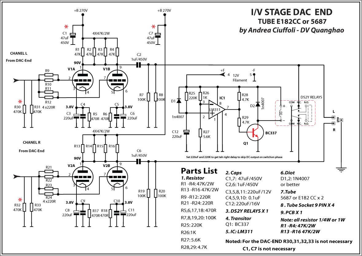

I/V stage cricuit for DAC-END
The cricuit I/V stage. In this cricuit you can use the sample one Pre, Zoou under 1K.
Andrea Ciuffoli say that :
*** Here the final output stage
THD measurement with and without 10Kohm load.
Output impedance less than 1Kohm
Power supply voltage about 270V
Ik = 2 x 8mA
Freq = 10Hz at -0.7db
Vout = 2Vrms with an input of 154mVrms
THD = 0.3% thd max on 10Kohm load ***
And
**To prevent dc voltage on output durung switch-on and switch off phase a relay will short the output to the ground for some seconds.
The delay circuit is the same used in the my design of Monrio Top-Loader CD Player (value 10000$). **
