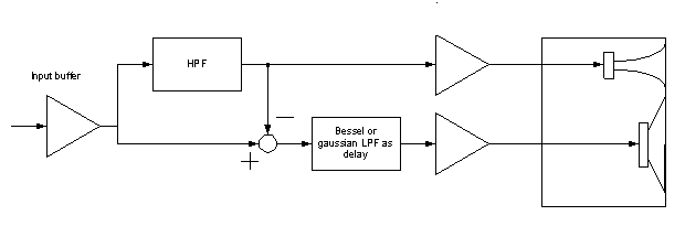

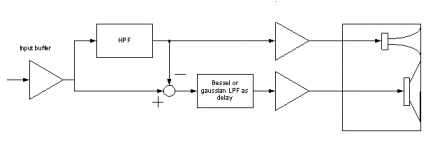

Hi all
A little late but maybe still better than never (O.K. that’s not up to me to decide !) my thoughts on the filler driver concept:
The filler driver principle was developed by B&O in order to achieve flat phase and amplitude response (yes they indeed invented cool things too!!!). It is basically an extended two-way system.
It’s original implemetation was using a 2nd order two-way crossover with BOTH DRIVERS WIRED IN PHASE, both filters having the same cutoff frequency.
As already known, this would result in an amplitude response notch at the crossover frequency. The trick is to complement this summed response by the use of a narrow 2nd order bandpass followed by a midrange driver.
This driver is used at full level only over a narrow band but the fil-ter slopes are both of first order only.
The result of this is a system whose amplitude and phase response is flat (i.e. transient perfect or PHASE ACCURATE). The active version is shown on the first diagram.
The advantage of this idea is that it can be implemented passively and actively. There is quite a lot of info on John Kreskovky’s homepage about this. His crossover software also supports the calculation of filler-driver crossovers.
A book issued by Elektor (G. Schwamkrug, R. Roemer: Lautsprecher – Dichtung und Wahrheit, ISBN 3-921608-45-7, page 130) describes the possibility to add the filler driver signal from an active filler-driver crossover to either the woofer or the tweeter channel (shown on the 2nd diagram for the woofer variant). Now the crossover path with the filler driver channel added has been changed to a 1st order slope with a hump. The amplitude response of such a crossover looks in fact like that of the old-fashioned asymmetric subtractive crossover but with the additional advantage of needing more op-amps and capacitors and therefore generating more cashflow, noise and THD.
After some studying I came to the following conclusion: The subtractive crossover can be regarded as an analog computer, computing the complementary signal that is needed to be added to an either lowpass- or highpass- filtered version of the input signal, to reconstruct the original input signal.
So I assumed that it should be possible to generate the filler-driver signal by the use of such a subtractive process and came to the topology shown on the third diagram (=advanced filler driver ! O.K. this sounds a little like hype but I wanted to give it a name):
Again a filler driver crossover, but using only two 2nd order filters as frequency dependent networks. The output signal of the subtracting network will always complement the summed output signals of the highpass and the lowpass that the total sum of responses is flat in amplitude and phase, regardless of capacitor tolerances etc !
It even works for almost any overlap or underlap situation. The only thing that has to be accurate is the gain of the building blocks. This can be achieved with reasonable effort using 1% resistors and op-amps (sorry for using this word again !).
Since there exist no perfect things in the real world, I must also mention a disadvantage of this one over the classic filler driver topology: the driver-dependent frequency response deviations can be better (I deliberately didn’t say easier !) taken care of with three independent filter networks.
I like the idea of having good transient response, but I don’t like the idea of having three drivers and not getting from it what it’s main advantage over two-way systems is: improved IMD figures and/or greater SPL capability.
So I did some more thinking and came to the following conclusions:
The "advanced filler driver" crossover would best be used with a full-range driver that has to be supported at it’s lower and upper end (by moving the highpass cutoff frequency higher and moving the lowpass cutoff frequency lower). There will be two humps in the amplitude response of the derived output, it’s slopes will be of 1st order.
If only two ways are asked for then the circuit can be used as follows: Both cutoff frequencies are the same and the derived channel is split in two by the use of a 1st order lowpass and a 1st order highpass (which is by itself again a transient perfect crossover !) and their outputs summed to the respective branches of the crossover (see 4th diagram).
If all cutoff frequencies involved are the same and all stages have a gain of 1 then the output responses will look like the ones from the symmetrical subtractive crossover (i.e. cascaded subtractive crossover).
But with the possibility to play with the 1st order crossover frequency we can change the distribution of the humps (maybe give a little more of it to the woofer and a little less to the tweeter).
If one goes a step further and plays a little more with ALL the cutoff frequencies and gain of the stages (AFTER the subtracting stage !) involved, he might even be able to take the driver’s responses into consideration when trying to achieve a flat total response.
As with the cascaded subtractive crossovers it is possible to implement crossovers of greater than 2nd order, having flat amplitude and phase response, using this topology. But they would also have the same disadvantages: Large humps (approx 6 dB for 4th order!) and wide overlap area.

Subtractive x-over for horn/direct radiator hybrid
Here I have something that crossed my mind.
It is primarly intended for the use with direct radiator woofers and horn tweeters.
As with all subtractive crossovers it can be made transient perfect but it would have a wider overlap area than an LR4 for instance. Also the vertical polar response will most probably be worse than what an LR4 could offer. But as we all know: The perfect loudspeaker hasn't been built yet (and most probably never will !! ).
The usual way to delay the woofer against the tweeter (because of the inherent mechanical offset) is the use of allpass filters.
One disadvantage of a subtractive crossover with derived lowpass is the low order of the latter.
By using a Bessel lowpass as delay network this one can be cured to some extent.
I am of course aware that the actual acoustic center of a driver (specially the woofer in our case) is frequency dependant but you can't always get what you want.
There are other solutions that would give a more uniform frequency response and better vertical polar pattern but they will most probably not be transient perfect and they are also more complicated (see John Meyer's patent).
I have not tried it yet but I most probably will, because I have two pairs of speakers of this type, running with crappy passive crossovers, that are awaiting activation. But this will take some time since I am still experimenting with my MSWs. But I didn't want to keep this one secret because someone else might feel the urge to try it out
Regards
Charles
Regards
Charles

Re: Subtractive x-over for horn/direct radiator hybrid
There is an AES paper on this exact topic, and i believe the Spica TC50 used a similar approach (passive thou)
dave
phase_accurate said:Here I have something that crossed my mind.
dave
