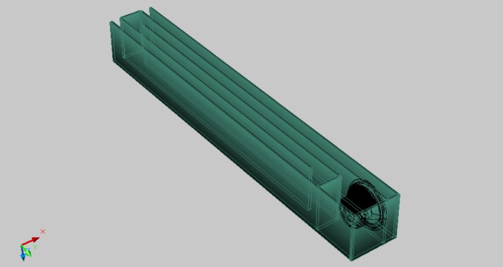

To augment the BASS, here is a design of mine you might want to consider...
Take your 8" sub driver out of that little box and put it in this.
It is a Cannon Tower with a small footprint (approx 8 1/2" x 11").
It is 56" high -- tuned to 24 hz (XOVER at 80 hz).
The long line (~141") is comprised of three folded lines (8" x 2.3" x 47" interior).
The short line is 8" x 2.3" x 47" interior.
It is small because the cross sectional area of each line is 1/2 the SD of the driver (as you know).
I propose using 3/8" void-free ply (since the lines are so small).

I'm gonna build a proper subwfr cannon(2-tubed) of ATCR=1 & get back to you. It's quite hot here in the UAE at present, so I may have to wait for a couple of months the least, since the wife won't allow carpentry inside the drawing room.
Hi Francis
I saw your sketch, and wish you luck with it!
Without the driver's T/S specs, it seems like a reasonable way to go...

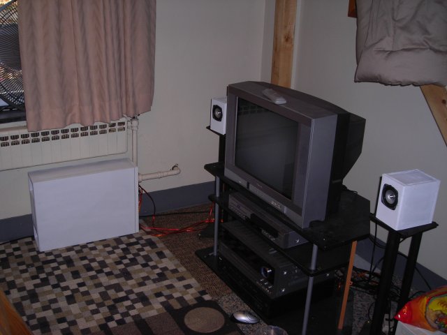

Ok, I built a folded Wave Cannon. It functions as a bass module for a pair of small satellite speakers. It doesn't sound bad, though it tends to favor the upper part of its range. It is crossed over to the W3-593S satellite speakers at 190 Hz, first order. The crossover slope is not nearly steep enough, but stuffing the upper tube (the short one) and the last bend in the lower line helped reduce the midrange infiltration to an acceptable level, and goosing the bass control on the receiver also helps some. This design doesn't sound "slow", but it does sound resonant. The internal folding is like a miniature version of qi's wave cannons. The driver is a cheap stamped-frame 4" dual voice coil woofer with a resonant frequency of 107 Hz. ATCR is approximately 1, but the stuffing helped with that as well. This entire set will be going to my sister, who is in a dorm room. These photos were taken in my own dorm room while I'm auditioning them and tweaking them (the stuffing, etc.)
The W3-594S drivers are like a pincushion-frame version of the W3-871S, originally made for Nuera. I sourced mine from Parts Express, which bought out the last remaining stock of Nuera Acoustics and picked up the product lines. They sound good. The satellite speakers are sealed, and stuffed absolutely full.
As you can see from the photos, I pretty much rushed through the finishing stage, with plenty of surface imperfections visible. I think I'll be sanding these down again and giving them several coats of paint before my sister receives them. I chose the Wave Cannon bass module design simply to evaluate the concept; I don't think I'll be building any more of these any time soon.
