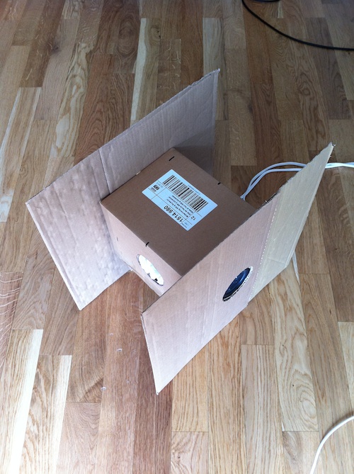

I was quickly looking into the acoustic lense idea. Here's the 8" fullrange speaker "naked" and playing through a 5 cm thick Basotect board mounted directly in front of the driver with a 5 cm hole in it (0°-30°, 2nd set of curves offset by 20 dB):
Quite encouraging!
Quite encouraging!

Updated measurements now including vertical polar response:
Demokrit Measurements
Thanks Oliver but are those measurements gated in any way?
